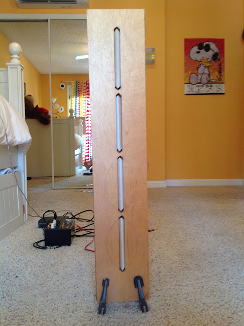

So far, no one (to my knowledge) has made a column similar to the SBH-10 using coax drivers and various height Paralines.Thanks for the comments ,I have some reading to do don't I!
Has anyone built anything like these,Like a diy layout? Pictures?Drawings.

There are plenty of drawings of how to lay out Paralines, making a cabinet similar to the SBH-10 would not be any more difficult than making the Paraline PA I built.
That said, it would be a hell of a lot more work and expense than I'd want to put in to a relatively low output 160 x 10 degree column speaker 🙂.

This is close, but doesn't use coaxes:
http://www.diyaudio.com/forums/multi-way/217298-square-pegs-33.html#post3191259

1) Not Patrick, but I have done a lot of Paraline measurements.1)Patrick, do you get the impression that a Paraline produces something strongly resembling a cylindrical wavefront?
2) Does SPL drop off smoothly as one listens off-axis toward the top or bottom of the slot (allowing of course for some diffraction effects due to the slot needing to terminate in some manner) or is there the more usual interference and comb filtering that messes up the high end first?
3)Does the wavefront emitting from a Paraline "want" to travel straight like a laser beam, from a perspective of vertical directivity? Or is it more like an infinite number of point sources that spray in all directions, with the vertical directivity arising from self-interference and lobing?
The wavefront at high frequencies resembles a portion of a cylinder.
2) A non divergent (equal path length from driver to exit center, top and bottom) Paraline has virtually no vertical beamwidth at VHF.
The actual vertical dispersion for a single 20 centimeter tall Paraline would be roughly 5 degrees at 16 kHz going to near 180 degrees below 1000 Hz.
3) The vertical directivity is a result of the Paraline equal path length resulting in a planar wavefront which diffracts horizontally, the horizontal dispersion controlled by the waveguide angle.

For the Synergy horns I'm building now I'm not using Paralines because I think that the Paraline is only useful in certain 'edge' cases.
