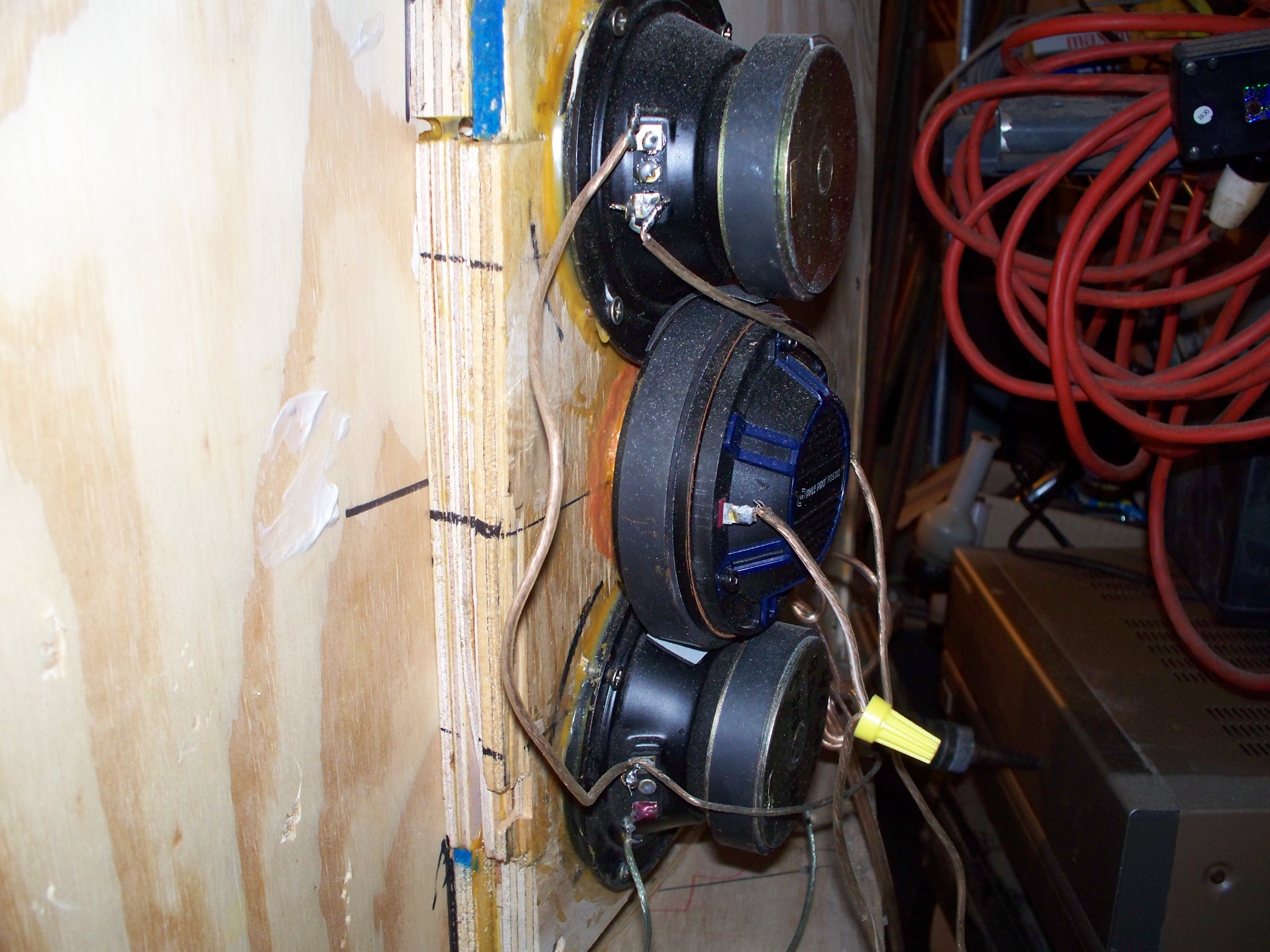

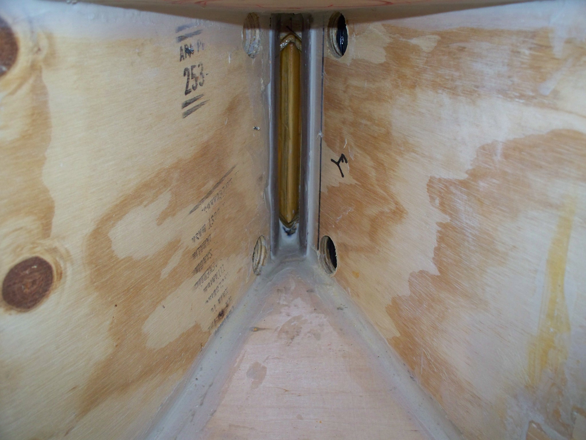

Hi Guys,
A interesting thread for sure,I have built 2 speakers of this design Thanks for all your posts,I couldn't do this without you guys! They work very well,most people remark at how clear they are,I am using a Deq and a dcx 2496 so I can tune electrically almost anywhere,but I was wondering if I can improve this setup by designing the correct size cutouts inside to work as a passband ,maybe work with minimum E correction,so is there a size paraline cutout I can make for this ,or a way to figure the upper and lower cutoffs,any suggestion are welcomed!

Hi Guys,

First off, great job! I'm not sure what you mean by the "cut outs". Can you go into more detail on your question?
Hi JLH,
You got some nice toys also and I have read alot of your posts ,especially on compression driver comparisions,very informative!
I ment by cutouts the actual size you make the width and lenght of the eye ,I have understood that the .25 " slot is used to pass freq. around 20 k and under so that is a constant.NOW the size you make the actual perimeter can change ie bigger or smaller,correct?So I'm thinking,(look out),lol.........
If you make the size of the eye 4" wide and the hieght acording to the string method will that the pass freq in the range of say mid range like (guessing) 8khz to 18khz or by the same token make it 12" long and would that give the lower freq with a upper say 3khz rolloff,I'm looking to design the lenth to fit the passing of signal like a cross over would normally do,but do it at the speaker/size of the paraline,OR door #3 Is this not going to work at all,lol.
What happens when you stack these like make 2 or 3 of them together?I know it increases path length,so timing changes ,correct?
I hope that's a little clearer ,lol. Thanks for some help!
