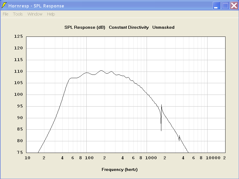

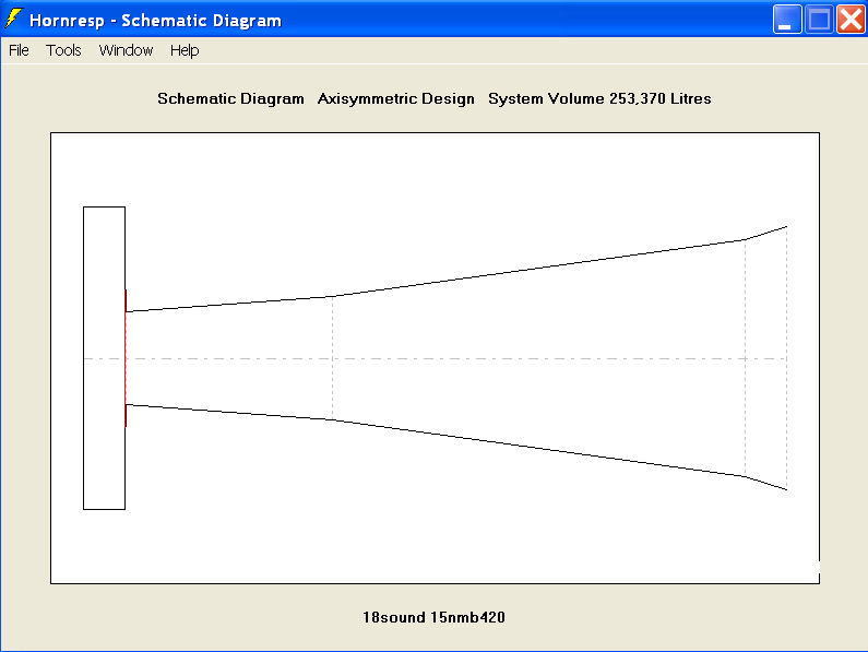

18sound Here the simulation conical horn. With bas-reflex loading I think 40Hz is possible..
1 PHI response
0,5 PHI = corner position.
To give a idea very good loading and there for nice flat response

The la scala is about 295litre.
My simulation is 254 litre it would become the same size as the la scala.
Personaly I would say forget the form of the la scala. and fold it something like this one. This drawing is a cube shape I would make it taler and like this one woofer cone facing the top of the box. And a BR opening in the closed volume.

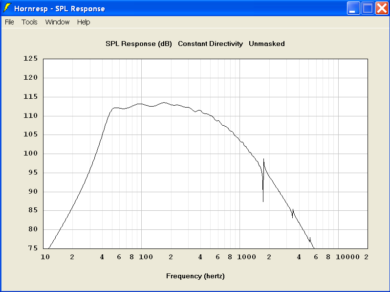

Simulation with the same driver and as the lascala with short 1meter horn. 1phi it will be better the reproduce up to 300Hz 60Hz not bad at all with this short horn.
