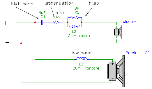

When I get around to building mine, I'm going to set up the crossover so I can easily remove the trap. Then I will let my calibration system work that out instead of doing it with the passive components. I'll need to be able to put in back in though since this speaker will be too fun to keep in one place for long. It'll be a while though. Have another speaker project in front of this one.
John, here is a cleaned up version of your image. Please feel free to use it. Hopefully I got the values correct. I can fix them if there is anything wrong with them.
Thanks Ryan!
Apprceciate you taking the time to create and post the Schematic.
I will be posting a Vifa reverse phase version soon. Only a couple part value changes.

I'm trying to build the Manzanita as inexpensively as possible. Recycled wood etc. I've read through the thread and I get most of the answers I need. But a few crossover questions or at least needing verification before I order parts. Using this crossover for the Manzanita from post 465 which I assume is the current version.
Question 1
Question 2
For the trap to function as designed, if the DCR of L2 varies from John's .3 ohm value does the value of R1 need to change? and if yes what value would I use if the DCR of L2 is 1 ohm.
Question 3
ERSE has a 20.0 mH 16 Gauge IXQ Coil with a DCR of .691 ohms. Any major issue using that for L1? The DCR is a bit higher than either of the coils listed in the BOMs.
Question 1
Using the above info and assuming the current design (John's personal pair) uses a Solen 14 ga. perfect lay which measures about .3 ohm, if the DCR of my L2 inductor is 1 ohm I would lower the resistance of R2 to somewhere in the 3.8 ohm range to compensate for the higher L2 resistance. Right?The 19 ga. Pano called out in his Bill of Materials (BOM) can work. It has the obvious advantages of lower cost and size. However, with it's higher resistance of about 0.9 ohms, an adjustment in the R2 pad resistor would be required to retain the tonal balance of the system as well as the desired Vifa crossover high pass slope. R2 would drop to around 3.5 to 4 ohms to compensate for the higher L2 resistance.
Question 2
Question 3
