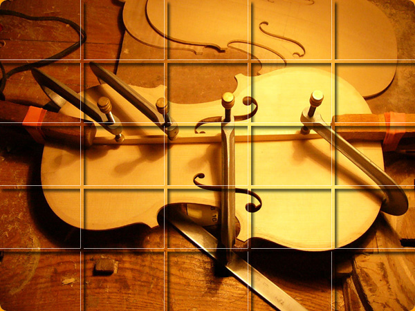

after funish by many layers of volin vanish!!!
this photo was a handmode & funish volin.
thx
thomas
thx
thomas
hi,
this photo was a half funishing volin. It means only paint some layer of the volin vanish. probably was inner coating already.
U can see the outlook still not strong shine. light colour!
all data for reference only.
thx
thomas
thx
thomas

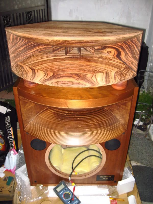

Thomas, turpentine is a plant extract. So is linseed oil. Shellac is a type of varnish. The key ingredient is a dose of P.T. Barnum.
hi Sy,
many thanks for your information. they write the contain material was in chinese. Let me try to search the name of them. I will post later. And mixing of them, I mean mixing different extract they sometimes put into water bath to control temperature & mix for them.
But I am not clear, so i directly bought fom them. They charge me not expensive. But post this alcoholic contain was flammeable. I cannot use pane post to me. If I test them really good. I will directly call factory coat for me.
I was testing for another experience.
I put original TAD TH-4001 horn Mouth ( maple Plywood) with 4001 driver one the top of the 2402 speaker & after that put the C37 similar coating horn mouth with 4001 driver on the top of 2402.
signal was directly from 2402 Crossover.
I had several air of 4001 horn driver so i can do this.
I will test them for one week with different type of music.
will post result later.
photo was my another original TH-4001 horn mouth + 4001 driver.
thx
thomas

hi SY,
if solid fine ebony + thin C37 similar coating was this sharp with TAD 4001 horn driver. This two pair will compare soon.
Hope the C37 coating will be same level of sound quality as the original 4001 horn moth!
Sy, U can see the C37 thin coating made the surface of the solid horn mouth was smooth & pretty.
