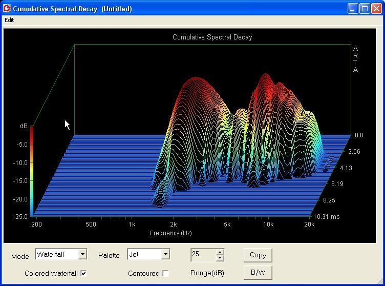

I once treated an old paper tweeter with hardwax oil. The CSD was almost as poor as the frequency response before treatment.
The stuff is not cheap, but contains lots of fine natural ingredients, so you know what you pay for.
