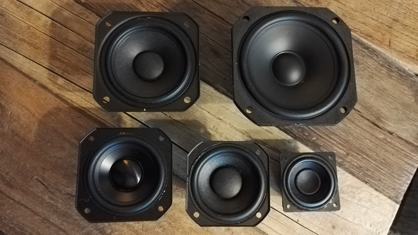

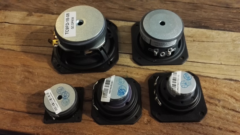

Corner FTC line array with ~2.5" drivers
Inspired by ra7 (link) and oneplustwo (link) I've come to the conclusion that I'd like to try a corner floor-to-ceiling line array. The difference is I'll be sitting closer to the line arrays due to a smaller room (3.9 m x 4.7 m = 12.8' x 15.4'). This leads me to think that a slightly smaller driver is appropriate (Combing worse when close to array and when driver ctc distance is large).
The SB acoustics SB65WBAC25-4 gets a lot of praise, but putting 40 of them in each speaker is a little expensive for me. So I've looked around and found 3 alternatives:

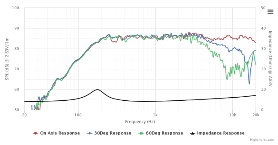

Peerless TA6FC00
$8.9 each.
Aluminum cone.
Neo motor.
Peerless TC6FC00/TC6FD00
$7.1 each (neo)/$5.1 each (ferrite).
Paper cone.
Visaton FR 58
$6 each.
Paper cone.
Ferrite motor.
They all need EQ to reach 80 Hz (where subs will take over), but the Peerless ones have about twice as much Xmax which should make things easier.
I found this thread interesting: link. The use of waveguides to reduce combing problems is interesting. I'll try to simulate this.

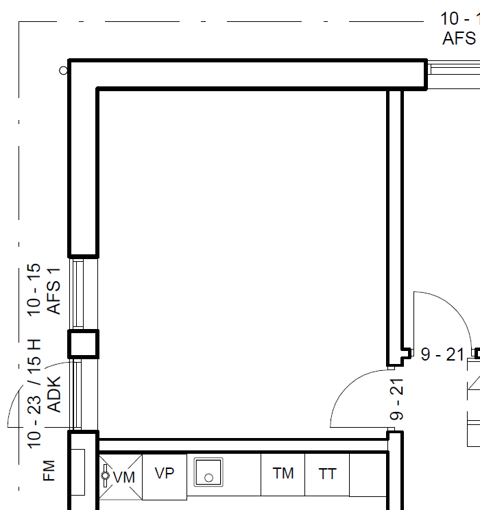

I've just started construction of the house where the speakers would be used, so this is in a very early stage...

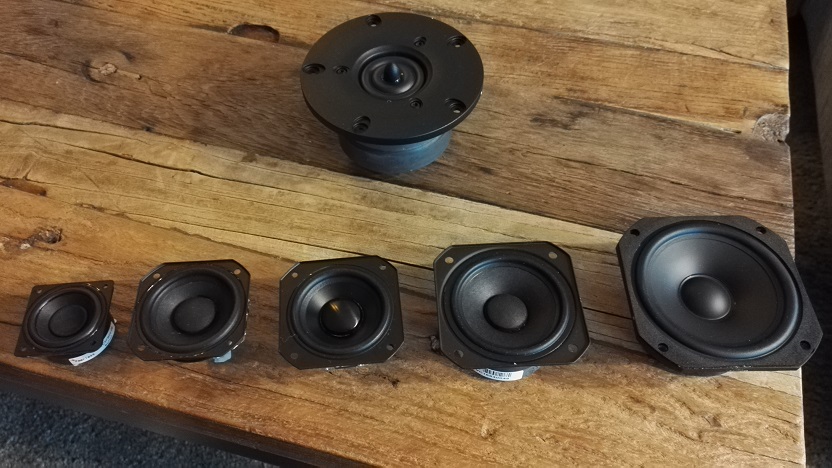

Forgot a picture of the FR 58:
All models are suitable for rear mounting, which I think is a good idea in this case. The plan is to place the drivers in the throat of a 90 degree horn, as if the speakers were wall integrated. I'll upload a few sketches later.
/Anton

If that Visaton graph is real I like it. its the only one with a smooth rising response, quite handy for array use. Too bad it has lower x-max numbers.

The room I will have mine in the short term is 4.1m x 4.7m.

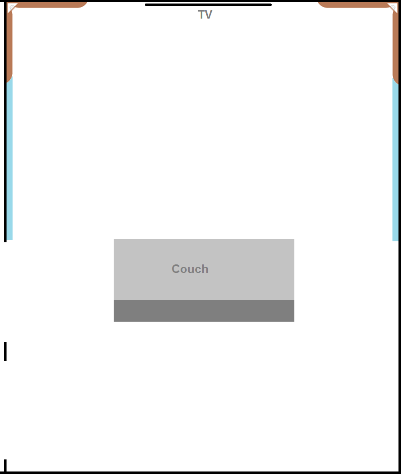

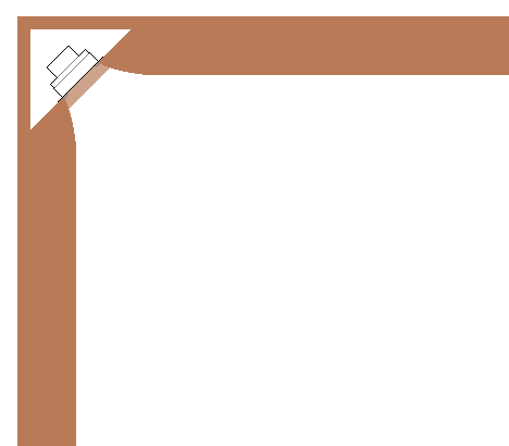

Enclosure idea
So the idea is to
1. Make an "invisible" speaker, i.e. in the corner.
2. Make a waveguide to control directivity (wide sweet spot).
This is my first idea for the enclosure:
The thickness of the enclosure is about 10-12 cm. The volume can be made big if necessary, the rest of the waveguide can also be made into a bass trap.
Looks like this in room:
The blue lines that extend the speaker enclosure (waveguide) are absorbers with the main purpose to remove the reflection from the opposite speaker. The idea is to cover the entire thing (speaker + absorber) with the same fabric.
/Anton

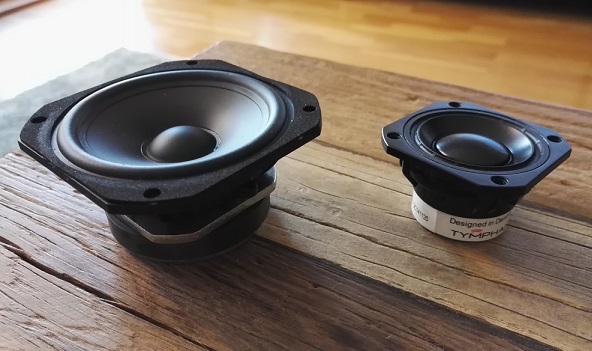

Here is a quick comparison of a TC6FC00-04 (Orange) vs a TC9FD18-08 (Yellow) vs Aura NS2 (Green) The other's aren't in the database.
I have used 3 watts as that is where the TC6 reaches x-max.
SPL at 3W
Excursion
Maximum Output
Box parameters used in model
I think this sort of graph is relevant as it gives you a better idea of the sort of spl the system will be capable of.
I still think the TC9 has the best set of compromises but I can see why you would want a smaller driver. The tricky part is finding a good one that doesn't cost too much.
I really like the integrated waveguide, seems like the best way to do a corner array to me.
Looking forward to see what you come up with :)

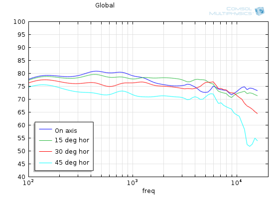

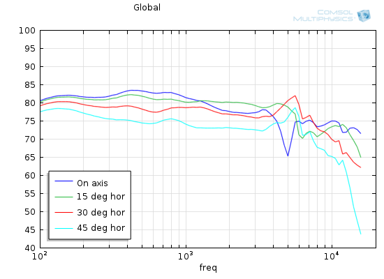

A smaller driver should (at least in theory) be easier to control. The directivity should be really wide up to a higher frequency and thereby controllable by a waveguide. When the cone diameter is in the same size as the wavelength it starts beaming and a waveguide doesn't really work.
The TC9 really has a nice behavior in the spec sheet, there is however a quite apparent widening in the response around 3 kHz that I don't really like:
Measured 0-90 degrees. Figure from mehlau.net here: link.
My earlier work with waveguides combined with a 1" ringradiator (ScanSpeak R2604) resulted in a speaker with this response:

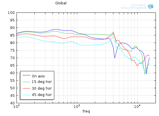

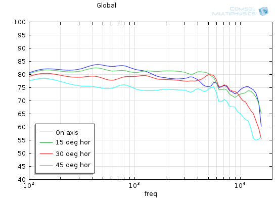

Simulations!
Alright, so I've started doing some sims. The first ones I've put in ra7's thread, as they are for the TC9FD18. Here is the latest one with a flat waveguide 1 mm from surrounds (approximately as in ra7's line arrays):
I have the TC9FD18 and Peerless 830970 at home, so I've started with them (as I can measure them fairly well):
The 830970 is well suited to rear mount in a waveguide with its inverted surround. Here are simulation results from a simple rear mounting in a 7 mm thick baffle and chamfering the hole. Line 55 mm ctc distance, floor to ceiling array, result at 2 m distance.
And here is with an approximated geometry for the TA6FC00:
The surround makes it more difficult to make a smooth transition from cone to waveguide which is probably the reason for the dip at 16 kHz.
They are both a first iteration, I'm pretty sure I can improve the response a little.
/Anton

For comparison of the results in my last post is the TA6FC when front mounted in a 59 mm baffle:
Rear mounting seems like a really good idea :)
/Anton
Drivers have arrived!
The drivers I ordered Thursday evening arrived today, that's impressive! Here they are:
Here with a comparison to the TC9 and a ScanSpeak R2604 (that I have from earlier). From left to right: TC5FB00, TC6FC00, TA6FC00, TC7FD00, TC9FD18.
I didn't know that the TC6FC was smaller than the TA6FC (55 vs 59 mm width).
/Anton
