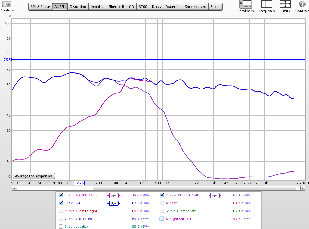

I was able to make some sweeps today. Once again, I couldn't crank it up, this time because of a leaky enclosure. The bass sealed box was not so sealed after all. I could hear wind noise escaping the "seams" and the whole thing was not great. It will need some more work.
Speakers are about in the middle of the long 10m wall, set 2.5m apart and 1m off the back wall. Listening mic is at the other equilateral peak of the triangle.

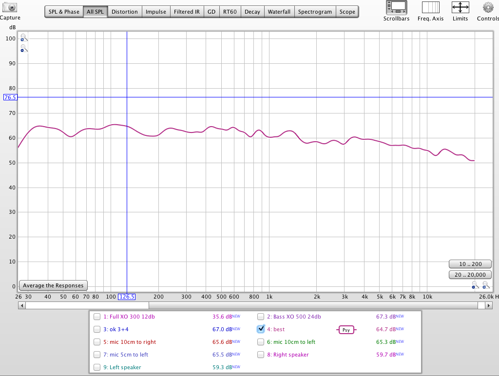

It started promising. I first adjusted levels between the 2 drivers. Then, after multiple tryouts, I settled on a not so traditional XO. It is set at 500Hz for the bass with 24dB curve, and 300Hz with 12dB curve on the fullrange.
I then tamed the peaks making the W8-1772 usually a bit shouty. Doing so resulted in a nice downslope of about 10dB from start to finish, my FR goal.
Looks like this:
Now, I tamed that hill at 110Hz, and I got this:
Remember the leaky bass enclosure? Here it is, against the other one I made out of plywood. Left is plywood, right is the leaky foam board.
I didn't add any DRC yet, so, I hope it can only improve.

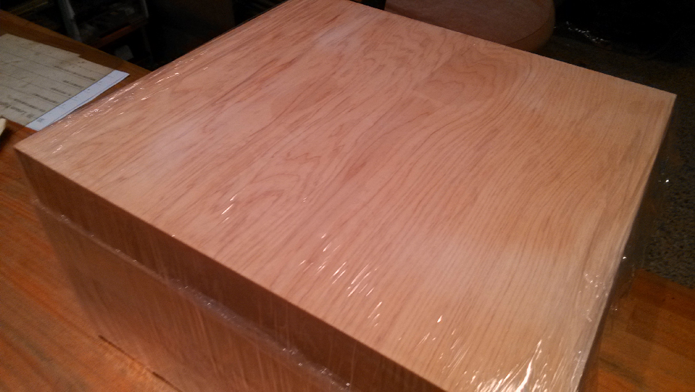

I already got some nice camphor wood blocks for the small OB. Camphor wood looks amazing once stained and varnished, has an amazing smell, and since it's full of camphor resin, it is quite dead when knocking on a piece. Plus, at 5cm thick, it should be plenty rigid!

Marble OB? I could... but I think the combination of marble bottom, and Camphor wood OB might look good too! It's such a pretty wood, and it smells great too!

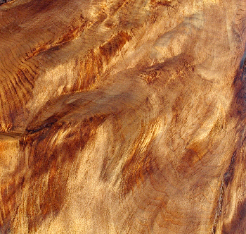

That wood is quite dope! The 3D patterns once it's polished and epoxied over are so cool.
Father-in-law used to make vases and tables with that wood. Here's the biggest he made, and a pic while we were measuring it to enter the Guinness book of records as the largest Camphor wood vase ever made.
