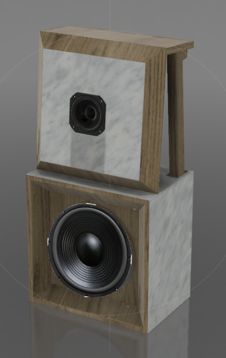

Thanks for the folks from the line array build, I got introduced to Fusion360...
My days of doing 3D work were about 25 years ago... and I was using FormZ at the time.
I never caught the SketchUp bug, hated it actually.
I'm far from anywhere with Fusion, having a few hours of practice, bu I like it so far... just a little sluggish at times.
Ronald will be happy I'm going back to marble, and wood design.
This file has some mistakes, and not finished design wise. It's a U Frame sub (didn't have a cad file so it's just a 2D picture pasted there), and an OB fullrange (here with wesayso's TC9 cad design... thank you!)
I think I like where this is going...

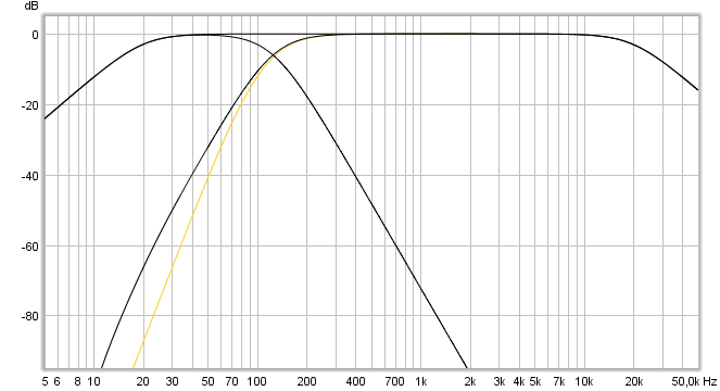

Active crossover then LF EQ managed to correct quite well. The subs and fullrange are equidistant and well away from walls. Seems more than a coincidence that the only problem is at crossover. The dip is very narrow, about 10Hz at most, is that to be expected? I'm measuring using amplified panasonic wm61a and oscilloscope
Be aware drivers by themself have a natural acoustic stop-bands roll off so if active electric XO is textbook LR 4th order at 125Hz then final slope sum (LR4 x acoustic roll off) can end with some error. Below black curves show LR4 at 125Hz that will sum flat in amplitude and be in phase although a rotating phase, where orange curve show the error from ideal if one add textbook active electric LR4 at 125Hz to a driver that has say 80-20kHz acoustic band width. So target is to hit those black curves in acoustic domain then they sum in amplitude and be in phase in XO region with some added group delay coused by the minimum phase rotating XO point.
Think 125Hz area is overall hard to measure right and probably especially when using oscilloscope method, because XO point is so low in frq suggest as a test scenario do near field low level measurement with ~1cm microphone distance in center of cone and then try to get subs and OB fullranger hit ideal LR4 curves in acoustic domain with whatever means of electric EQ plus strange XO slopes it takes to hit those acoustic target curves. Then if acoustic center for subs and OB fullranger have same distance to listening position and polarity is right system should be tuned in theory correct and if further errors show up its probably room boundery modes as pointed by perceval. Regarding polarity be aware that some power amps without warning in reality happens reverse polarity for output verse input.
