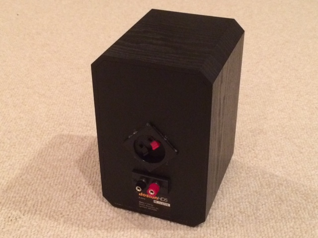

I have an old pair of Boston Acoustics HD5's with rotted foam woofer surrounds lying around for past couple of years. Always been meaning to replace the surrounds... I got some new Aurum Cantus AC130F1 drivers in the other day (same ones used in Jeff Bagby's Continuum, the advanced tech redux of the LS3/5A) and I needed a box to test them in. The HD5's were a perfect fit. They actually sounded almost passable when hooked up to the stock XO and paired with the 3/4in mylar dome tweeter. So I got to thinking, what if I swapped that tweeter for a nice 2in full range driver, and active bi-amped it for a very cute little FAST desktop monitor. Cute because the boxes are 6.25in W x 9.5in H x 7.0in D.
Edit: typo the title says FR56EX but actually FR58EX.
Fountek FR58EX 2" Neodymium Full Range Speaker Driver
I have some Fountek FR58EX's (thanks to Byrtt!) lying around from the recent data collection for the Round 5 of the Subjective Blind test thread. They sound like aluminum dome tweeters but can be crossed very low as they have an fs around 150Hz. One of the nicer aluminum drivers that don't ring. The AC130F1, is one of the nicest mid bass drivers I have tested - it has a super flat response, not unlike a ScanSpeak 10F, but only goes up to 10kHz and has no cone break up peaks.

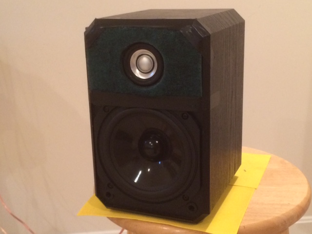

I made a small 4-side Dagger for the FR58EX (3in base x 5.75in high foam core panels x qnty 4), stuffed tightly with polyfill. I went with 4 sides to make the volume larger and to accommodate the square cutout for the tweeter. I removed the stock terminal cup/XO board and replaced with a plain terminal cup. I added a 5-way banana post binding terminals for the woofer. Stuffed the box (circ 5.7 liters) with stock polyfill and added some more for good measure.
Here is a photo showing the detail of the Dagger as mounted with the FR58Ex:

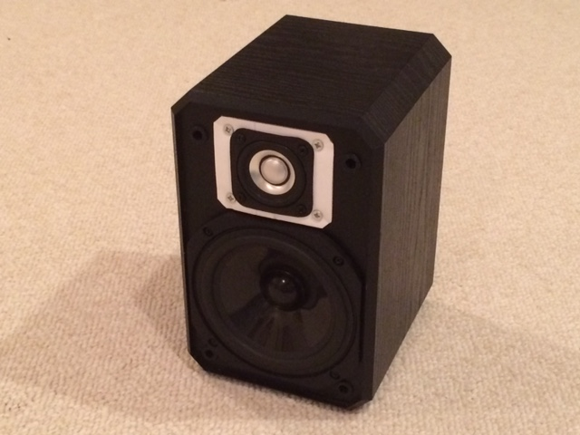

Here is a photo of the completed speaker front:
Back showing the terminal cup and binding posts for bi-amping:
Edit - update Sept 28, 2015: added diffraction control Scotchbrite pads - it really works as can be seen in measured response below:
Effect of diffraction control (brillo pads):

I listened to a few songs and it sounds really good. It renders percussion like it was meant to be heard. Below are some sound clips to demonstrate the time accuracy and also vocals so you get the sense of the balance in the voicing. Change .asc to .mp3 to listen.
Square waves at 1700Hz XO frequency:
If you have some old cabinets lying around, consider converting them to a new FAST.
Update Nov 28, 2015: Stereo Pair completed.
