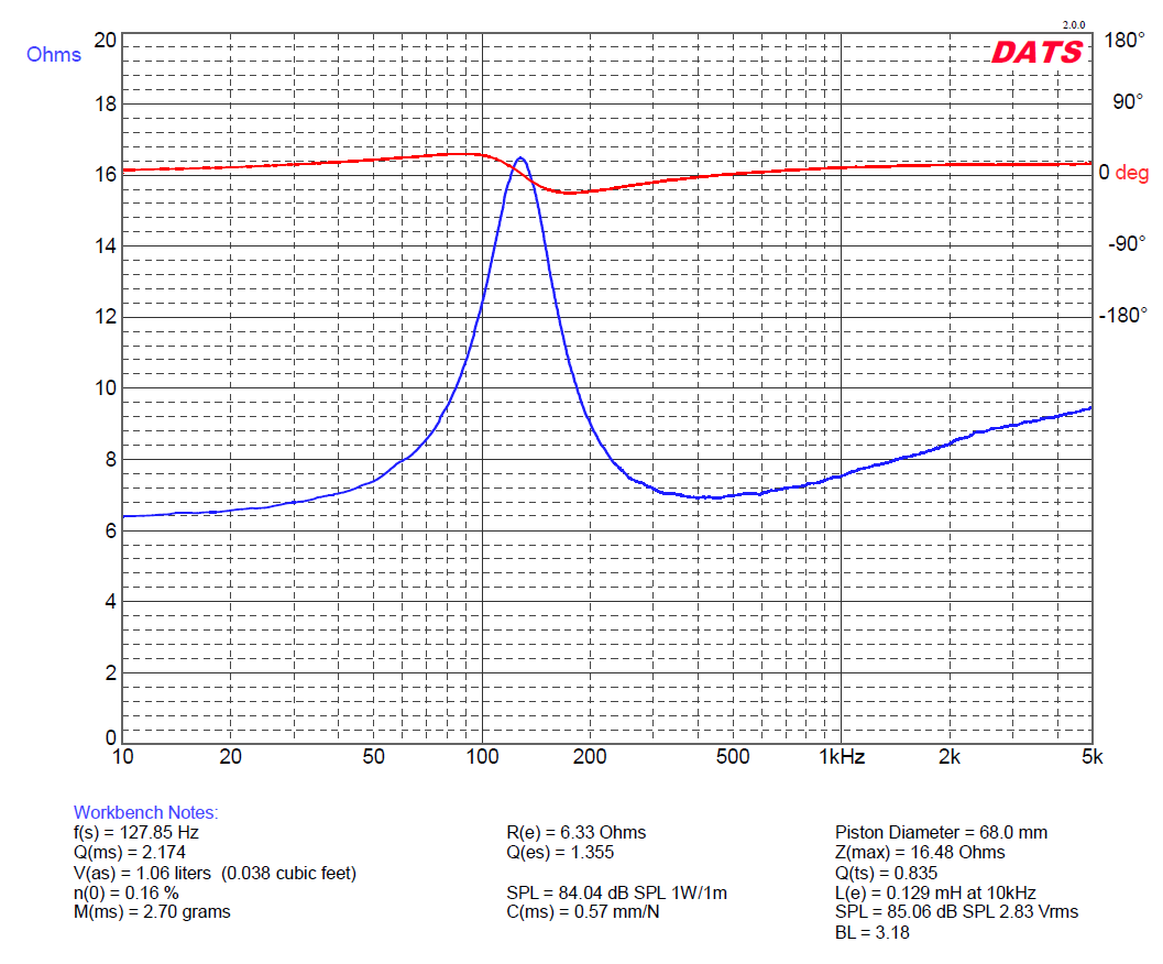

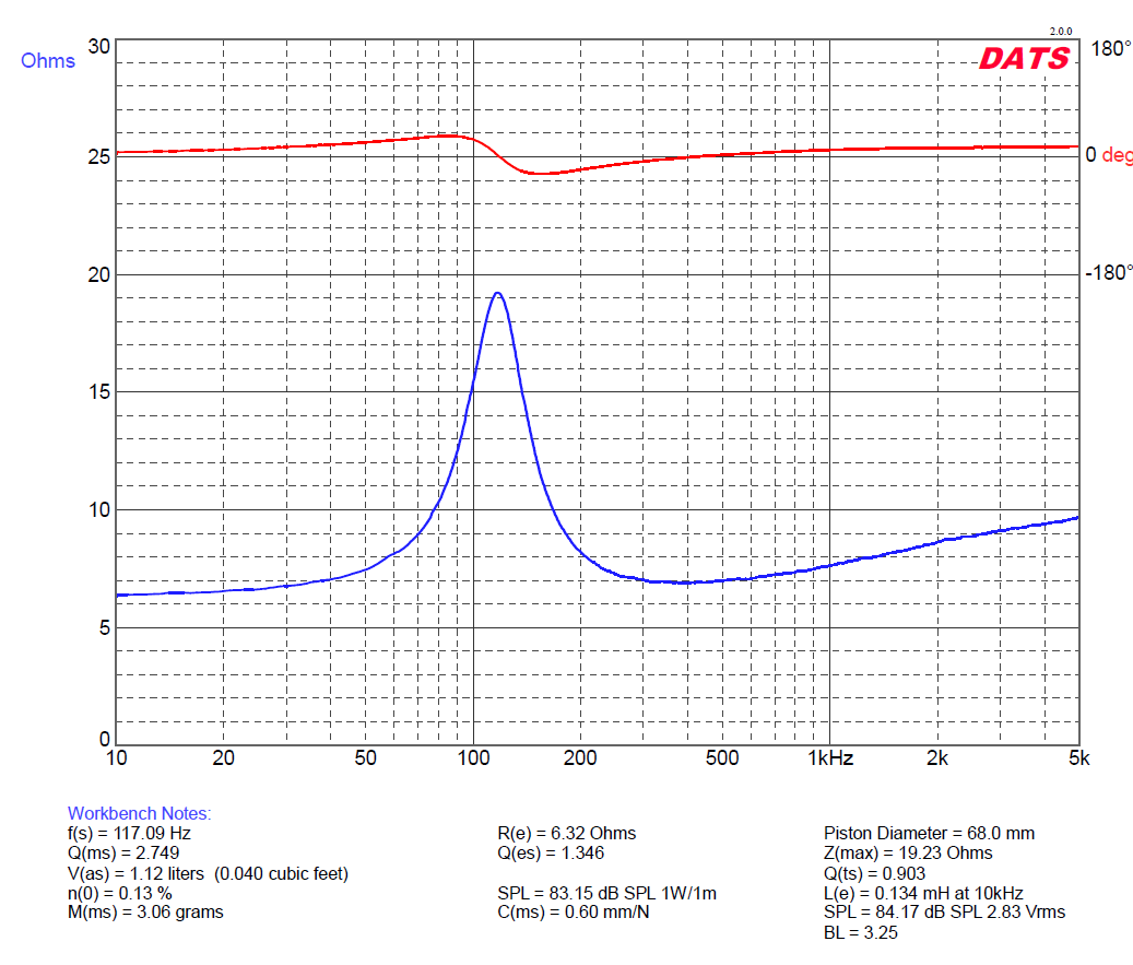

I just measured the TG9FD10-8 that I have and the Qts is quite a bit higher than spec, actually higher than my TC9FD, which is supposed to be 0.89.
Here is DATS T/S (using added mass) for TG9FD:
Here is DATS T/S (using added mass) for TC9FD:

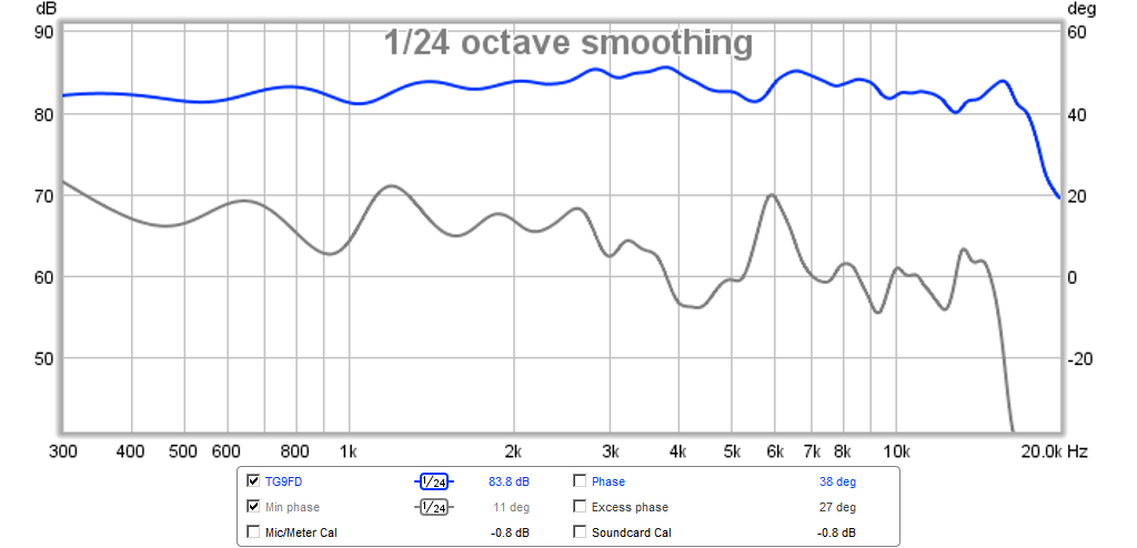

Here are some initial measurements in the Nautaloss and trapezoidal baffle at 0.5m, 0 deg, 0.71volts, no miniDSP - straight to amp.

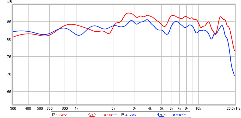

Freq response as compared to TC9FD - the TG9FD appears to be smoother than the TC9FD, but with a tad less sensitivity:

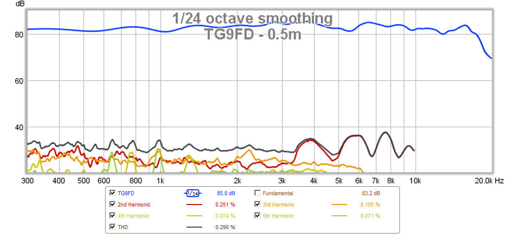

Harmonic Distortion is actually very low, not quite as good as the 10F/8424 but a very respectable performer:

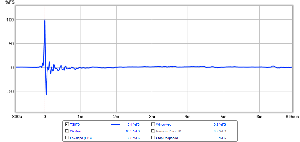

Impulse Response - very clean, almost similar to the 10F/8424:

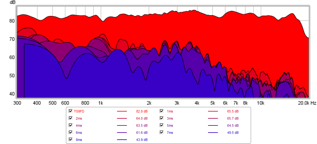

CSD:
Given the similar cone material between the TG9FD and the 10F/8424, this driver appears to be a low cost, less sensitive alternative. A very nice performing driver. Sounds very good too but have not had too much time to listen.
I wonder if break-in might loosen up cone and change the Qts a smaller value.

It seems that increases elasticity of rubber surround on TC9 after a long brak-in.

I am almost coming to the conclusion that the TG9FD10-8 may be the hidden gem here as it is smoother than the TC9FD. For double the price - it may be well worth it given how close it is to the 10F/8424. You will have about 1.5dB less sensitivity though.

Seems my guess wasn't wrong and it's in the middle of the other two as it's price suggests based on measurements. Maybe even closer to the 10F than to the TC9.

You were right. The TG9FD10-8 is the poor man's 10F! 🙂 I like the 25 watt rating of the 8ohm glass TG9FD much better than the more common 4ohm one which I believe has a much lower power rating. They almost seem like they are going to be out of production so get them while they last.
