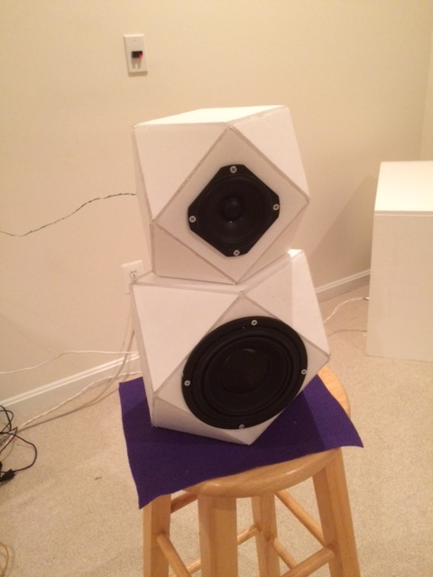

There is a neat rhombic dodecahedron enclosure concept being discussed in the Full Range forum: http://www.diyaudio.com/forums/full-range/265053-hypercube-loudspeakers.html So I had the idea of using it in a 2-way rather than as a standalone full range by stacking a small Hypercube on top of a larger one (both sealed) for a two-way speaker. I am using Tang Band W5-876SE for the bass driver and a Vifa TC9FD for the mids/highs in an active setup via miniDSP and TPA3116D2 amps for XO and EQ duties. Here is what it looks like:
Side view:

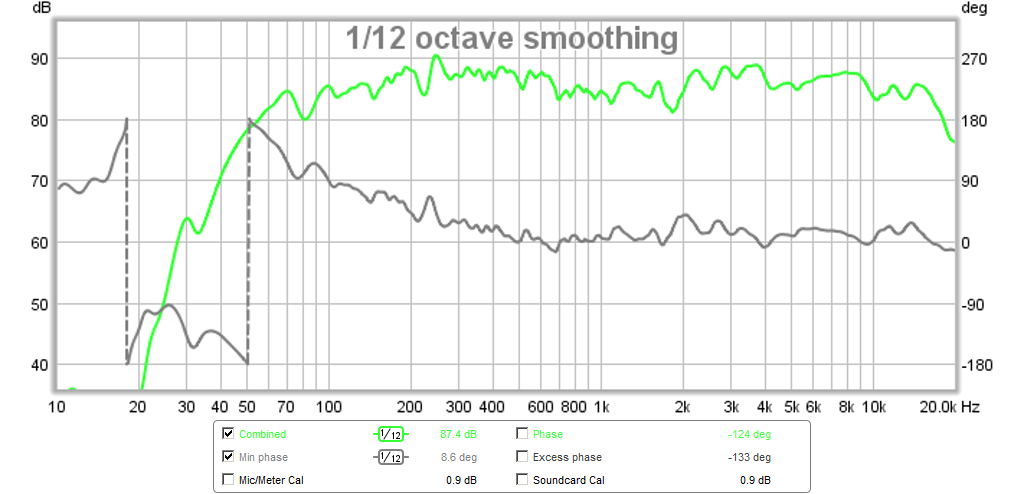

In the miniDSP, I am using a -24dB/oct Butterworth XO at 300Hz, and I boosted the woofer to extend the bass down to 50Hz or so, and put a -5dB baffle step EQ shelf on the TC9FD. Within 30 minutes I had myself a nice FAST Hypercube setup, which I am naming HyperFAST. It was actually very fast to make once you have the housings and a miniDSP active system already. The Tang Band woofer is 87dB and 16ohms which provided a fortuitous match to the less sensitive 8ohm Vifa (85dB) - the levels matched perfectly without any relative gain adjustments. The slight offset of the top provides a natural time alignment. You can see that the phase worked out very flat through the XO region.
Here is the measured XO with and without EQ on the top (purple is before EQ peak cuts, red is woofer, blue is TC9FD, green is combined):
Here is the minimum phase - not bad at all:

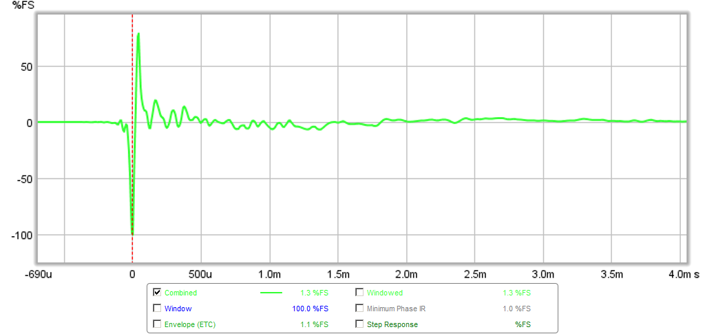

Here is the Impulse response - pretty clean and tight with a mild ringing that can probably be cleaned up with EQ cuts to some of the peaks:
I have not had much of a chance to listen to it, but what I have heard is very nice - great balance and clear clean vocals.

In looking at the back of the hypercube when it is angled up, I can see how the shape and flow of the back of the enclosure could improve how the wave travels off the face and around the enclosure, perhaps having a positive effect on diffraction.

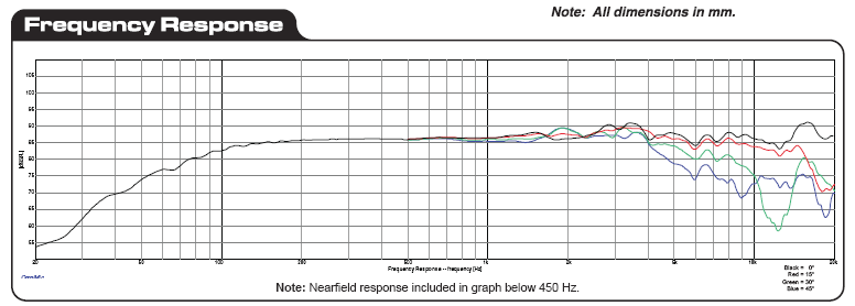

Byrtt has generously offered to provide me some Dayton RS100-4's to try out in these speakers. Hopefully they can allow the XO point to go down lower because of a lower fs. Will give them a try when they come in. Thanks Byrtt!
http://www.parts-express.com/pedocs/specs/295-378-dayton-audio-rs100-4-spec-sheet-revised.pdf

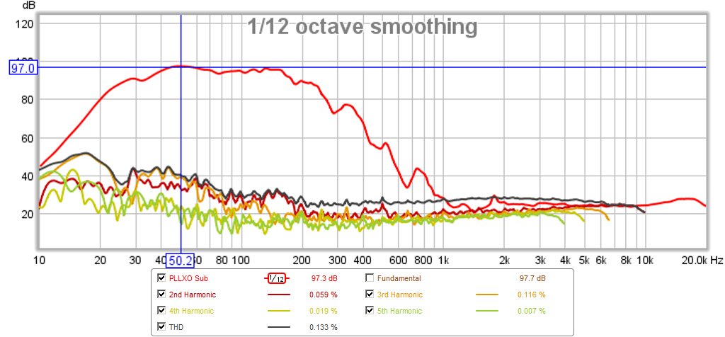

The TB W5-876SE when used qnty 4 in parallel (4 ohms total load) can be very low distortion and sound excellent. Here it is used in a bass horn with 2.83v drive. As you can see, these are very low levels of HD for the SPL levels produced. This was going through a simple line level passive XO (low pass filter) at circa 150Hz.
As a single driver in a sealed alignment with EQ boost (essentially a Linkwitz transform) to reach 60Hz, there is considerably more cone movement (2-3mm to reach 90dB at 60Hz) and more harmonic distortion approaching 8% at 50Hz. But for lower to mid 80dB listening levels, the levels of distortion are probably 2% to5% and are not a big deal. I think that much of it may be the foam core walls. I think wood walls on the bass Hypercube should be used here.

My sim in "Winspeakerz" in sealed box gives nearly exactly same F3 as TC9FD. RS100 better in real world practically sized box volume, example set both to Qtc 0,756 where TC9FD need unpractical 20 liters RS100 need 1,4 liter. Combine RS100 more realistic reachable box size the better Xmax 4,0mm verse TC9FD 1,5mm is what make me think RS100 can go lower by same box size, add if the application/room do not demand the drivers max SPL we have some headroom where some EQ could exploit the last Xmax. Think gmad went for 0,7 alignment (~2liter) in Hupercube, this alignment is unreachable by TC9FD because drivers own Qtc 0,72 but even setting it on 0,73 it needs ~73 liter. If xrk971 current Hypercube box is ~3 liter here a attached sim the two drivers in same box, RS100 4,0mm Xmax misses in plot 🙂) difficult to extract the right volume from the discussion xrk971 and Tesserax had this subject over at thread http://www.diyaudio.com/forums/full-range/265053-hypercube-loudspeakers-13.html#post4128860). Hope not did mistakes.
Edit: In plot at F3 and F10 there's dotted line good at pointing out the drivers lowend compared same box size.

Great if actual volume is 3 liter then the plot show what happen if you exchange TC9FD by RS100.
EDIT: The present data TC9FD i have says linear Xmax 1,5mm Xpeak 3,0mm, have to investigate.
