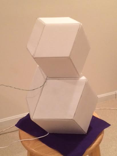

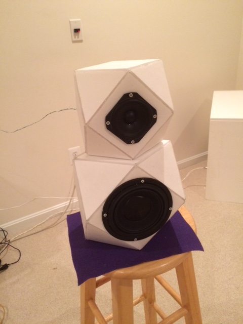

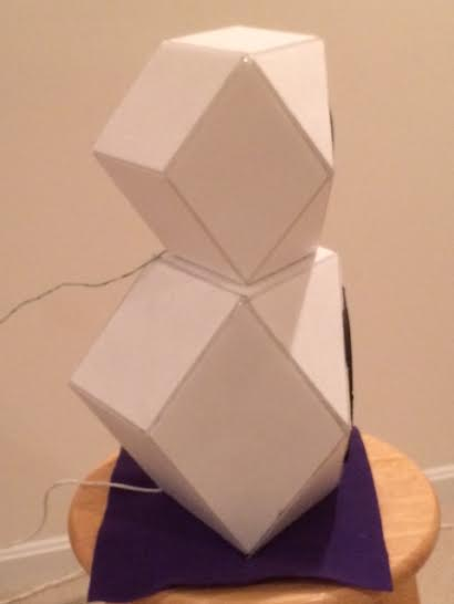

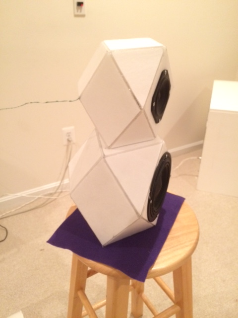

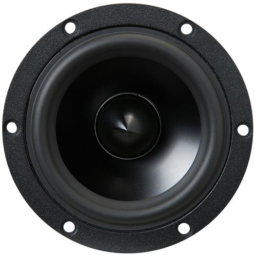

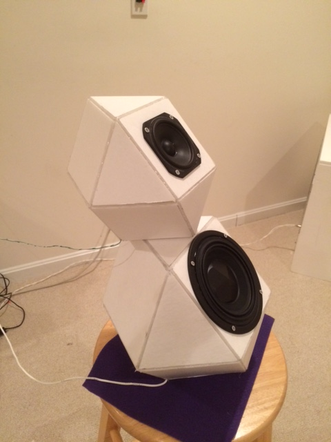

There is a neat rhombic dodecahedron enclosure concept being discussed in the Full Range forum: http://www.diyaudio.com/forums/full-range/265053-hypercube-loudspeakers.html So I had the idea of using it in a 2-way rather than as a standalone full range by stacking a small Hypercube on top of a larger one (both sealed) for a two-way speaker. I am using Tang Band W5-876SE for the bass driver and a Vifa TC9FD for the mids/highs in an active setup via miniDSP and TPA3116D2 amps for XO and EQ duties. Here is what it looks like:
Side view:

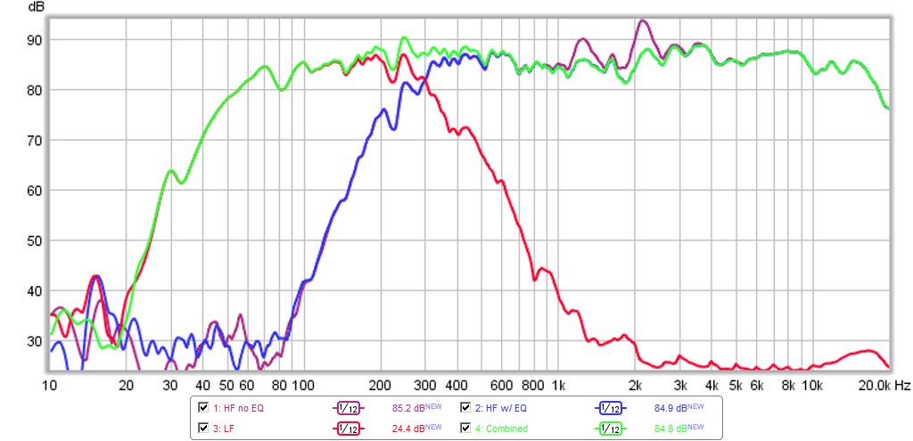

In the miniDSP, I am using a -24dB/oct Butterworth XO at 300Hz, and I boosted the woofer to extend the bass down to 50Hz or so, and put a -5dB baffle step EQ shelf on the TC9FD. Within 30 minutes I had myself a nice FAST Hypercube setup, which I am naming HyperFAST. It was actually very fast to make once you have the housings and a miniDSP active system already. The Tang Band woofer is 87dB and 16ohms which provided a fortuitous match to the less sensitive 8ohm Vifa (85dB) - the levels matched perfectly without any relative gain adjustments. The slight offset of the top provides a natural time alignment. You can see that the phase worked out very flat through the XO region.

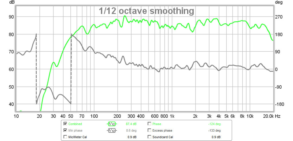

Here is the measured XO with and without EQ on the top (purple is before EQ peak cuts, red is woofer, blue is TC9FD, green is combined):

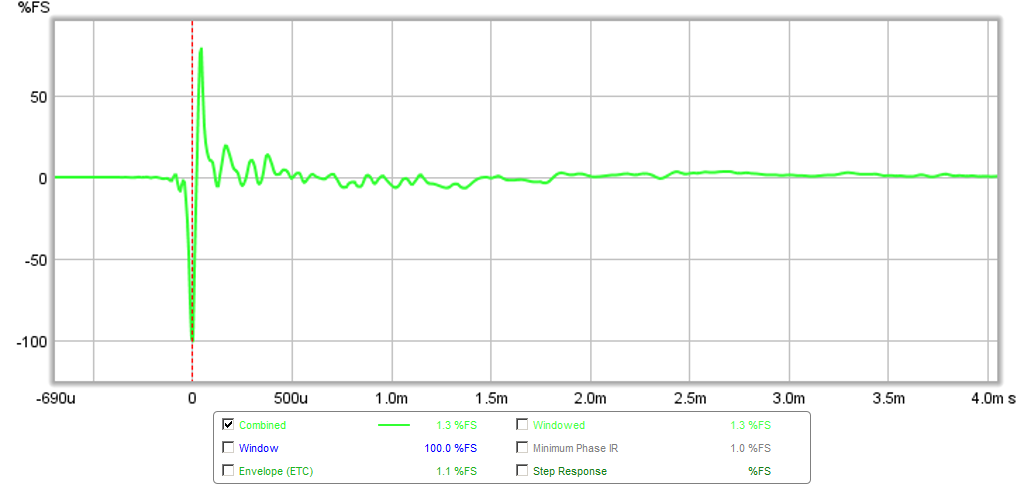

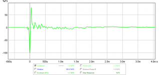

Here is the Impulse response - pretty clean and tight with a mild ringing that can probably be cleaned up with EQ cuts to some of the peaks:

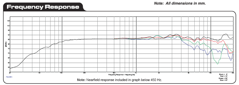

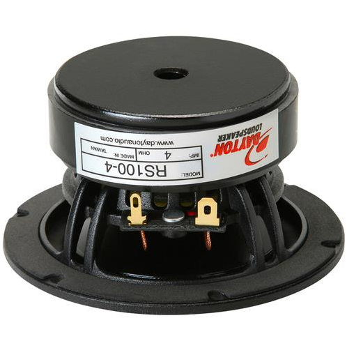

Xrk:
hiw would you describe the so7nd from the TB W5? When EQ to extend it to 50Hz? No excursion limit at RMS power? No distorsion at higher volumes?
Just asking cause Im looking for some decent 4-5 inch woofer that could go to 50-60Hz in a 2.5L box.
Danny

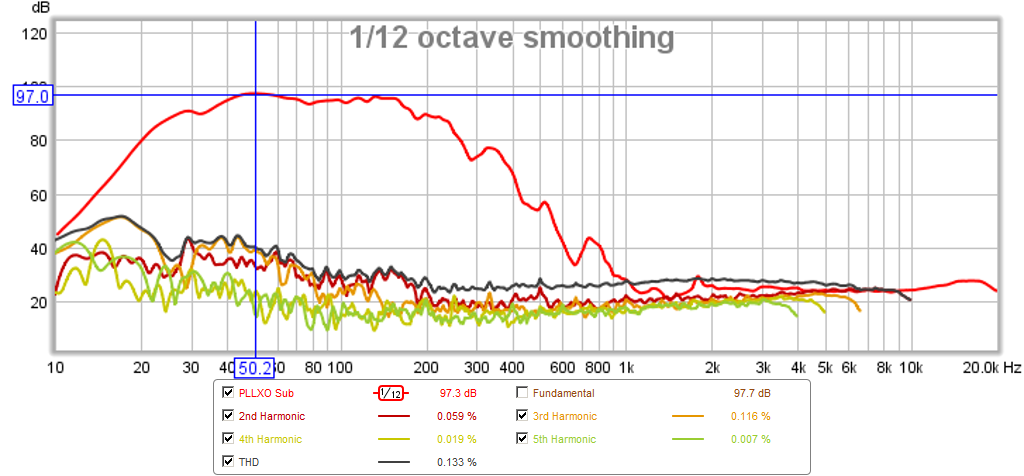

The TB W5-876SE when used qnty 4 in parallel (4 ohms total load) can be very low distortion and sound excellent. Here it is used in a bass horn with 2.83v drive. As you can see, these are very low levels of HD for the SPL levels produced. This was going through a simple line level passive XO (low pass filter) at circa 150Hz.
As a single driver in a sealed alignment with EQ boost (essentially a Linkwitz transform) to reach 60Hz, there is considerably more cone movement (2-3mm to reach 90dB at 60Hz) and more harmonic distortion approaching 8% at 50Hz. But for lower to mid 80dB listening levels, the levels of distortion are probably 2% to5% and are not a big deal. I think that much of it may be the foam core walls. I think wood walls on the bass Hypercube should be used here.

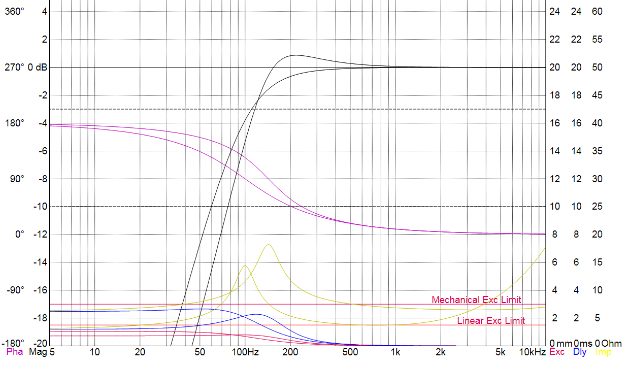

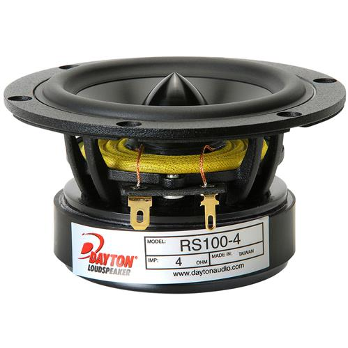

My sim in "Winspeakerz" in sealed box gives nearly exactly same F3 as TC9FD. RS100 better in real world practically sized box volume, example set both to Qtc 0,756 where TC9FD need unpractical 20 liters RS100 need 1,4 liter. Combine RS100 more realistic reachable box size the better Xmax 4,0mm verse TC9FD 1,5mm is what make me think RS100 can go lower by same box size, add if the application/room do not demand the drivers max SPL we have some headroom where some EQ could exploit the last Xmax. Think gmad went for 0,7 alignment (~2liter) in Hupercube, this alignment is unreachable by TC9FD because drivers own Qtc 0,72 but even setting it on 0,73 it needs ~73 liter. If xrk971 current Hypercube box is ~3 liter here a attached sim the two drivers in same box, RS100 4,0mm Xmax misses in plot :)) difficult to extract the right volume from the discussion xrk971 and Tesserax had this subject over at thread http://www.diyaudio.com/forums/full-range/265053-hypercube-loudspeakers-13.html#post4128860). Hope not did mistakes.
Edit: In plot at F3 and F10 there's dotted line good at pointing out the drivers lowend compared same box size.
Thanks for the calcs Byrtt. Is the curve with overshoot the TC9FD? The xmax on TC9FD is 2.7mm but I agree that 4mm is way better - similar to the xmax on the CHR70 and A7, and RS100r may be good competition for those drivers with the benefit of a nice alloy frame that doesn't crack easily. The Qts is similar too.
Regarding the volume: it is something I have to come to grips with that Tesserax's geometrically based approach must be correct (11/6 a^3) where a is the length of the square baffle edge or V=1.833*a^3. For the Hypercube I made with a=4.62in (11.73cm)=2960cm^3 or 3 liters.
I have gone through my trigonometrically-based derivation and still cannot find fault with it, other than it doesn't match the geometric derivation of 1 cube + 5/6 of a cube or 11/6 of a cube in volume.
Yes TC9FD is the overshoot plot which maybe graphical fine for bafflestep correction running as fullranger, but when doing FAST maybe better bafflestep corrected with same amount minimum phase EQ to both LF and HF drivers to give them same phase but maybe I'm wrong I'm little unsure what really happens at phase when electrical and acoustic domains are summed, to better understanding the phase domain think would be nice be close family to Tom Danley :)).
"Crack easily" ups we better wash our mouths.
Great if actual volume is 3 liter then the plot show what happen if you exchange TC9FD by RS100.
EDIT: The present data TC9FD i have says linear Xmax 1,5mm Xpeak 3,0mm, have to investigate.
