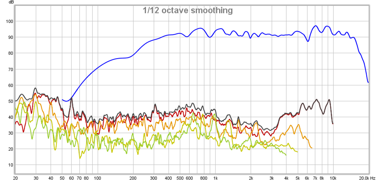

OB Data with higher resolution
Here is the data for the 5MR450NDY mounted in my OB setup (slot loaded OB) with 5 dB major tic increments.
0 deg:
15 deg:
30 deg:
45 deg:
60 deg:
Here is the HD for the 0 deg case with a 10ms gate applied to remove near field reflections:
