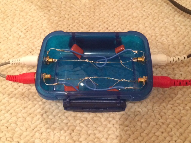

I will put stuffing in and measure again to see if there is a difference. In the meantime I came up with a simple 2nd order passive line level XO to integrate these Hypercubes with a sub at 200 Hz. Sounds really nice - will have to get some sound clips soon.
Here is a photo of the PLLXO for the sub - about 200Hz. Costs less than $2.

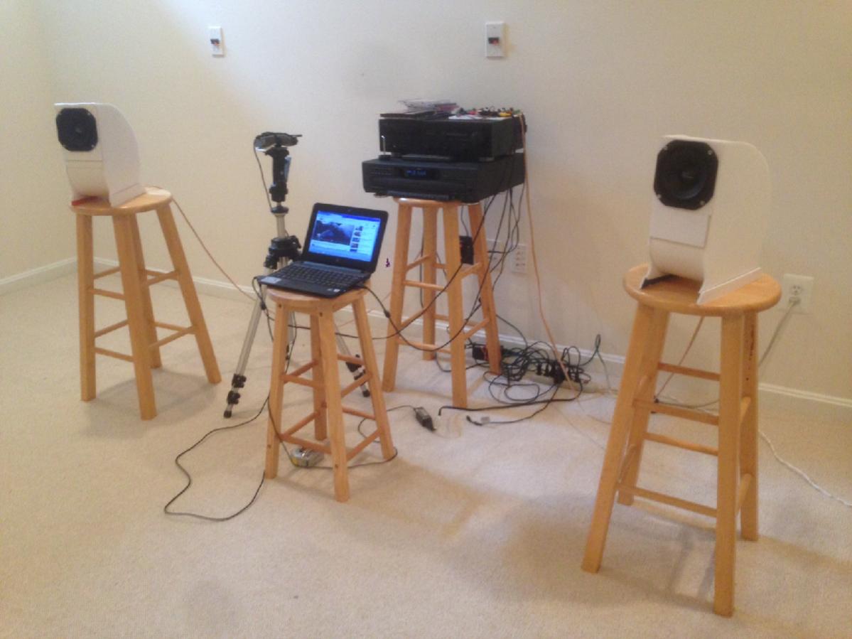

Back to Nautaloss...
After playing around with the Hypercube and HyperFAST, and the AMT - I just cleaned up the speaker lab and put the 5MR450NDY's back on the stools, re-loaded the DSP script in the miniDSP, and here I am back to a favorite. With a sub woofer filling in from 30Hz to 170Hz, these sound fantastic - and reminds me why it is still one of my favorite setups.
This is what the room looks like again:
The sound is very clear with great imaging and lots of headroom for dynamic passages. :D
Something to be said about a simple full range driver in a sealed IB cabinet.
For some reason, REM's song "Don't go back to Rockville... and waste another year..." keeps playing in my head. :)
