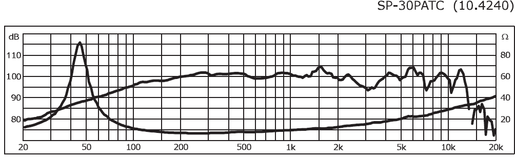

Here is the spec. Nice bandwidth and sensitivity, proper Q for OB. 🙂

The f-currve is quite ok, except for a dip at 3khz.

The dip at 3kHz is the BBC dip, of course ! 😀

A couple of kHz too high for a proper BBC dip, but... 😉

All the references I can remember indicate BBC dip to be at about 3kHz. Is that not proper ?
