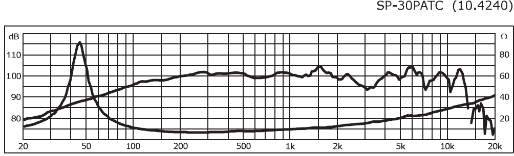

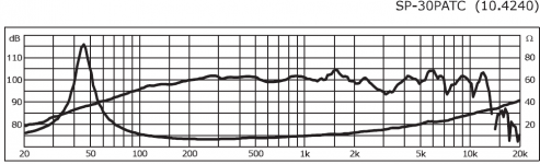

That's not it!
That's just the pa-30patc again, it's all over, it's not the pa-30pax.

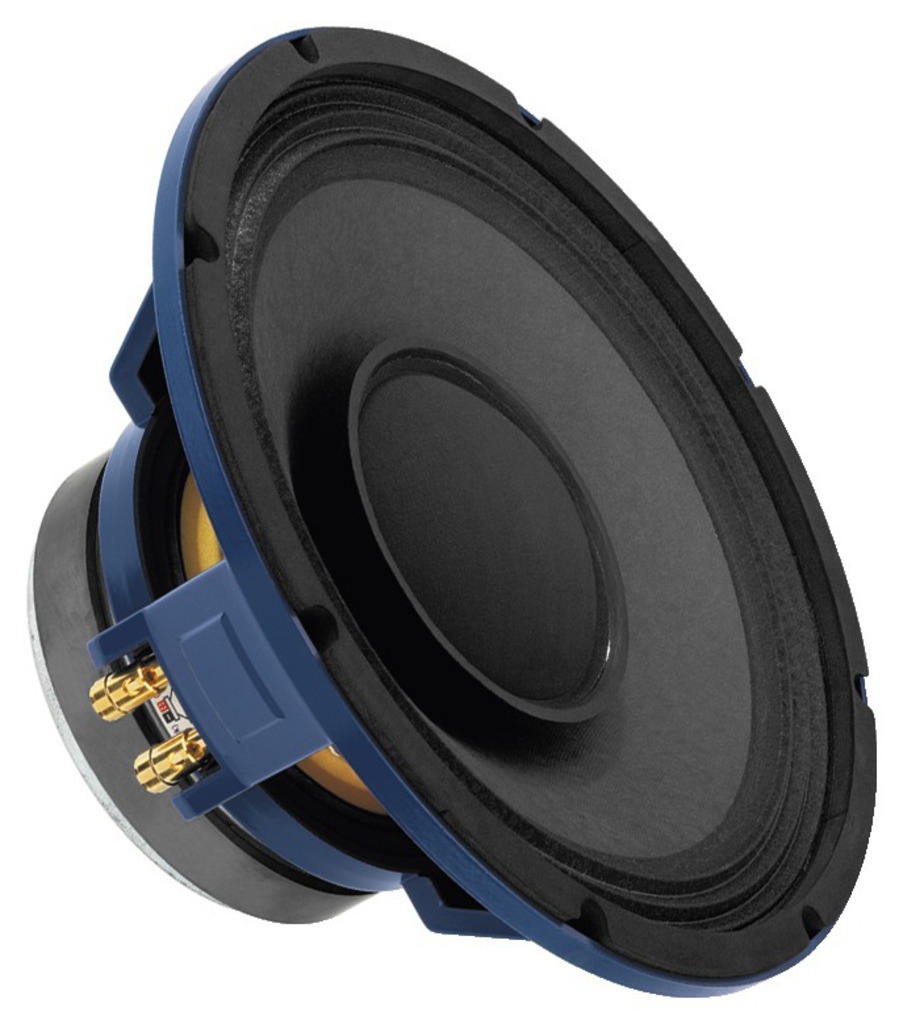

- Full Range
- 12 inch full range SP-30PATC
