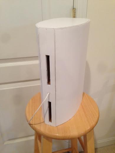

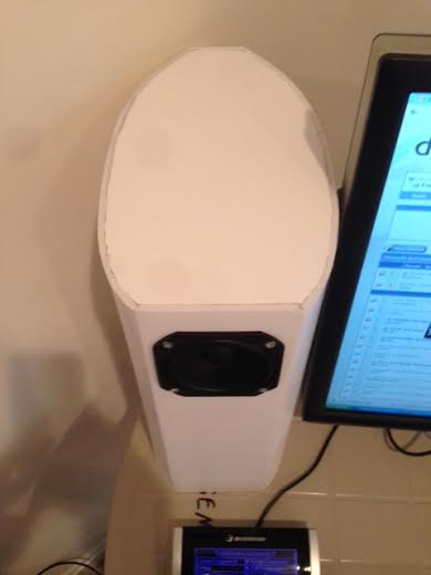

Here is the completed speaker:

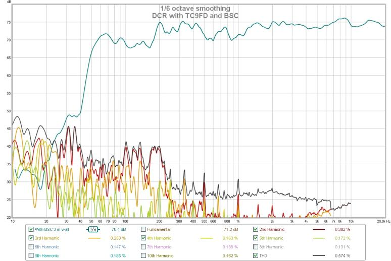

Preview of performance - here is what the FR and HD looks like with digitally applied BSC and bass smoothing with REW via miniDSP:

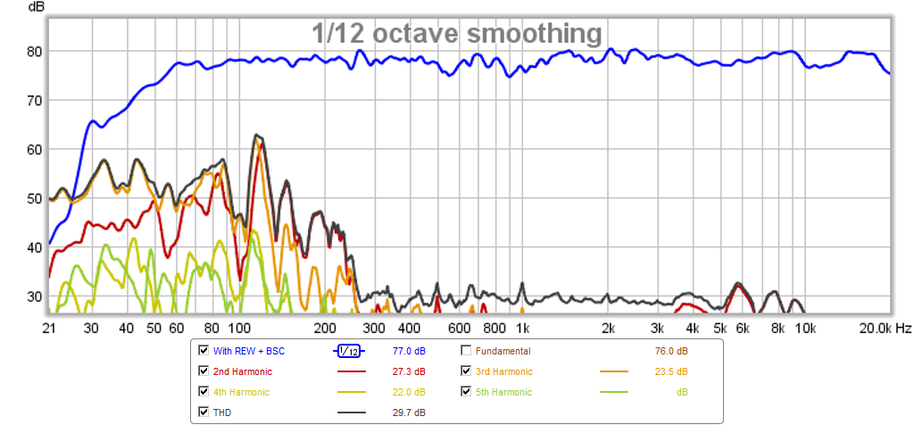

Here is the harmonic distortion performance with a speaker-level BSC and no DSP applied at the desktop listening position:

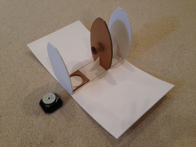

Start by cutting 3 of the rib shapes which define the internal curves. Locate that on a sheet of FC to establish where the two rounded corners are on the front. Then score cuts along along the 14 in length direction every 3 to 5 mm piercing through the first layer of paper with a razor. You will want a straight edge (or a metal drywall "T" is the perfect too to make this go fast) to make sure the lines are parallel. Do not score the flat 4 in wide section in front. The take a razor and remove a 1/8 in wide channel of paper and foam from the corner where the front is to allow a clean fold that does not crunch the paper. Now use a rounded object like a PVC pipe, a radiused countertop edge, etc to pre-curve the shape to allow it bend and wrap around the ribs without too much effort, being careful not buckle it and crease the FC this ruining the piece. Check that the curve can sufficiently follow the curve on the rib without too much force.
Now glue the 3 ribs to the correct locations on the sheet (top, bottom, and 4.7 in from the bottom), add 90 deg braces to the ribs to set the squareness and reinforce them for the next operation. Then add a second layer of either FC or double wall cardboard behind where the driver goes to give the screws more material to grip.
Now here is the tricky part, start gluing the outside panel to one side of the ribs a section (half the length from the front) at a time. You need to make sure the hot melt glue gun has a full stick of glue to start the operation (or have a spare ready and held in your teeth to reload quickly) as you do not have much time and there are 3 strips of glue about 5 inches long each that need to be applies, in addition there is the 14 in long gap where you removed the foam from the crease that needs to be filled with hot melt glue. Once you quickly apply the glue, use your hands to firmly hold and clamp the panel to the ribs to ensure a tight fit (including the middle divider rib). You only have seconds to work and hold it for a good 45 seconds before releasing pressure. Now use the glue gun to add fillets of hot melt glue internally to the joints to make an airtight seal. Next, repeat the hot melt glue and clamp with the remaining length all the way to the rear of the speaker. You may notice that because the speaker is curved and rounded, it is hard to hold steady while you apply hand clamp pressure. You may need to employ your knees, lap, and carpeted floor in combination. It wants to roll and squeeze its way out of your hands as you clamp it. Again, add hot melt glue fillets to seal.
Now repeat with the remaining side, but before doing so, add some internal bracing to reduce the drum head resonances on the large side walls and the top and bottom panel. I used cardboard trimmed to size. You have to wait until the final side panel is glued on partially before adding final side bracing. If you have small hands (and a small hot melt glue gun) there is enough room to squeeze inside and seal the joints on the second panel before gluing the final stretch. On the final stretch, you have to apply copious amounts of hot melt glue to the divider rib because you cannot get to it after the fact so ensure an airtight seal there. The end ribs are not as critical as you can still seal it from the outside as needed.

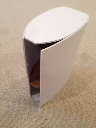

Once you have the curves single piece wrap around side on, it looks like a real speaker. Now trim the rear wall to have beveled edges to fit perfectly into the gap created by the one piece wall, cut two port slots (0.5 in x 4.0 in tall) in the rear wall. Make two slot ports out of FC or cardboard using hot melt glue and then glue them to the back of the rear wall strip. Either use binding post mount or poke a small hole and feed the speaker wire through the rear wall and seal with hot melt glue. Cut the driver hole with an xacto (it is 3.0 inches dia exactly), make sure you have enough wire coming out the front and attach crimped quick disconnect terminals. Add moderate stuffing to the top and bottom chamber (I used pillow stuffing) being careful to not directly block the vents. Then glue the rear wall on - the speaker is now finished except for the BSC circuit.
Install the driver using wood or drywall screws. For those wanting to go the BSC route, put a 1.0 mH air core coil plus a 10 ohm x 10 watt resistor in parallel plus an optional 0.47 uF capacitor in parallel. Put all this in series with the posititive terminal to the driver. Hot melt glue this somewhere in the chamber (preferably at the bottom for stability) before you seal up the speaker.
I am going with the EQ'ing the speaker through my music player on the PC for now until I can get the BSC. It sounds really nice and I think you will like it and agree that the clarity and imaging will be superb. The bass is sufficiently deep at about 50 Hz when the speaker is placed near a rear wall such as when used as a bookshelf or desktop speaker. For in stand mount duties away from a wall, a sub woofer will most likely be needed to get sufficient bass.

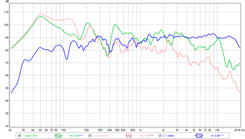

Here is the Freq Response from the ports and the integrated sound - far from walls:
Here is response close to a wall and at 0.5m away and lower drive voltage:

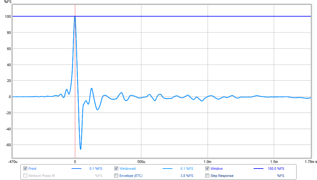

Here is the Impulse Response:

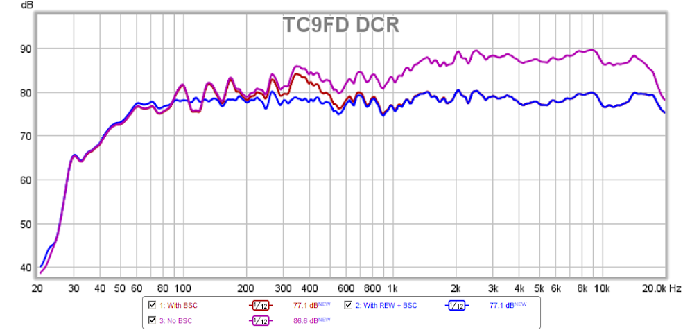

More measurements with BSC applied (via EQ)
I broke down and ordered a pair of 1 mH coils, a 10R 10 watt resistor, ad a 0.47uF coupling cap for the BSC circuit. They cost more than the drivers! I hate passive XO components for this reason but they let you keep a speaker simple in operation for hooking up to any amp.
In the meantime, I implemented the BSC using the PEQ in miniDSP but otherwise running fullrange just to see how it would look/sound. The measurements were made with the speaker 3 in away from a back wall (similar to how they would sit on my desk or bookshelf) at 42 in driver height above the ground. I used the TPA3116D2 amp and miniDSP for the EQ duties.
Here is a measurement of the speaker without any EQ (magenta), with the BSC applied (red), and with some auto-REW (blue) to flatten the response below 500 Hz.

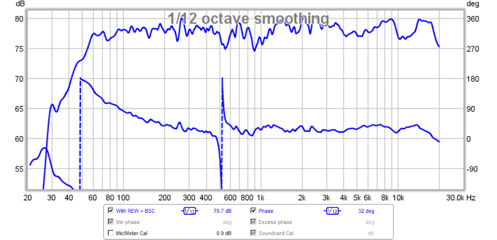

Here is the BSC+REW result in detail with the acoustic phase shown. The phase is linear and flat above 500 Hz which means it will really be nice for imaging and sound stage accuracy.

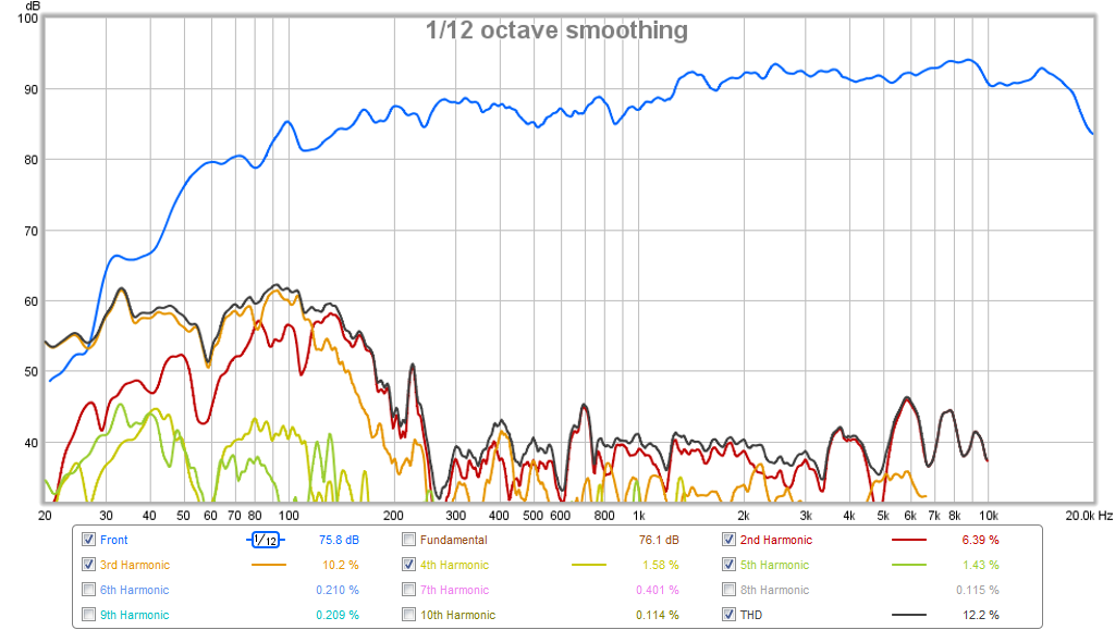

Here is the harmonic distortion which is great above 300 Hz but below starts to get a little ratty (especially that peak near 130 hz which is the fs of the driver) now that I have applied the REW. I wonder if I had just left those bass peaks alone if I would even hear them - it would keep distortion lower. I guess it si still pretty good considering I am asking the little 3.5 inch Vifa to pump out 50 Hz bass notes.
So how does it sound with the BSC and REW applied? In a word - Fantastic! I really like the clarity of the mids and highs and the presence of the adequate bass which sounds good for most listening at near field. Nearfield at desk is more like 0.5m away so the SPL levels needed are very low. This is good because with the BSC circuit applied the efficiency is like 75 dB 1 watt at 1 meter. Good thing I have 8 watts on tap and I am listening at 0.5m 😀
