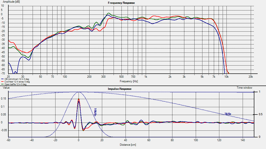

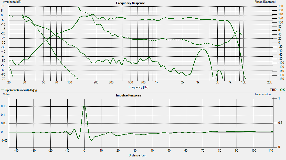

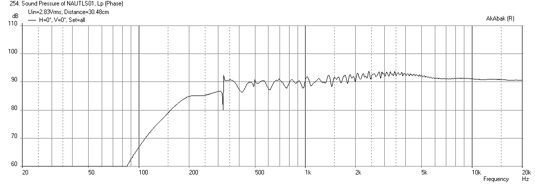

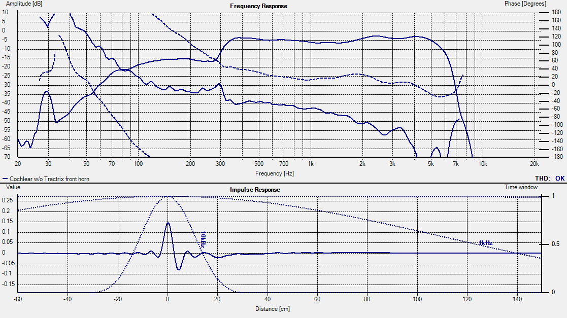

To confirm my suspicions that the speaker was indeed very even in character, I set out to measure it using a Panasonic WM61A mic capsule wired to my laptop soundcard. This works well below 5kHz but unfortunately cannot get anything above 6kHz due to what appears to be a low-pass filter built in to the mic input as it was designed for web chats.
The initial measurements really shocked me by how flat it was from 300 Hz on up. The measured THD was very low - I would say probably rivaling some of the very best full range drivers out there costing many times more. However, there was this pesky drop off in the response that made a cliff at 300 Hz. After scratching my head and looking at some sims in Akabak, this drop is a room-effect (distance to walls and floor).
Here are sims without room reflections:
Here is the sim including rear wall at 50 inches and floor at 45 inches high:
I then repeated the measurement with the same driver in an open baffle at the same location and also saw the same 300 Hz cliff, confirming that it is not the speaker enclosure (nor driver break-in) that caused this effect. The next step was to orient the speaker so that the room walls were 45 deg and I added a sheet of open cell foam and a pillow on the floor below.
The new measurements with the room effects, now mitigated, produced a very nice frequency response curve from 150 Hz on up (I will assume that above 6 kHz the speaker performs closely along the manufacturer's published data - which is actually very flat for a full range driver). Note that from 200 Hz on up the variation in SPL is only about +/ 2 dB and the THD is typically below -50dB with a wide loaf shaped bump at about 3kHz but still very respectable. The phase variation over this range is also very linear and relatively flat. I believe, all these things point to a speaker that will sound very coherent and accurate. Finally, looking at the impulse response function, we see that this speaker has an almost ideal response function that is very clean and short with minimal ringing. This might be described as tight, clean, or fast.
Given that this speaker appears to measure very closely to an OB, I would say that the spiral is doing its job of acting like an infinite cavity by absorbing all the back wave without any reflections.

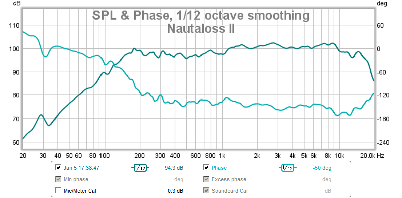

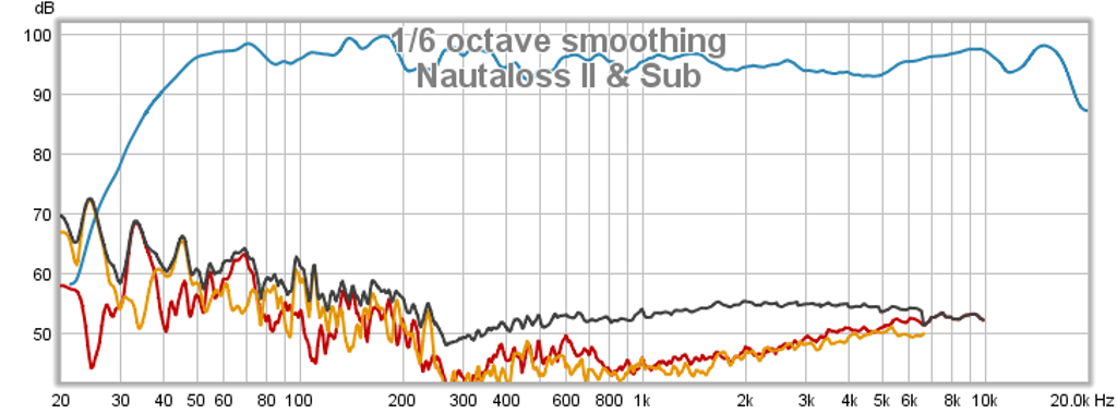

*** Edit (Jan 5, 2014) *** added measurements from dual driver Nautaloss II (including waterfall and spectrogram).
Nautaloss II Measurements are here: http://www.diyaudio.com/forums/full-range/247598-nautaloss-ref-monitor-11.html#post3766222
Here is the pdf plan for the Nautaloss II http://www.diyaudio.com/forums/full-range/247598-nautaloss-ref-monitor-19.html#post3788028
Freq Response is very flat from 200 hz to 18 kHz:

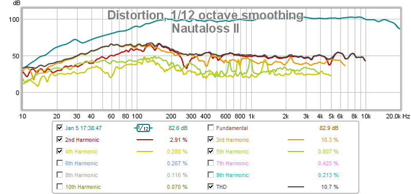

THD is -50dB!:

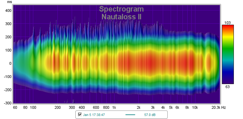

Spectral Decay:

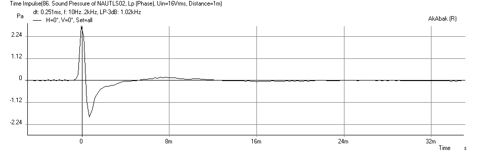

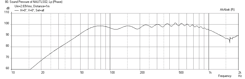

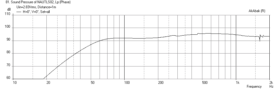

Bass Nautaloss with Beta 15A

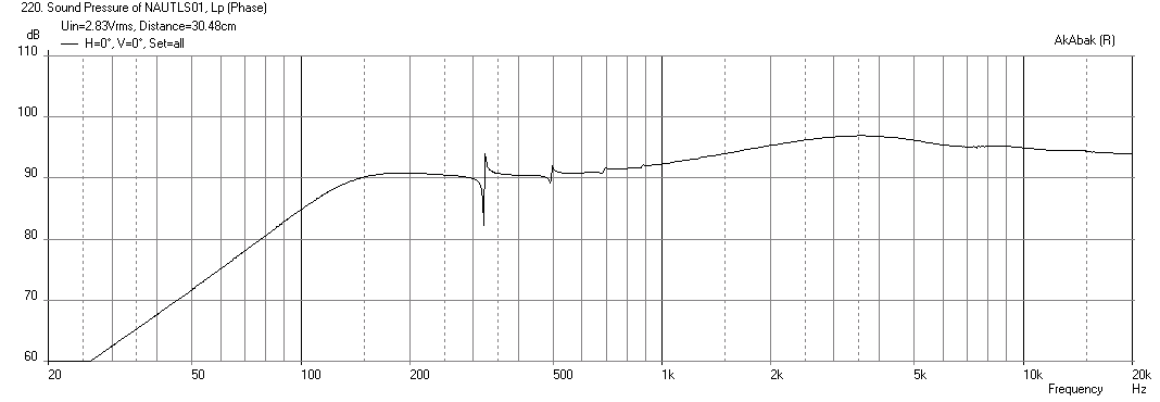

Here are the results with the Beta 15A driver. I am using a 56 in long path with a 16 in wide cabinet. I have not wrapped up the coil to see how big cabinet will be but I am guessing about 40 in tall x 30 in deep. If you mount the driver near the floor and aim the coil up, you get floor bass enhancement. I am including a 35 Hz 2nd order high pass filter, and a 1mH+4ohm resistor for BSC.
Here is the freq response with no reflections from walls or floor:
If you place speaker 60 in away from back wall and assume the driver centerline is 9 in above the floor, here is the frequency response - this may work well to cross-over with the top horn at about 1kHz:

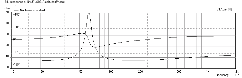

Impedance and Electrical Phase:

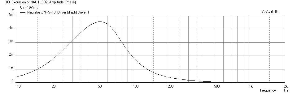

Max Cone Displacement is at 16 volts (good for 112 dB):
Impulse Response:

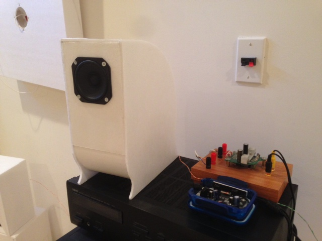

Sound Clips of Nautaloss in Stereo
I just finished the second unit and had a listen. The imaging, transparency, and sound stage are superb. The speakers disappear and you can visualize the phantom stereo image in your mind. Here are a couple of test tracks, there is some background noise from the nearby furnace which raises the noise floor a bit. Also, the room is square in shape and sparsely furnished so there may be some reverberations. I am running the speakers full range and also driving an old band-pass sub full range as I do not have the PLLXO built yet. I plan to get a better sub woofer in the future but this will have to do for now.
Let me know what you think of the sound.

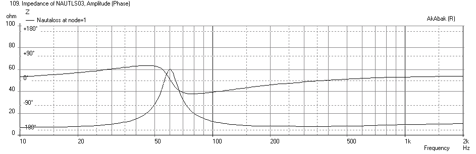

Here is the AE TD15M in the same exact enclosure as above. Optimizing lengths, taper, volume, etc did not help much.
That's not so bad on face value as the baffle will help, which that akabak script doesn't have on it currently? Its definitely an idea I think I'll have a play with, just to see if it helps reduce the noise level or time smear of a plain sealed box. Buying a woofer with such low THD like the acoustic elegance woofers, it makes sense to do every thing you can to maintain the system as clean as possible.

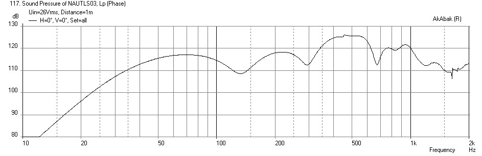

Bass Nautaloss with AE TD15M in a Corner
Gafhenderson,

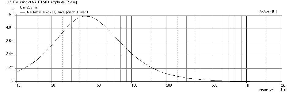

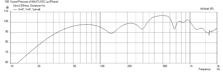

OK, I put in a 16 in wide x 36 in tall x 30 in deep box with the driver centered 9 in from the floor. The speaker is angled at 45 deg out of a corner with the walls 28 in away from the front baffle on either side. There is quite a bit of bass enhancement from the corner and floor but also a lot of wall/floor induced bounce cancellation. This helps bring the -3 dB point for bass extension down to about 36 Hz 🙂 with an average sensitivity of about 95dB at 2.83V (average value based on middle of dips caused by room reflection). The main attraction is the elimination of the back wave - which you can only see in the "no-reflection" case above.
SPL Freq Response at 2.83V:
Impedance:
Max Cone Displacement:
SPL at xmax (26V rms):
