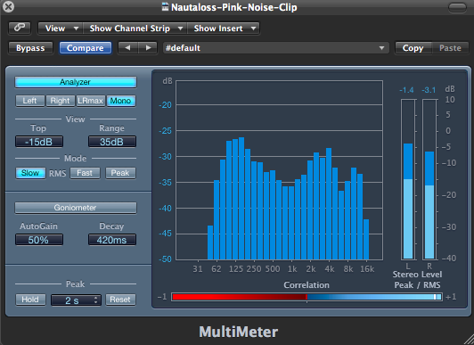

Quick pinknoise mono rms snapshop... (Untreated room. Zoom H4 (not to beat up on it, but bleh).
For reference, perfect reproduction of white/pink/brown noise sources should look something like the images here:
http://www.cim.mcgill.ca/~clark/nordmodularbook/nm_noise.html
I think room reflections are strongly impacting the FR (as would be expected).
fwiw, Zoom h4 recordings are a bit of a nightmare to work on in post... FR is not flat and phase is mucked up a bit.
h4 mk2 is probably sig better... I haven't had the (dis)pleasure of trying to work with anything off a zoom since the h4 model. cured of me of my interest in that company.
but I should clarify, the zoom is probably the smallest player in that uneven response.

So it looks like the Vifa does have at least response out to 16khz? I need a good ADC for measurements. Ideally, I should make measurements outdoors? I had the Zoom about 4 in away from the driver face, that may be mucking things up because the unit is big and is probably causing reflections and cancellations in the HF. My WM61a mic is mounted on the end of a slender 0.5 in dia x 12 in long aluminum tube.
Have to agree 4inches seems way too close for hf measurement.
So yeah, it looks like the vifa extends out past 14k and is down maybe 10dB (from the probable average) at 16k. That's pretty good (was your pink noise capture recorded directly to mp3 in the zoom?, mp3 format has a brickwall filter at 16k).

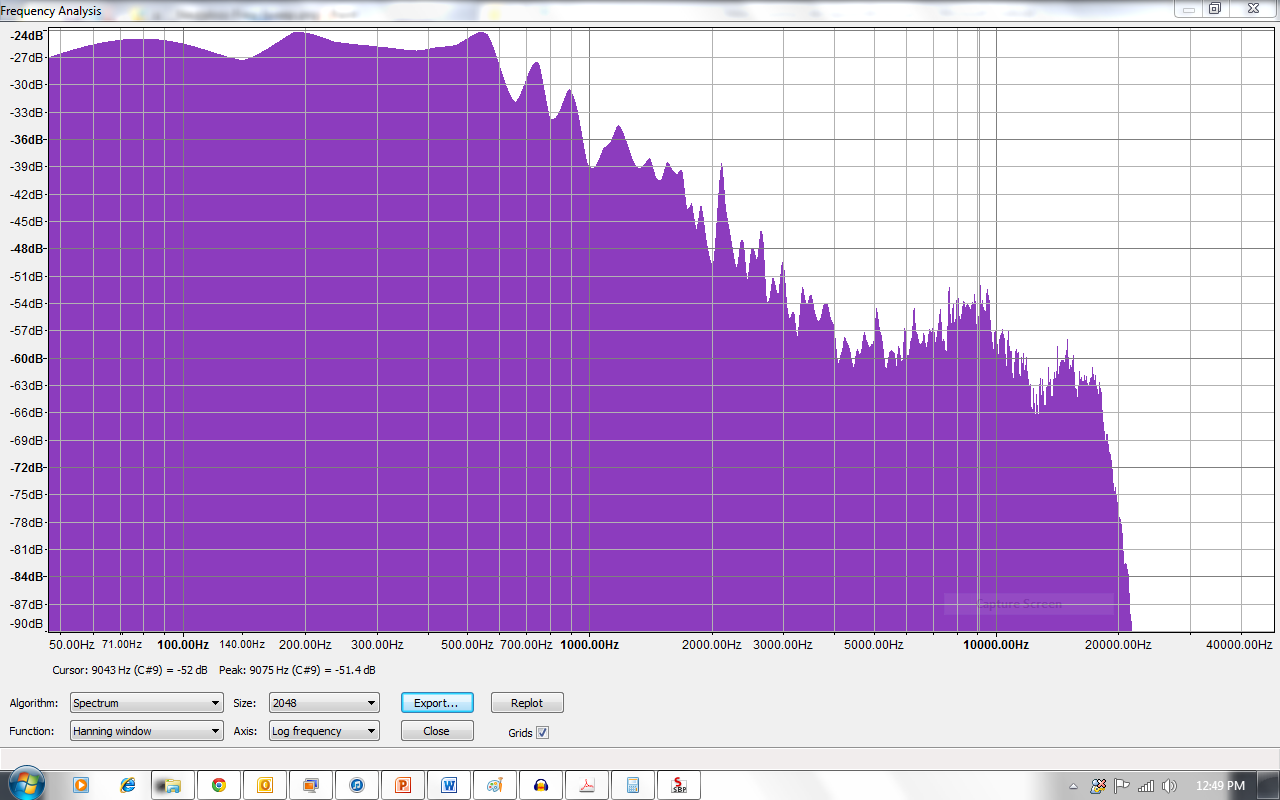

I had a setting in the Zoom H4 set to emulate a U87 mic and I turned that off to get a neutral response. A recording of of some jazz with a drum kit in 96khz 32 bit wav when analyzed on Audacity indicated that there is content all the way to 18kHz with the Vifa's. Here is the spectrum:
And attached is an mp3 compressed representation of that raw .wav file. I think it sounds pretty airy now - as the type of music that has highs is required if you want to hear high.

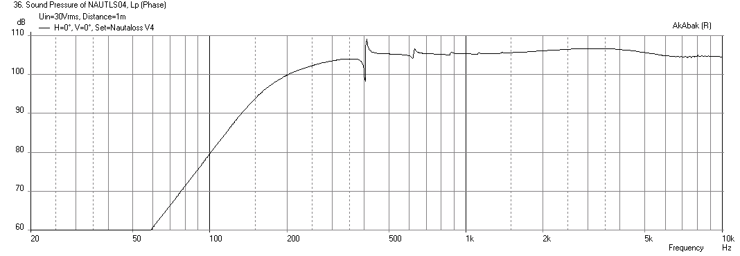

More efficient dual Vifa option
For those of you looking for a 91 dB sensitivity at 2.83V (4 ohms) and wanting higher SPL, use a 2nd order high pass filter at 300 Hz, stack dual drivers one on top of the other and *reduce* the spiral pathlength by 7 inches and here is what you can get - about 105dB max SPL.
SPL at xmax of 2.5mm with 30 volts rms:

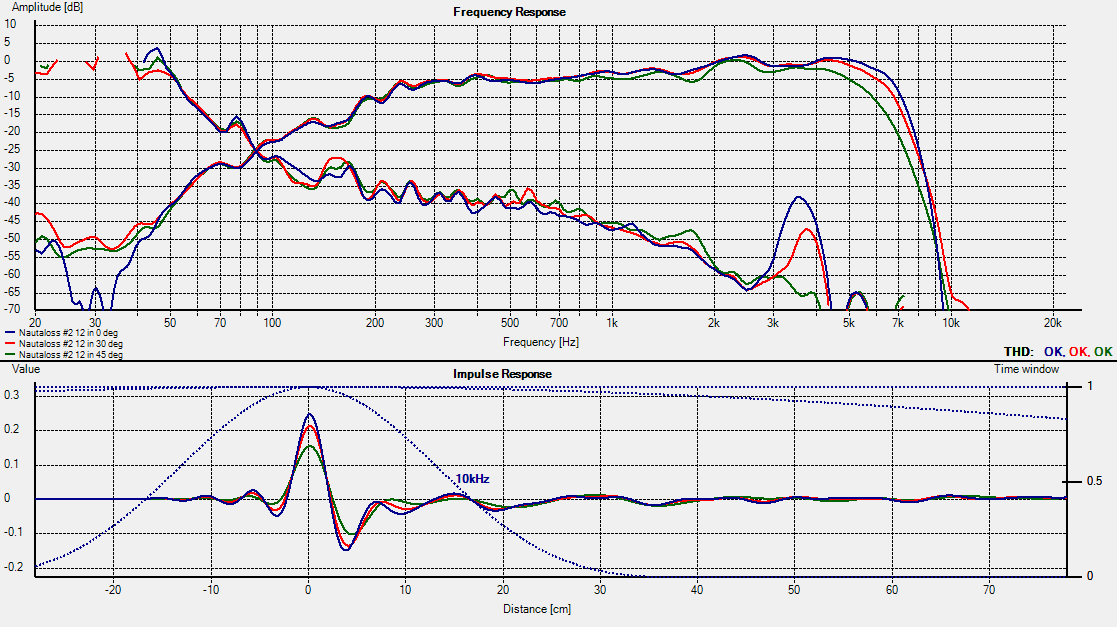

Measurements of Unit 2
Here are some measurements of the second unit. Room placement was not exactly the same as the first measurement so there are some differences in the region below 300 Hz. There appears to be a mild rise in the frequency response - not sure what is causing this but could just be baffle step loss or the fact that this driver did not get benefit of a 24 hr break-in playing into a sealed box like the first unit. Shown are measurements at 0 deg (blue), 30 deg (red), and 45 deg (green) off axis, all at 12 in away. The THD hump near 3kHz goes away at 45 deg off axis which seems to indicated that this is a cone-breakup induced distortion? Still not to bad for THD, but a little higher than unit 1 by 5 to 10 dB. Again, this is with the laptop sound card that has no response above 6kHz.

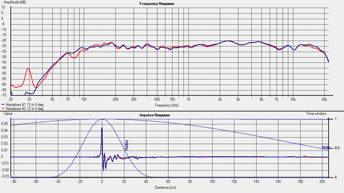

New Measurements w/ UMM-6 Mic
I finally got a real microphone (Dayton UMM-6 USB mic) that captures the HF. Here are the measurements for both speakers at 12 in away and 0 deg. The response truly extends into 20 kHz.
I think that this is a pretty flat response over the range of 100 Hz to 20 kHz.
