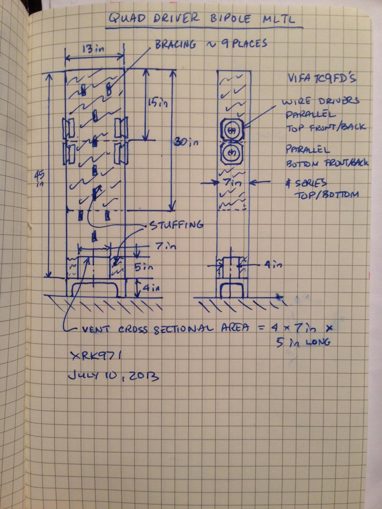

If you are interested in a 4 driver bipole with the Vifa, it can be done but the cabinet is bigger. http://www.diyaudio.com/forums/full-range/231951-accidental-mltl-technique-21.html#post3554621 This has not been built yet, but it should work.

I have probably confused this thread a bit - so I'll clarify it a bit.
1. I will be making speakers and giving them as gifts to my sons, almost certainly one driver per enclosure. And, most likely, one of the first designs in this thread.
2. Parts Express has these at a reduced price, so I am thinking of playing with e few other designs for my house.
So, simple and proven for Tim and Scott, and maybe a little more daring for me.
Again, thank you - this (like Tech Talk) is a very generous and well intended community.
