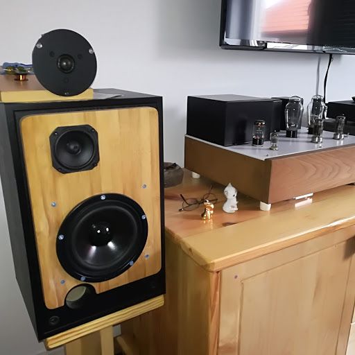

I recently got the Dynaudio D21 / 2 supertweeters in very good condition.
These days I tried them in my FAST (TC9FD + W170S-8) based on this thread:
Adding a super tweeter to a full range
D21/2 is crossed at around 19 kHz (1uF/0,06 mH) and L-pad is slightly modified (3 ohms in series and 12 ohms in parallel) for about 4 dB attenuation.
Sound is very nice, I'm very pleased.
I expect the carpenter to make additional boxes for supertweeters

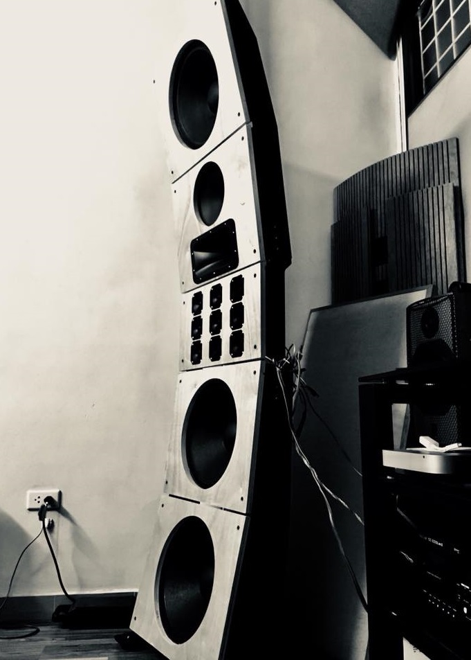

My planning is OB project
9 x Vifa TC9FD in 3 line
2 x Alpha 15A
This should be interesting evikins - with 9 x TC9FD drivers? Will be a huge speaker I guess.
I also want to venture into OB territory and have found the perfect project to start with, using the TC9FD's - the Manzanita project. If anyone is interested in OB with these drivers, check this out:
Fast, fun, Inexpensive OB project
Yeah .. A small OB
