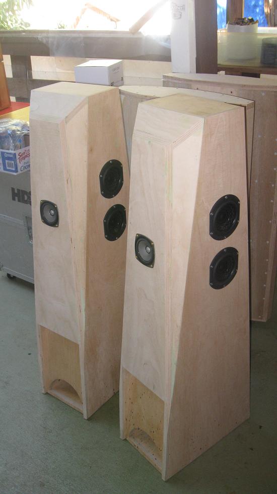

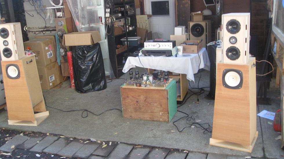

I am really enjoying my planet10 treated FF85wk pair, that are still being run in. Been about 5 days, playing most of the time. They are mounted in 15 liter cabs, with a 2"x .75" (preexisting) cutout as the port. They seem to be making more bass, and also doing a good job of suggesting the bass that probably isn't really there. Maybe because of how they reproduce the harmonics? In a way I hate to roll them off into a woofer, because of the "integrity" they seem to possess alone. But I also know that I will dig really hearing the low notes.
  Reply With Quote
Old 17th September 2013, 03:55 AM   #2
howardg is offline howardg  United States
diyAudio Member
Join Date: Mar 2007
Default DREAMING AGAIN
The FF85wk has a QTS that is about right for a TL, no?
Cool project to use TL's to extend the little FF85's and use a TL sub to fill in below 100hz. Maybe use a 2.1 plate amp(with active x-over) and a tube preamp.

Quote:
Your itty bitty driver will work very well in a BIB (Bigger is Better), a design from the late Terry Cain. It is a very forgiving design, with a lower than Fs useful output.
It does not do magic but it delivers

Join Date: Mar 2005
Location: UK
The FF85wk does not do bass. You can force it to produce some. You can force a lot of tiny drivers to produce some. You will pay, as Dave says, a very heavy price for it in rocketing harmonic distortion. Just because it's possible to get LF from a tiny driver with a high Fo & miniscule linear travel does not make it a good idea. If you were planning on crossing to a driver designed to produce LF, do so. You'll get far better results.
