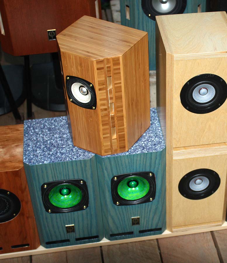

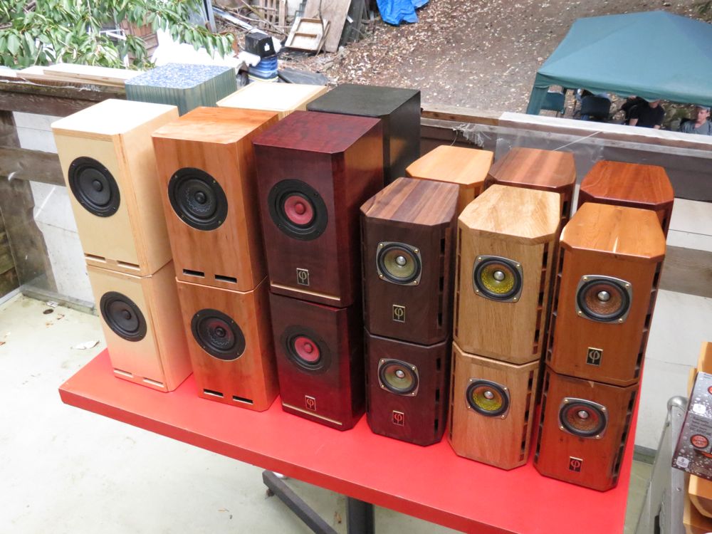

Howard, you may remember seeing/hearing the faceted enclosures at Dave's place in August. This was 85WK in a tapered MLTL(?), passive LLXO at 240Hz, to 2 opposing pairs per enclosure of Peerless 830870 midbass. I've been test driving those over the past few weekends, and it's quite amazing how much LF energy 4 of those little Peerless per side can deliver - within sane limits - at least enough in my room to rattle some of the loose ornaments. No doubt a much simpler configuration would work quite well for the bottom.

... the faceted enclosures at Dave's place in August. This was 85WK in a tapered MLTL(?), passive LLXO at 240Hz, to 2 opposing pairs per enclosure of Peerless 830870 midbass.
FF85wKeN in an over-large, "dynamically-shaped" aperiodic TL, and the Peerless in an ML-Voigt.

Ya those boxes are really sexy. I thought they were oak but was unsure. They feel very solid too
What model were they?
Any pictures?
