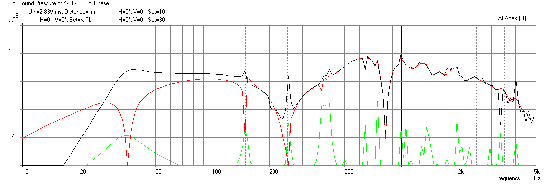

Karlsonator with FF225K
Here is a sim of the Karlsonator scaled in width by 0.7X (length is 1.0X), with the vent scaled by additional 1.5X. The FF225K is an interesting driver with one of the lowest Qts I have seen. It does reasonably well but needs about 5 ohms + 1.4 mH coil as a BSC to reduce the HF to match the bass as this cabinet was only making about 95 dB in the bass department.
First plot is frequency response, second is impedance, third is cone excursion, fourth is impulse response. The cone excursion is already exceeded at 1 watt - so not sure if this works for you. Assumes speaker is 4 in from back wall.
Driver parameters from here: http://www.diyparadiso.com/datasheets/speaker/fostex/ff225k.pdf
Karlsonator-1p0-Length-0p7-Width-1p5-Vent-FF225K-Freq-1m.png24.6 KB · Views: 353
Karlsonator-1p0-Length-0p7-Width-1p5-Vent-FF225K-Impedance.png21 KB · Views: 306
Karlsonator-1p0-Length-0p7-Width-1p5-Vent-FF225K-Displ.png21.6 KB · Views: 296
Karlsonator-1p0-Length-0p7-Width-1p5-Vent-FF225K-Impulse.png12.7 KB · Views: 302
Blimey, thanks chaps.
I had no issues with excursion with the previous FF225Ks in the Jericho horns with a 50w amp, now I have the ~2wpc Decware Zen I cant imagine that will be an issue, most if not all of my listening is low-medium levels.
I will have a look into the Karlson type enclosures, thanks xrk971 for the sim!
My gut feeling is that a BiB may be the easiest way forward.
