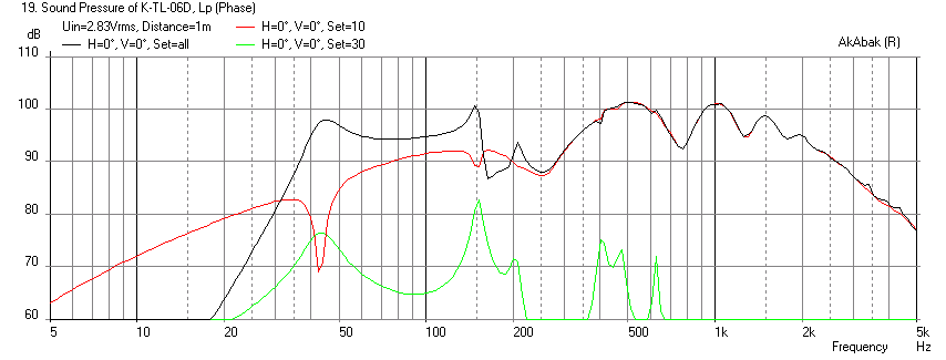

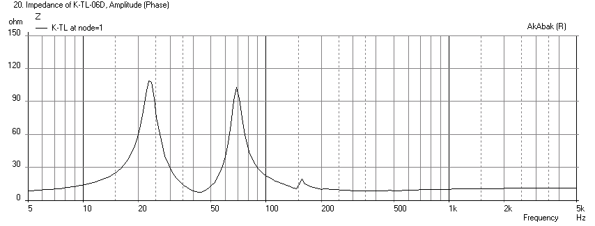

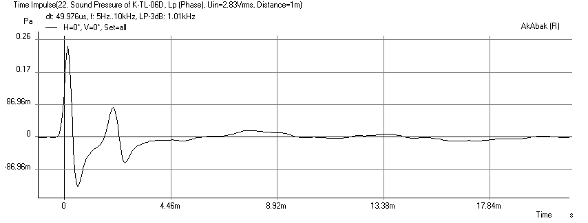

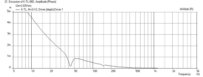

Karlsonator with FF225K
Here is a sim of the Karlsonator scaled in width by 0.7X (length is 1.0X), with the vent scaled by additional 1.5X. The FF225K is an interesting driver with one of the lowest Qts I have seen. It does reasonably well but needs about 5 ohms + 1.4 mH coil as a BSC to reduce the HF to match the bass as this cabinet was only making about 95 dB in the bass department.
First plot is frequency response, second is impedance, third is cone excursion, fourth is impulse response. The cone excursion is already exceeded at 1 watt - so not sure if this works for you. Assumes speaker is 4 in from back wall.
Driver parameters from here: http://www.diyparadiso.com/datasheets/speaker/fostex/ff225k.pdf
