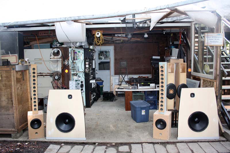

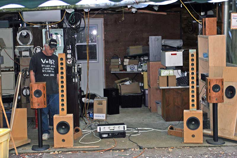

flat array of 32 x 2" drivers.
Parts Express: Project Showcase
There are some flat arrays using a driver's rising response to combat losing high end. The audience lsa4.
Audiogon Shows: RMAF 2007
here was a driver they used.
http://www.parts-express.com/pdf/296-220s.pdf
+5db 2.5khz-7khz, a peak, then a bit more above that.
More drivers and you'd lose more highend.
I am one who carries the focused array torch, but it has more drawbacks than most would tolerate.
