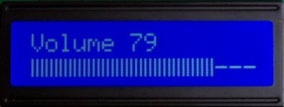

Here's what the LCD displays when the user adjusts the volume. After a short while, the display returns to the main screen (first picture on top).

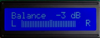

Balance, a bit moved to the left here.

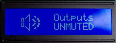

When the user unmutes, the LCD displays the screen below for 2 seconds then returns to the main screen (1st pic on top).

Looks good, for adjusting for example volume do I hold the button in
and release when satisfied or do I have to push ones for every 0,5db ?
Both are available.
Short button press allows you adjusting the volume step-wise.
Holding the button lets you adjust volume in a continuous fashion until button release.
The same applies to the remote controller volume buttons.
