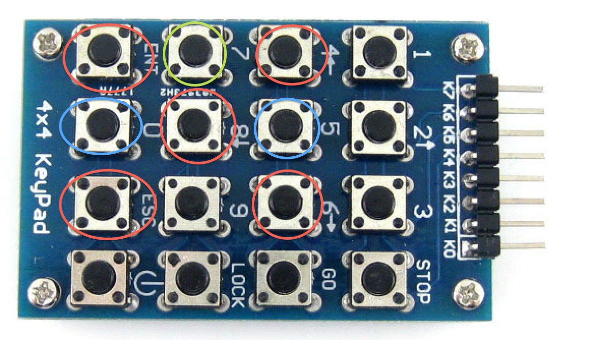

No that's not ideal, there are too many buttons and I can't see how they're wired to 8 output pins.
I recommend placing 5 buttons in a cross-pattern (left/right/up/down/center) for navigating easily through the menu. A 6th button (SET) should lie somewhere near the cross, because it's by pressing this button that you confirm a change made in the menu.
The 2 remaining buttons (StandBy, Mute) can be placed elsewhere, up to you.
Would it be possible to use just some of the buttons like in the picture?
ChaparK said he couldn't see how the buttons are wired to the output pins - I don't see what's changed there
The listing says the buttons are wired as a matrix. Unless chapark's design is expecting to see the same matrix then the connector on the button board won't work.
You may be able to wire directly to the back of some of the buttons and use it that way
Why not wait until the design, schematic and documentation are released and then work out what buttons may or may not work with it
I confirm you cannot use that keypad. You'll need 8 independent push-buttons.

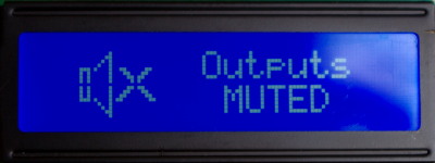

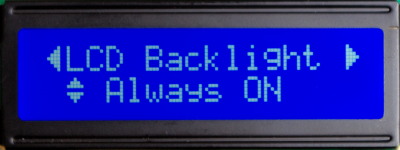

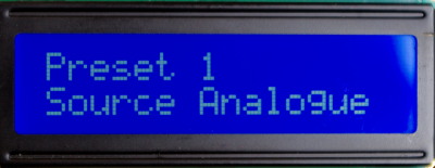

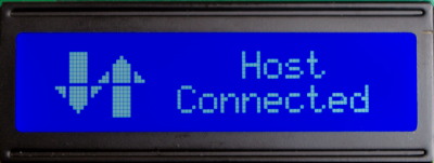

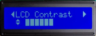

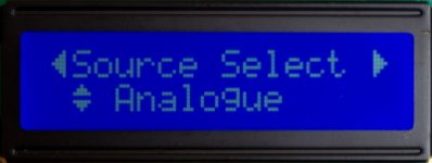

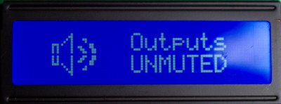

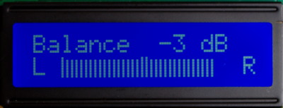

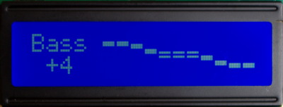

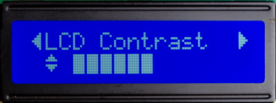

As some guys here are already looking at the design of their unit, I'm posting a few snapshots of the LCD display to give an idea of what's available here.
I'm using a standard size 2x16 display with blue background and white characters. Remember that many sizes / background colors / character colors combinations are available in shops (or ebay).
So this one below is the main screen, displaying on top the preset (preset name is customizable by user, could be My Preset for example), and on bottom the active source.
Here's a page from the menu, this one is for selecting the source. Note the arrows for reminding the user on how to use pushbuttons in order to navigate.
Another page from the menu showing LCD backlight management.
Yet another page from the menu for LCD contrast adjustment. I stop here with the menu, I suppose you got the idea.

This is the bass adjustment page. You can see that there's a bit of bass added and treble is lowered a bit.
Balance, a bit moved to the left here.
When outputs are muted, the LCD permanently displays this page so you don't wonder why the hell there's no sound. Note however you still can navigate in the menu.
When the user unmutes, the LCD displays the screen below for 2 seconds then returns to the main screen (1st pic on top).
Finally, when the PC application is controlling the board, the keypad/IR sensor are disabled and the LCD shows the screen below.
