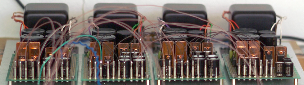

Default ... mine is bigger than yours ...
Quote:
Originally posted by Hurtig
In total we have 14 regulators on-board!
Please count the heatsinks
14 shunt regulated rails for the DAC share the voltage reference and the driver rails that are provided by the additional two shunt regulators.
Those two shunt regulators together with the voltage reference form a secret system wherein the regulators provide the clean rails for the reference IC and its own driver stages, while the reference IC provides the stable reference voltages for its own shunt regulated supply.
Excuse the messy wiring, it is still a (working) test setup.
