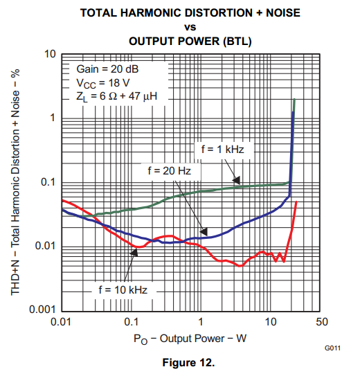

Here is the 3110 plot of THD for 18 volts drive into 8 ohms. Usually lower impedance speakers equals lower distortion. Even with 18 volts supply and 8 ohms speakers, the THD is low when operating below 20 watts. The Sure TPA3110D2 board really should be called a 20 watt class amp rather than 8 watts (probably assuming a 12 volt supply).

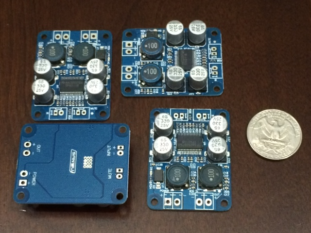

Sanwu Blue PBTL postage stamp amp
This thread has been dormant for sometime but a recent version of the TPA3118D2 in 60w PBTL has been developed in a miniature format 36mm X 45mm - the size of a postage stamp. Board layout is extremely tight and good. Components are of high quality and construction is top notch. Prices range from $7 to $9 shipping included. The "Sanwu Blue PBTL" is an excellent amp. I have tested it and it is one of the better Class D amps I have even in stock form. We all know the 3118D2 holds the key for excellent sound as evidenced by the Gmarsh Wiener and the SMSL 36A Pro. Now it has just gotten tiny and cheap but still excellent sounding.
Possible sources for this amp include:
http://m.aliexpress.com/item/32553840789.html
http://m.ebay.com/itm/221995275152
More info starts here in the 3116 thread but I would like to bring the discussions back to the 3118 thread proper.
http://www.diyaudio.com/forums/class-d/237086-tpa3116d2-amp-867.html#post4583670

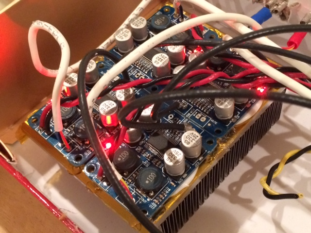

Mounted with silicone RTV to a cpu heat sink:

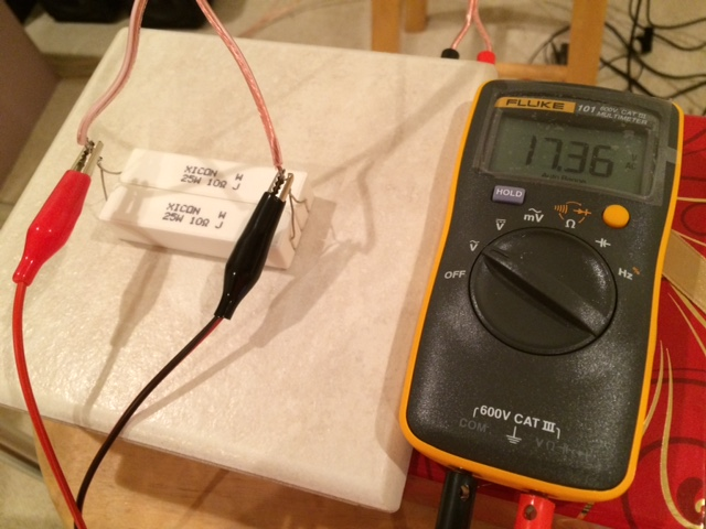

Stress test with dummy 5ohm load shows it's a bonafide 60w amp, 5 minutes smoked the resistor but amp was only very warm to touch if mounted on heatsink:
My tests show that it is in Master mode with 400kHz carrier frequency.
Sound is powerful, dynamic, clear and transparent.
Gain appears to be set at a rather high 36dB.
Almost silent turn on "click" not thump. No turn off thump.
Excellent amp and excellent value. Extremely easy to install and use with solder thru wire holes that can be populated with terminal blocks if you desire.

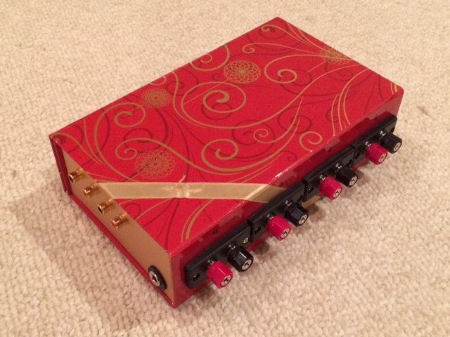

Here is the completed 4 channel amp capable of 240watts total output cardboard Xmas chocolate box. My "Xmas Amp".
