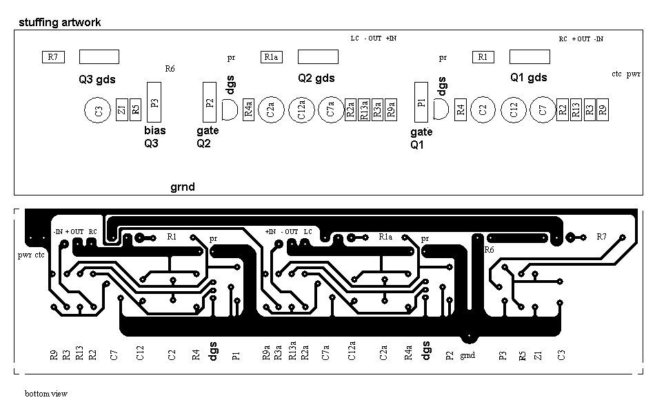

One other thought, I guess R3 is used for biasing the output transistors and not necessary for feedback.
You also have a full loop Feedback to the gate of the input so a local FB to the output seems redundant.
If this is the case I would try biasing the output directly from the rail. Also R3 seems very low in value. Most of the feedback is going to the power FET and very little to the input.

Wow, thanks for the input!
I hadn't thought of relocating R3 to the + rail. But you're right, feedback is already being applied to the input. I'll have to try this out. 10K is what Nelson used for R3, so I kept the value.

Coming back to Nelson's comment I think he suggested a resistor at the output of the buffer, before C6, have you tested this?
On the R3 comment, I think if you are not looking for FB it should be in the order of 100 or 200K but you will also need to change the pot to a higher value to compensate and be able to set the bias you need. This change will also affect the gain of the amplifier.
May be, if you decide to test a higher value for R3 you would also like to lower the FB resistor to the input.

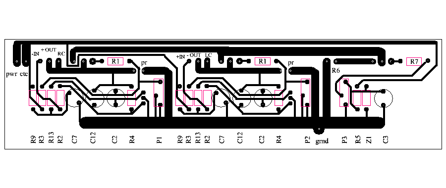

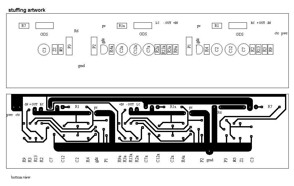

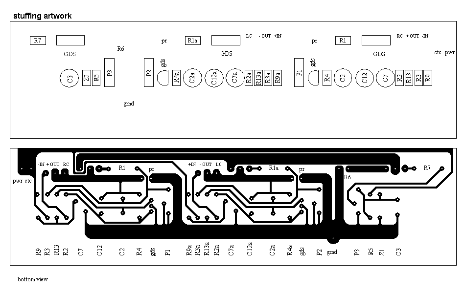

Hi all,
Looks like a one-man rant here. Ha.
I reconfigured the pcb artwork through Express PCBs software and now I'm in the process of ordering pcbs.
A pair of double-sided, plated through holes, but NO solder-mask or silk-screen will cost me $107.00 for the first pair. I figure that diy-ing a pair will cost at least that much in time and materials -- not to mention that I'm anxious to see if this works. Turn around time is short; I believe it's three or four days, and that including the shipping.
If anyone feels inclined to bite-the-bullet with me, they can save me some cash -- at least I'm being honest, huh...
The break-down:
2 boards @ 107.00
4 boards @ 138.00
6 boards @ 169.25
8 boards @ 202.70
10 boards @ 233.00
... and it just gets better and better.
Anyway, just thought I'd offer. You should check my work first -- wouldn't want anyone sending me hate mail, taking a leak on my poor ol' dad's grave, etc...
John
