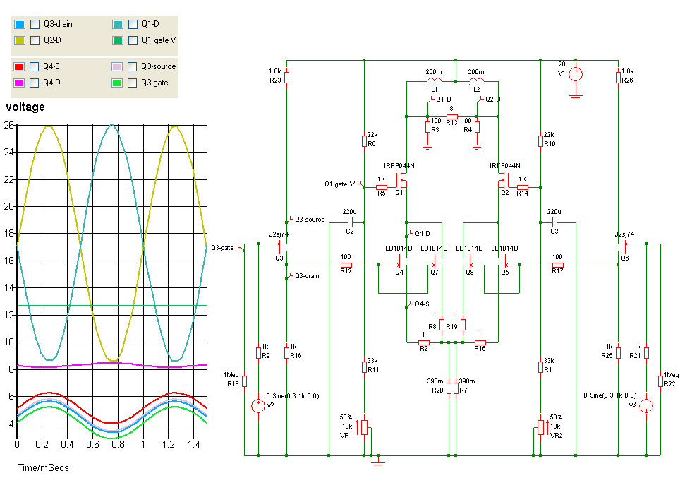

I laid out a version the uses the 2SJ74 jfet at the input. I also paid close attention to aligning current to voltage on the LU1014D ID/VDS graph. Just for the fun of it, I also did the same for the IRFP044N mosfet. It's current is rated at roughly 6 amps to 10 volts (V/D) with a VGS of slightly under 4.5V.
If anyone sees an ugly here or there, please feel free to let me know.
BTW, it takes two LU1014D jfets to deliver enough current to hit the IRFP044N sweet-spot.
I'm not entirely up on the use of the 2SJ74, and can't seem to understand how to graph its parameters. Any help in that dept. would be appreciated. As designed, each 2SJ74 delivers 4.5mA to each LU1014D.

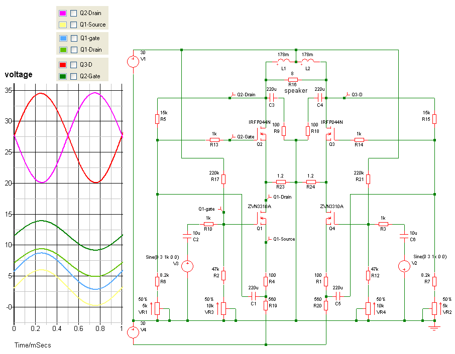

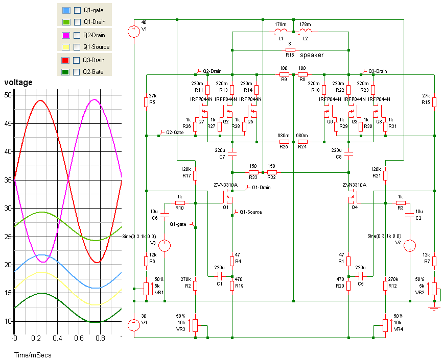

I'm probably over-doing it with the design bit, but this software is a blast to use.
Here's another idea--you know how a little girl can wrap her dad around her little finger? That concept reminds me of what I'm doing with this design. I affectionately think of it as my version of "Daughter of Zen".
I'm proposing the use of a ZVN3310/IRFP044N cascode arrangement. I may be nuts, but the sim says it will work. It's just strange enough that I'll build this one.
Imagine an itty-bitty ZVN3310 controlling the big brute IRFP044N above. I bias up the IRFP044N separate from the ZVN3310. I don't know if this can be done in reality, but it could sound pretty sweet should it work.
Here's the concept schematic (more fine tuning to come, and yes, I realize that the IRFP044Ns are going to fry at the proposed settings) Water cooling anybody?:
