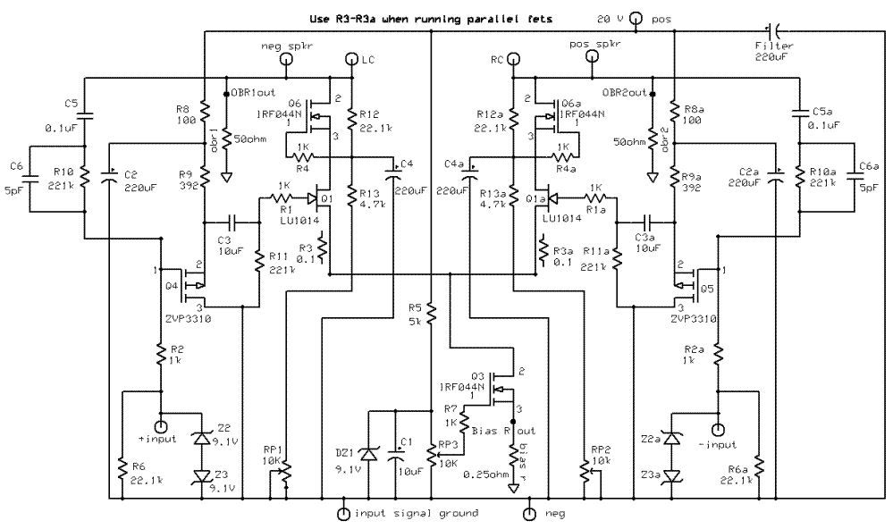

Well, they're at least 10 watts when you up the bias current--I'm still at 20 volts, but these seem perfect for my paper mache HF horns. These pups have plenty of power to drive my 2446 JBL's.
Soon I will attempt to catch up with Magura and run 45 volts. These will go towards my JBL 2123 10" midbass cabinets.
The sound quality is much smoother with the CCS passing four amps vs. two. There's two jfets to feed, and they both want two amps. Make certain that the source resistor is 0.25 ohms.
What I notice most is the lush vocals--the mids are very full sounding. And talk about smooth! Wow.

I've made the necessary modifications to my pcb artwork and have submitted it to Express PCB for three more of their little 2.5" x 3.8" boards. I adjusted the pcb for future applications by placing traces for mosfet cascode operation in addition to the jfet.
If they operate without flaws, I'd be willing to order more for those who want them.
One pcb from my last purchase of three was immediately converted to the cascode version of the ZV7-TB, so it never saw it's original application. Now, I have two pcbs for the ZV7-TB that will probably never get used. How can one go back to standard operational procedure once they've tasted what a cascode can do?

Hey winslow, when I get my pcbs (next Thursday), I'll stuff one up and light it. If all goes well, I'll let you know. I'll be ordering more and throw a couple on the order for you. Mind you, these pcbs are NOT solder-masked or silk-screened. Still, it's not too tough to follow the artwork and stuff them correctly.

Oh, and by the way, I don't use the feedback loop for the high frequency amplifier. It's only there for the midbass, where I may require dampening factor. It's also easier to design a feature into a circuit board and not put it to use, than to require it and be without.
I'm in the process of fabricating the chassis for my new ZV7 and only get about 15 min. listening on the original small-horn-amp heatsinks. But, every time I listen. Wow. I really can't remember ever hearing anything this beautiful sounding. The more I listen, the more I realize that the original ZV7-T I've been working on for the last year is history, it's in the archives, baby! Long live the new ZV7-TJBC.

http://www.onsemi.com/pub/Collateral/NTY100N10-D.PDF
These are similar. I played a bit with these a while ago. Had to face the fact that the package does not make heatsinking easy. The ratings of these devices is HIGHLY optimistic. Compared to a TO-247 device like the IRFP240 you just get a whopping input capacitance and not a whole lot more.
Magura
Magura
I had hoped to use them in a bass ZV7-TBC amplifier. They're rated for 500 volts! Wow....... Even if I derate them, it looks like they'll handle plenty of wattage. As far a mounting goes, they look like the big, big weight-lifting brother of the IRFP240.
I can't see any problems screwing them down to a heatsink. Is there something I'm missing?

To make a TO-264 handle 415W you need to run it submerged in liquid nitrogene or the like
Your main limitation is how to get the heat from the device to the heatsink. IRFP240 will handle like 70W reasonably reliably running at like 60C. Now if you do the math and multiply the max load handling with the same factor as the footprint is bigger....you will end up not too far from the IRFP240
