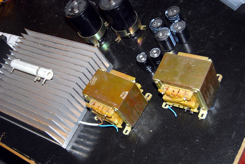

I found a pair of EI core 33Vrms mains transformers, (no load voltage, attachment 3), each weighing in at 3.5kg (7.7 pounds). The power resistor on the heatsink is 120mm long for scale. Reflected copper loss resistance on the single secondary is 0.36 ohm, resulting in a simulated load voltage of about 40-41V at 1.3A load current. This includes losses in a simple CRC filter, consisting of 2x 10'000 uF + 0.28 ohm, plus losses in an inexpensive Si diode bridge. I expect to drop the zener reference to limit the voltage loss across the cap multiplier in the ZV4.
Q: Are there any obvious problems associated with feeding the cap multiplier in the ZV4 with about 40V? This is a bit lower than the original.

3x MOSFETs: 41V*1.3A = 53.3W.
Diode bridge: PF calculated to be rather exactly 3.0 in this case, with the first reservoir cap being 10'000uF. This gives a rough power loss in the diode bridge of 2*1V * 1.3A * 3 (PF) = 7.8W.
Mains transformer: VA load is roughly 33V * 1.3A * 3.0 (PF) = 129 VA. This should not cause problems for transformers of this size.
Loss for a transformer of this size is guesstimated to be about 7%. So power loss is (129/(1-0.07) - 129) = 9.7W.
Total heat load per channel is 71W, 142W for stereo.
The heatsink in the photo appear to be a Fischer SK102 profile, except this one is obviously raw Aluminium and not anodized black. It is 240mm long, 215mm wide and 83mm high (height of fins and 15mm thickness of the baseplate). If it is cut in two 120mm high sections, and each section was used as the side in a rack drawer, then each half would have a thermal resistance of 0.35-0.40 K/W (from Fischer catalog graph). This yields a temperature increase of about 28 degrees C, a bit too hot for comfort considering not all components within the chassis will be directly attached to the heatsinks. The lack of the black anodizing will further increase the thermal resistance above the published values.
So I am considering using the heatsink in a DIY cooling tunnel instead by combining the Alu profile with a pair of quiet, low speed fans. This should be more than plenty cooling even at very low air speed, and will also directly benefit the transformers by continuously replacing the air inside the cabinet.
What about heat distribution within each amp? If I go with passive cooling, then there shouldn't be a problem. I just attach the three MOSFETs and the diode bridge for each channel in a horizontal line across the heatsink on each side, a bit below the center line.
Hoever if I go for the cooling tunnel, then the amps will either run at different temperatures due to different distance to the fan end of the profile, the heatsink would need to be cut lengthwise (parallel to the fins) -and/or- the MOSFETS for each channel would not be operated at the same temperature. My thought is that the CCS might protect the amps from thermal runaway, and the per-device dissipation isn't that high anyway at about 20W.
Am I likely to run into hum problems with the magnetic fields from the EI core transformers, if I attempt to cram everything inside a single chassis?
Peak transformer currents are about 8A. I intend to use dual/dual, IE. separate PSU and main amp, star grounding, and true dual mono construction for the two channels, with anti-parallel diodes as ground loop breakers and inter-channel isolation.
Anything else I want to know about this amp? Over the last few days I have tried to read up on everything written about Pass amps, but am not quite there yet… Would be nice to know whether I want to keep an eye out for the missing parts, even though construction wouldn't start for quite some time yet.

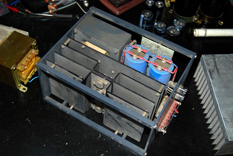

However I have to admit I sometimes wonder where I have my head. I just realized my stash contains a twin pair of industrial grade (if slightly dusty) 24V@10A linear, regulated power supplies. Looks like they date from around 1980, from back when they still made commercial, linear PSUs. They have floating DC grounds apart from chassis, so they can be configured as either +/-24V, or just plain +48V. Appear to be intended to be used with some form of external forced air cooling. The catch with using them would be running both channels from one set of power rails. Hmm?
Think the next step in this project would be to give those fellows a solid rebuild of some sort. Anyone taking bets on 30 year old 2N3055s and Sprague smoothing caps?
