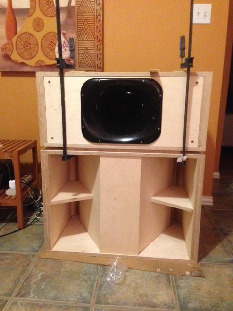

I got one of these monsters set up in room yesterday with the assistance of fellow audio lunatic and serial naysayer, kenpeter . Crossover is via minidsp . I didn't have the patience to set up my tube amp for the tweaking phase of this project so I employed a (very solid) solid state amp,.. the old mcintosh mc2100, as a test amp.

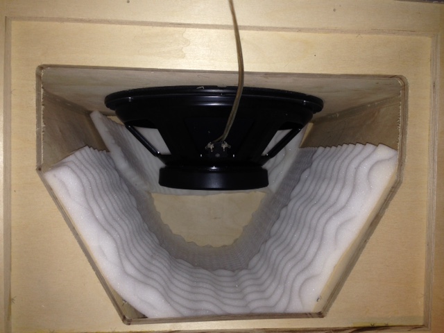

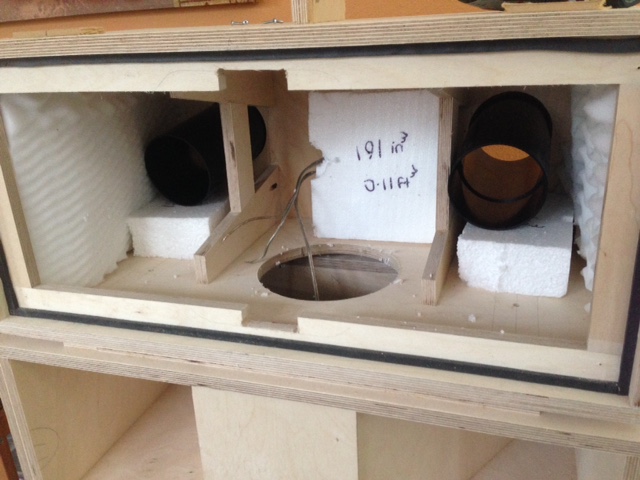

In the last pic, I tweaked the internal volume using styrofoam scraps (about 0.7 cuft of it altogether)

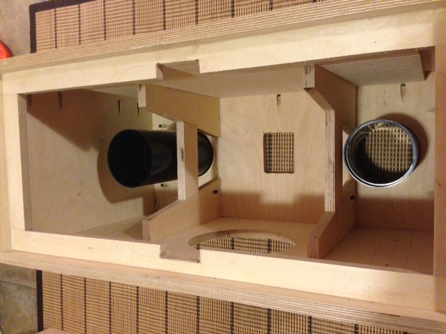

For my build,
I estimate the net volume of the bass horn rear chamber (after subtracting driver volume) is 3948 in3
Likewise, the net volume of the top cabinet (after subtracting the volume for 2 ports and the waveguide) is about 5031 in3
Therefore the total volume when combined = 3948 + 5031 = 8979 in3 = 147 l = 5.2 cu ft

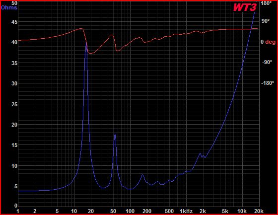

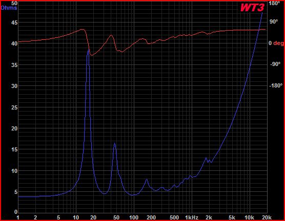

Here is an impedance sweep with this volume and the (2 x 4.5" DIA) ports extended to 9"

For my build,
And here is another WT3 impedance sweep with the rear chamber reduced by about 0.7 cuft (using styrofoam scrap) and the ports reduced to their minimum length (7.5"). Not that the tuning point (the minima of the curve) has increased in frequency somewhat.
I didn't have any more properly sized pieces or else I would have tried to reduce the volume even more. I'm considering using foam insulation board in my next experiment to reduce volume.

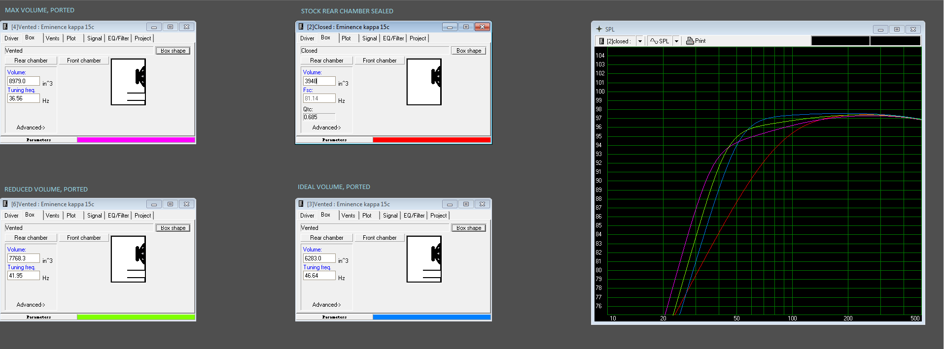

A summary of DJK's tuning instructions:
1. Identify the sealed volume for a Bessel max-flat alignment (Q = 0.577). In my case, that works out to about 6283 in3 .
2. Port this volume to an S4 . I coudn't find enough junk to reduce the volume to 6283 in3 so I ran two tests (one with the original volume of 8979 in3 ported, and another with 7768 in3 ported) .
3. Add a peaking high pass filter just below the porting frequency
4. Boost the bass at the porting frequency

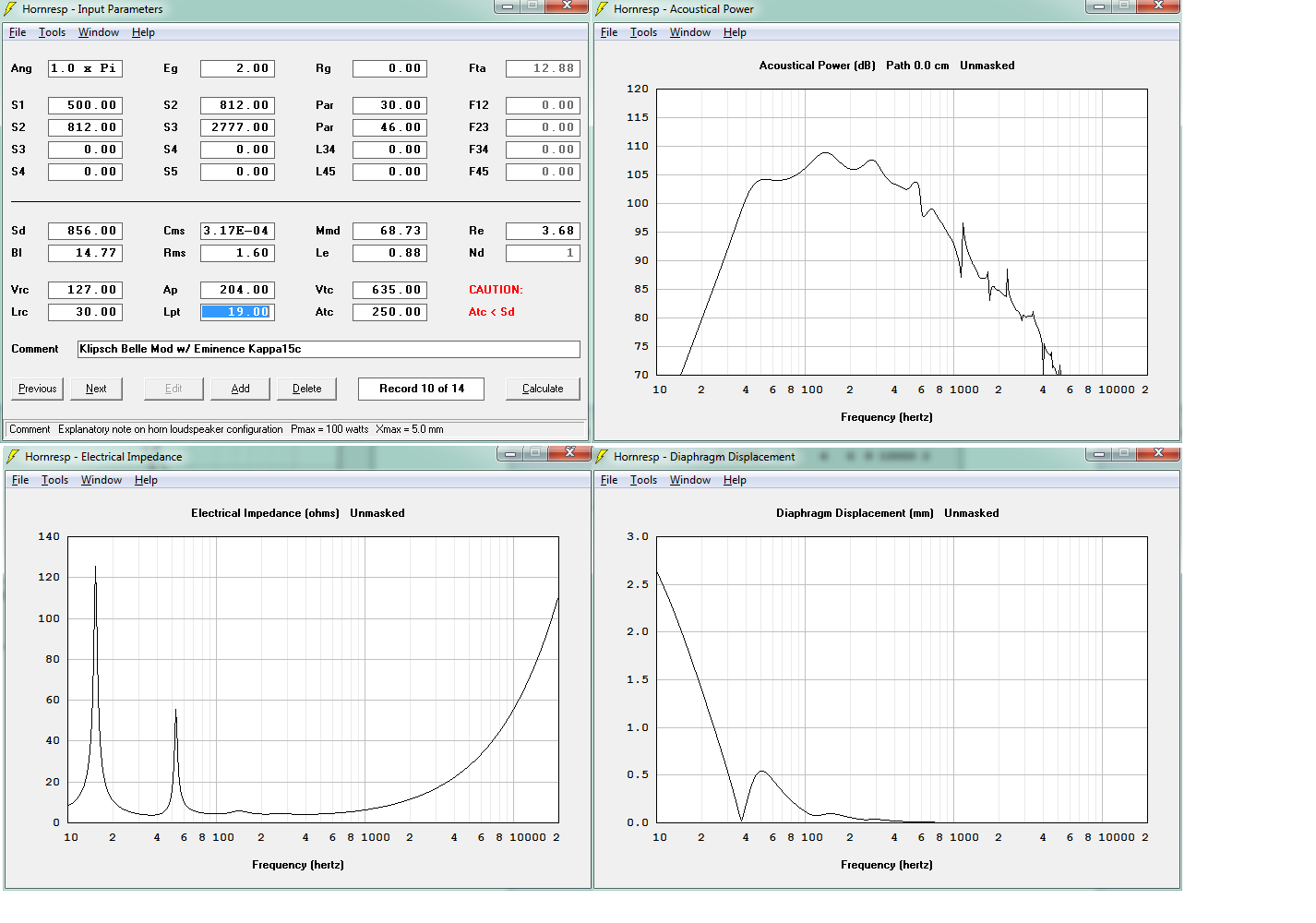

Here's a screenshot of my simulation results . @DJK, I'd appreciate it if you could tell me if I'm on the right path here. From the curves, it looks like there's something to be gained by reducing the back chamber size by another 0.3 to 0.5 cu ft
Tomorrow or Monday, I will try and post my minidsp filters determined "by ear" . Likewise for the response curves.
Referring to the image in the last post , I've tested configurations 4 and 6. Configuration 3 might be the one to beat. Thoughts ??
How does the measured impedance curve compare to the one from the HornResp sim? That IMO is the first place to start. Exporting the data and using Excel or something similar to compare the two curves may be enlightening. I've got a spreadsheet that I use just for that purpose, as I believe comparing the impedance curves is actually the best place to start when comparing a built alignment to its sim.
I don't suggest using WinISD or another simple box modelling tool is a sim tool for your build - it's not going to show the impact of the horn section of the build on the frequency response curve or the impedance curve.
Here we go, .. they pretty much match the WT3 measurements (apart from the absolute value of the impedance peaks) . Looks like some boost in the 40 to 100 Hz is needed (or some cut above 100 Hz)
Actually there's a minor blip at 80 Hz (panel flex?) and a noticeable peak at 150 Hz. The latter suggests that there may be a detail about your build that is missing from the sim. Best to overlay the two curves - that way the differences really jump out and become very noticeable.
The 150 Hz peak might be related to a 1/4 wave resonance between the parallel top and bottom surfaces (about 21 inches)
The other blip is related to sealing. I seem to recall it much much worse before I clamped the front down. I should probably clamp the rear down too. There is a bit more bracing to be done before I'm completely done (interior of the doghouse + I would like to add at least 1/8 to 1/4" to the outside rear of the horn and top chamber cabinets. This is an exercise in overkill

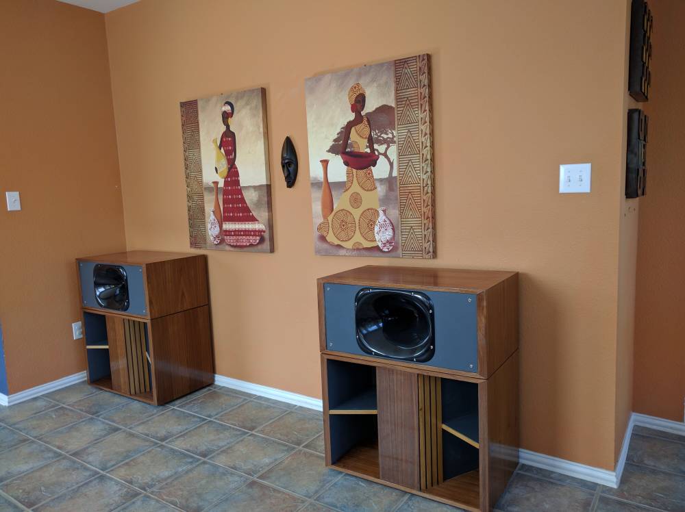

Getting there ... Need to hookup the amps , tune the crossovers and build some fabric grills to cover the butt-ugly waveguide..
With a young infant in the house, I bought a couple of relatively inexpensive"lightweight" amps as I don't want to risk the damage to infant or amp with the 2A3 amp or the boat-anchor mcintosh MC2100

Those speakers look AWESOME!
Thanks - and I'm not done with them cosmetically.
