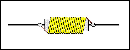

About 10 turns of 14ga. insulated electrical wire wound around a 10 ohm, 5 watt resistor should do the trick. Strip the wire leads and solder to the resistor. See illustration.
Connect one end of this unit to the + amp output and the + speaker wire to the other end.
