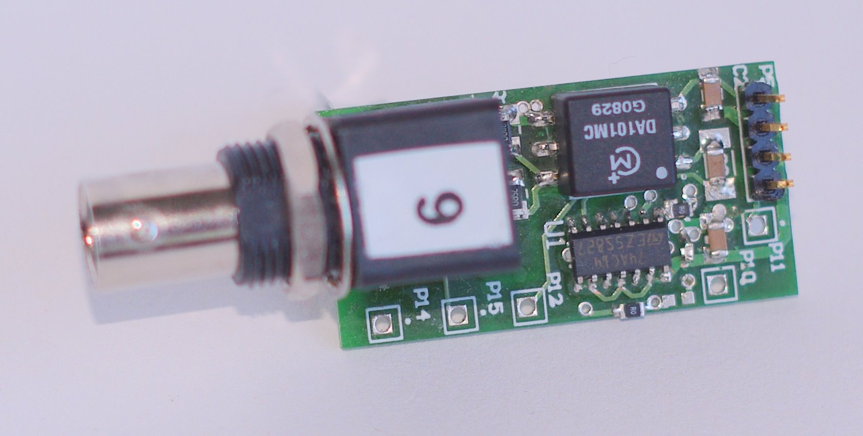

Hello Nicolas
The RCA is a bad solution for digital transfert. So, the BNC 75 is the best solution for SPDIF, cheaper than XRL for same performance. My module SPDIF output have a bandwith higer than 150 Mhz.
The common mode rejection ration is close for XRL and BNC scheme, the RG179 cable is perfect at low cost ; about 5 €?
Rémi
Hello Nicolas
