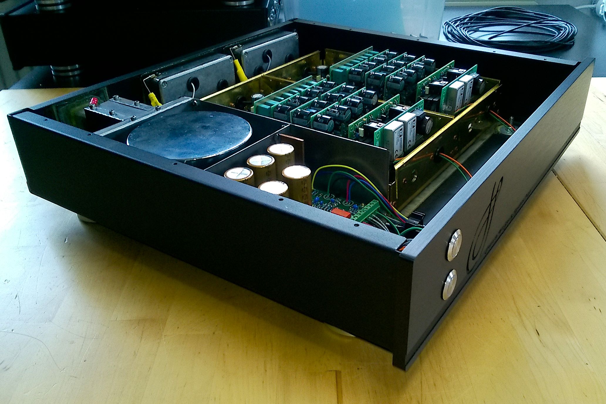

Yes it is still the same schematic.
Q1, Q2, Q3 and Q4 are replaced by ZTX450 and ZTX550 (the BC's where only a place holder).
And no there will not be a board for the diy builder (the current commercial status of the design prohibits that).
There is a small change in the circuit that should result in even less noise. I have also direct soldered a balanced connection now.
Dead bug..
