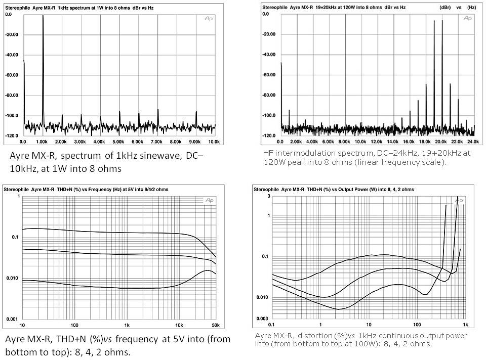

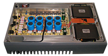

I have a great deal of respect for Charles Hansen's audio design philosophy for Ayre products.
1) Amplifiers with only local feedback sound different than amplifiers with global feedback. Charles believes they sound more musical.
--Especially if JFETS are used for the input stage and voltage gain stage.
2) High output dampening on a non-global-feedback amplifier is desirable.
--Can be achievied with a large number of output transistors.
--Charles prefers using more parallel outputs over the Hawksford type EC.
3) If you are going to use global feedback, it is best to use a lot of feedback.
---Global feedback generates higher harmonics, especially odd harmonics, and high global feedback is required to substantially push their absolute value down.
Charles Hansen from Stereophile interview:
"I have some beliefs that approach religious faith: FETs are better than bipolars, zero feedback is better than feedback, balanced is better than single-ended, and the simpler a circuit, the better. But here's the thing: Just because I believe something doesn't make it true, and designing the MX-R taught me some lessons.
"The first is that, in parts of the circuit, bipolar devices sound better than FETs, so that's what we used. (the Arye MX-R uses 16 ThermaTrak bipolar output transistors). And then there's the EquiLock circuit, which violates my 'simpler is better' dictum. EquiLock is kind of like creating a cascode by combining two triodes. You could say we're joining together two transistors to act like one transistor that has a really stable operating point. Adding a second transistor to the signal path seems like it deviates from my belief that simpler is better, except that it works better."
Key to Ayre's development is what they call EquiLock circuitry for the MX-R monoblock. "In a conventional circuit, the gain transistor has a load, usually either a resistor or a current source," Hansen said. "When the current through the gain transistor changes, then the voltage across the load also changes, which, in turn, means that the voltage across the gain transistor is changing. In fact, all of the parameters (transconductance, capacitance, etc.) vary when the voltage across the transistor varies.
"The EquiLock circuit adds another transistor between the gain transistor and the load. (In our case, the load is actually a current mirror.) This extra transistor holds the voltage of the gain transistor at a fixed level while still transmitting the changes in current to the load (the current mirror). By stabilizing the voltage across the gain transistor, all of the parameters of the gain transistor are also stabilized. The circuit is very similar to a cascode circuit, which has been used by other manufacturers, but EquiLock is an improvement over a conventional cascode circuit."
