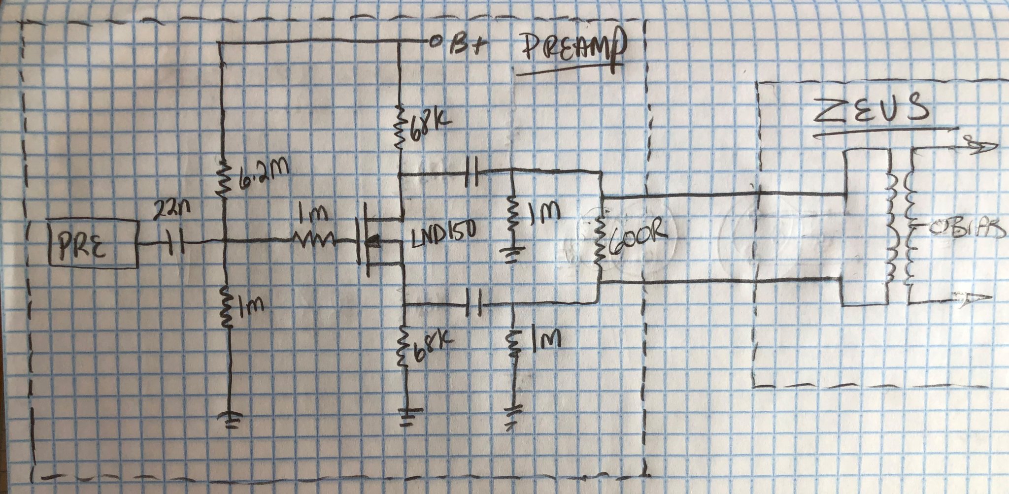

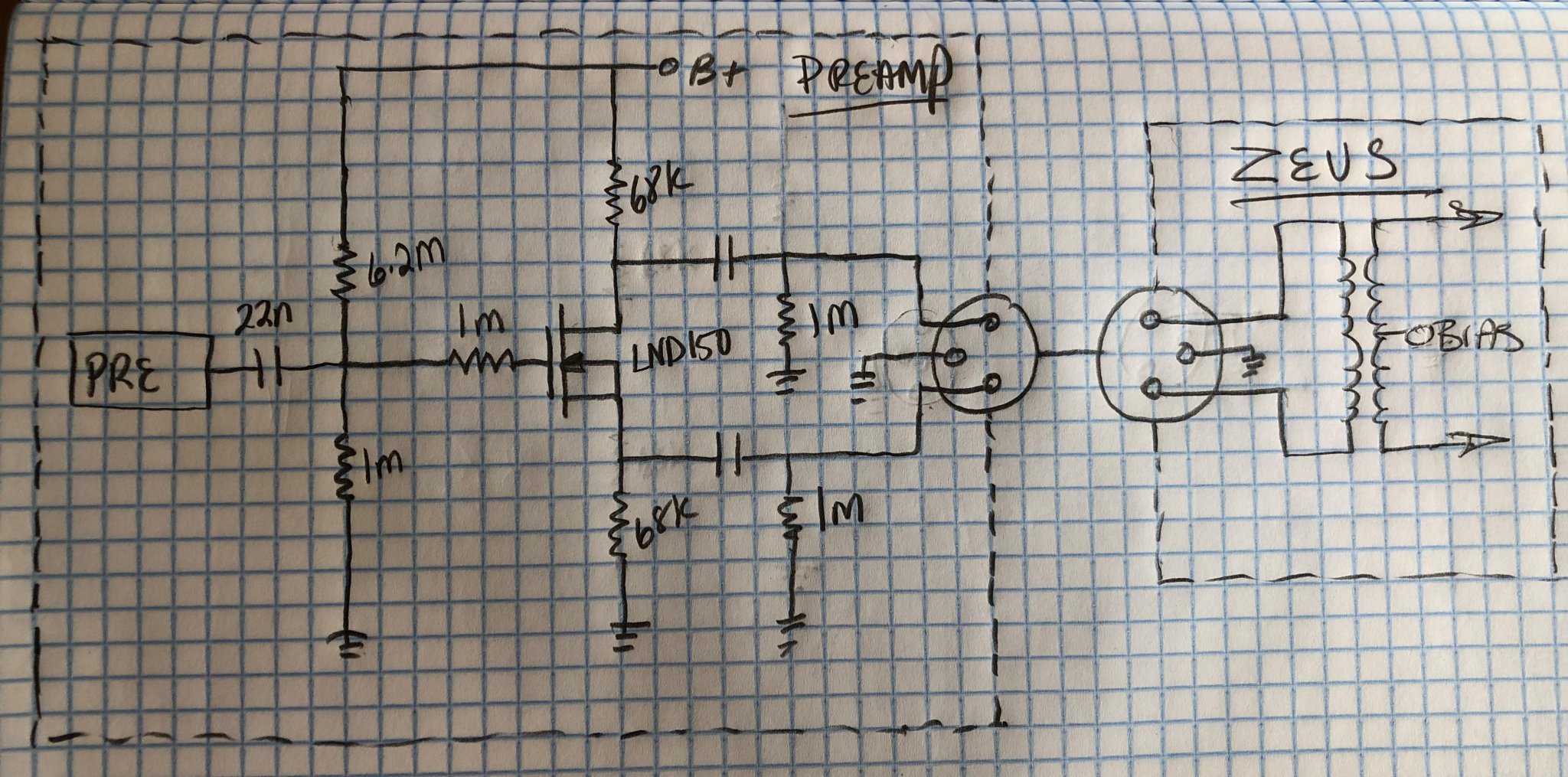

What voltage is needed to drive the PA to full output? Could its input transformer be driven by a tube or SS preamp that has a cathodyne output (triode or LND150) in place of the line amplifier section?

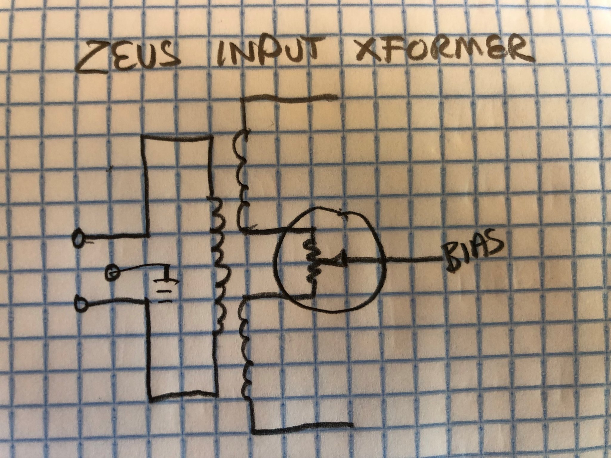

Depends on the configuration, transformer specifications, and supply-voltage.
Yes, one can use a lower output impedance circuit to drive the power stage - a headphone output for example, or a follower. The input transformer as specified isn't designed for biasing though one could of course make something that is.
The line-driver output-transformer and the power-stage input-transformer are designed to operate as a pair - it is in effect a single transformer split into two parts. This minimizes the length of the step-up secondary-windings and the interwinding-capacitance, etc. which would otherwise be much greater if it was all on the same bobbin-core. I can then also optimize the core materials, i.e. M6 for the first and MuMetal for the second, which would be prohibitively more expensive if everything was on a single EI-96 core.
Depending on the output impedance you may need to adjust the power-stage's Rterm value to get the best performance, otherwise if mismatched you will get a roll-off or peak at the high-frequency end of things.
As an aside, our Oppo BD player has 2.1V ac max output, which is 2.95V peak-to-peak referenced to ground on the phono outs, but also has balanced XLR to the same 2.95V peak level which doubles the effective output signal.
This is basically what I was thinking.
I am interested in using this for guitar amplification, so bandwidth and distortion are less of a concern.
I think I read somewhere previously in this thread that the Line Amplifier section had an over gain of 4x? If that's true, then about 10v is needed at the input of the PA's input transformer to drive the PA to full output?

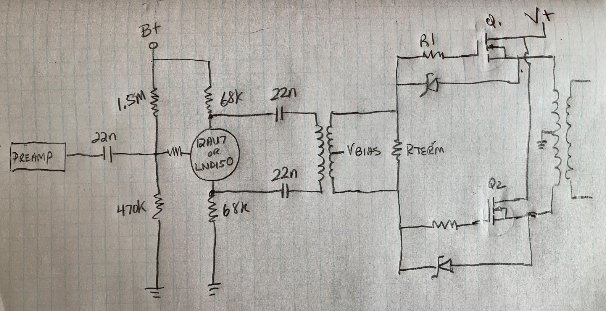

Hi @stephenl5 ... Thanks for the circuit.
You have a phase-splitter driving a centre-taped transformer, which is itself a phase-splitter.
This isn't going to work as you might think, as the reflected impedance the tube sees is 600 ohms (depending on Rterm).
As it's a transformer, you only need one isolating capacitor - the two in series halves the capacitance so doubles the LF cutoff.
TubeCAD circuit SE Phase-Splitter
From here: https://www.tubecad.com/2018/07/blog0433.htm "Extra Super Simple Tube Circuits" about 3/4 the way down the page.
Did you consider having the tube phase-splitter directly driving the MOSFET inputs?
