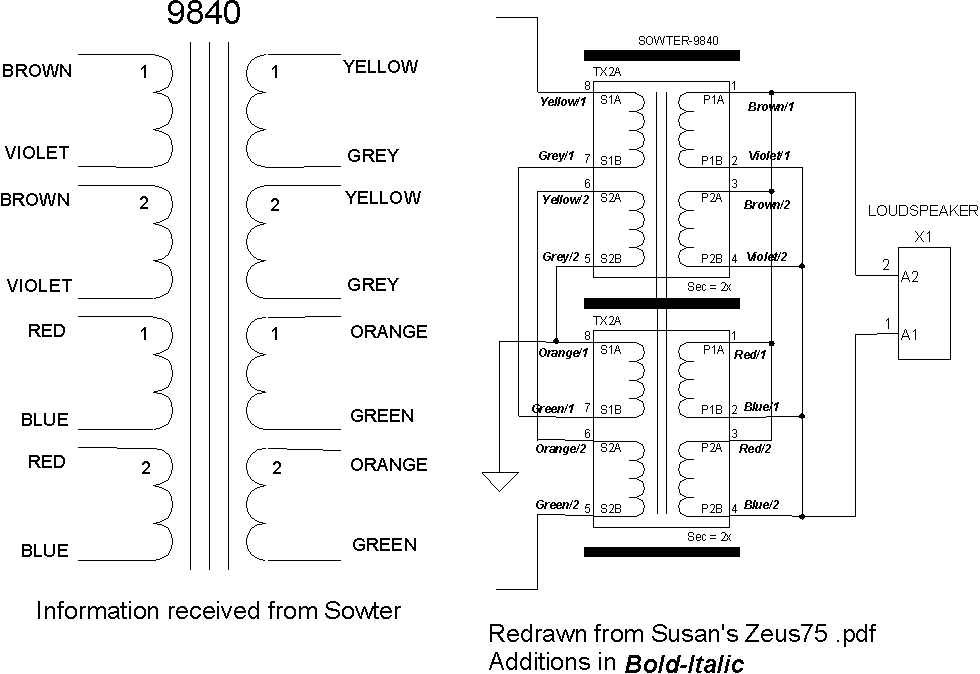

Question on output transformer
Hi Susan,
I'd just like to check the connections for the Sowter 9840 output transformer I'm using. I've redrawn the info supplied by Sowter with the units and an extract from your Zeus75 .pdf
I've marked up the pdf extract with what I think are the correct connections. Could you please check and confirm? Thanks in advance.
Could you also comment on the "Provisional wire colours" diagram you have here:
http://www.susan-parker.co.uk/zeus-out-tx-75w.htm#ei150lamination
Is this supposed to tally with the colour code of the supplied transformers or have I completely misread these three diagrams?
Thanks,
James

Re: Question on output transformer
Hi James,
nemestra said:
Hi Susan,
Thanks,
James
Each of the two primary windings should have one half in each section of the bobbin, with the secondaries either as the primaries but in parallel (rather than center grounded series), or all in parallel.
I am not quite sure as to the info Sowter are supplying as I only had a preliminary test core from them some time ago (nearly 2 years!).
Can you confirm the colours of each of the two groups of windings i.e. which colours come from each of the two bobbin sections.
I do realize that the sectioned bobbin does make the wiring a bit more complex, but it does allow for the 4:1 option as well as other configuration possibilities.
Now that I have more time I will see what I can do to expand on this information on my web pages.
Many thanks.
Best wishes,
Susan.

Hi Susan,
Sowter supply the diagram I provided on the left hand side of the
page I attached. I've now opened one of the 9840s and it is connected as follows:
Bobbin one: 1 pair green, 1 pair yellow, 1 pair orange, 1 pair grey
Bobbin two: 1 pair brown, 1 pair violet, 1 pair blue, 1 pair red
Thanks,
James

Okay, I happen to have the Sowter transformer bobbin in my test rig at the moment - so some assurance it can work.
My primaries are wired:
MOSFET to Grey
Mauve+Yellow
Brown+Grey(1) to GND
Mauve(1)+Yellow(1)
MOSFET to Brown(1)
Secondaries:
Red+Orange = +Ve Out
Blue+Green = -Ve Out
Red(1)+Orange(1) = +Ve Out
Blue(1)+Green(1) = -Ve Out
Note that I have these two pairs on separate sets of binding posts so I can easily change from 2:1 to 4:1 step down.
I usually put a low level sinewave source on one winding and check the others for phase on my scope as I "build" the configuration up with terminal blocks.
Hope this helps?
Best wishes,
Susan.

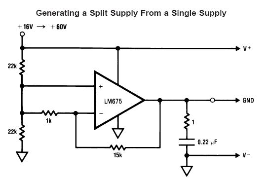

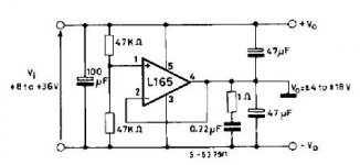

Line driver
I'm experimenting with DRV134 to drive the input transformer. It requires +/- 15V though. Zeus has a single voltage supply that means I have to build a new +/15V rail using Transformer LM7815 LM7915 bla bla. Would it more convenient using LM675 as voltage splitter?

Re: Line driver
Could do it that way, will involve capacitive coupling but you might need to do that anyway depending on your source.
I have tried the SSM2142 which didn't do so well driving the input 1:10 step up transformer. I don't know if the DRV134 will do better although the data sheet does say "IMPROVED REPLACEMENT".
Might be best to try a bench lash up to check before making the effort to build everything nicely.
The DRV134 would be fine with a 2 stage Zeus as the input is then 1:2+2.
Please let me know how it goes.
Best wishes,
Susan.
Sorry if I didn't exlain well the idea.
The intention of using of the LM675 or L165 was just to avoid building another power supply just for the driver stage and not for driving the input transofmer with capacity coupling. I tried driving the input transformer with single amplifier with capacity coupling with disappointing results.
So the LM675 would provide a new +15/-15 volts rail from Zeus main single voltage power supply. The +15/-15 could be suitable for any driving device, AD815, DRV134 etc.
No appolagies necessary. It is I who didn't write clearly.
Yes, splitting the power as you sugest is fine, and of course the transformer primary can sit happily at the c. 15 volts mid level.
You might want to pre-regulate the +volts from the power stage supply to get rid of the main ripple component and also ensure that the supply volts doesn't go over the opamps +- Vmax. Mosfet follower with a zener and pullup should be enough.
Also can use this pre-reg supply for the bias generator. Then you arn't limited to 40 volts max.
The input to the line driver (AD815, DRV134...) would be cap coupled, but we often have to make that compromise to get rid of DC ofset anyway.
Best wishes,
