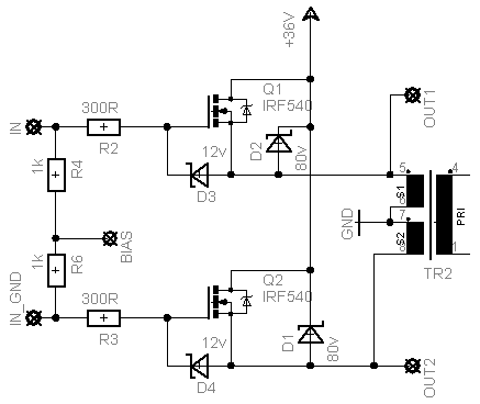

Hi bobo1on1,
Hum, not sure why this would happen.
How are you driving the inputs (your schematic shows one input as IN-GND although I assume this is not actually the case)?
What is the lowest frequency you are driving at full power?
What is the real power supply voltage?
Looking at the irf540 data sheet you should be good for more than 30 amps per device but perhaps this is being exceeded?
0.35 ohms and 30 volts is 86 amps at DC.
I would have thought the fuse after the storage capacitors would have shriveled long before this.

Hi Susan and bobo1on1,
Ur Mosfets are damaging because their gate to Source voltage is
exceeds the VGS limit.
Ur implementation of zeners is totally wrong. instead u must use 11V back to back Zeners and their is no need of 80V zeners. Simply lower the rail voltage or use IRF640N 200V mosfet .
The Transformer is creating a sort of TRICKLE FLYBACK although Body diodes are present but they also avalanche due to this effect and the mosfets are damaged.
Hope this Helps
Schematic Update
Update schematic showing zener protection as per IR recommendations.
I have mentioned this in previous posts but I should have updated this schematic. The previous version was as drawn in 1994.
I apologize for this as I have come to realize that once the posts move on to the next page it become quickly quite difficult to remember where things are.
I spent a while yesterday trying to find the post with the Sowter input transformer price info as I couldn't find the email - then realized that I had had this from my phone conversation - oops!
The image (once one has refreshed the browser cache) should now appear correctly in the
http://www.susan-parker.co.uk/zeus.htm
and other pages as well.
However I have run configurations like the previous schematic with the zener across the mosfet directly and whilst I have managed to get the mosfet to take off there are only little squibs of RF on part of the cycle and the mosfets themselves haven't minded.
Of course with the output transformer capable of radiating up into the many megahertz region this is not a good idea from the EMC/RFI point of view.
Because the mosfet is a follower it has a voltage gain just under unity - so parasitic oscillation doesn't amplify unlike mosfets used as voltage gain.
However I am sure that there are still lots of possibilities to let the magic smoke out. Partly why I have been big on cheepie mosfets like the IRFP140s which whilst not quite throw away items like fuses don't cause massive financial grief unlike nice lateral or RF mosfets

Well they seem to blow up when I disconnect the speaker while it's playing at some serious power, I know I shouldn't do this, but it can happen sometime.
I think it creates a big spike on the transformer just high enough to blow up the mosfet, I am using some 800 volt mosfets right now and there is no problem at all.
So I will put in the zeners, maybe it won't do any good, but the cost is next to nothing.
Oh and I forgot to put in the fuse, again!

Ehm what are back to back zeners? I did put in a 12 volt zener between the gate and the source, that should make sure the Vgs does not exceed 12 volts, or am I wrong?
bobo1on1 said:Well they seem to blow up when I disconnect the speaker while it's playing at some serious power, I know I shouldn't do this, but it can happen sometime.
Yes it does. One of the perils of development.

Hum, you should be driving a diferential signal into the mosfets - see darkmoebius's very helpful post:
http://www.diyaudio.com/forums/showthread.php?postid=508517#post508517
However an input transformer drive will allow you to drive the gates over the nominal supply rail which could give you a few more watts.
You might like to try varistors across them.
Hi mikelm,
The zeners are now connected to the other side of the gate resistor. A subtle but recomended practise by International Rectifier.

mikelm said:Hi Susan,
am I missing something ?
your posted 'new schematic' looks identical to the one that I downloaded about a week ago

A big inductanse will keep on raising the voltage until the energy from the collapsing magnetic field is wasted somehow. Usually you have a spark through the isolation of the windings. I got a jolt from a big transformer that was several thousands of volts once....Well they seem to blow up when I disconnect the speaker while it's playing at some serious power, I know I shouldn't do this, but it can happen sometime.
I got rid of the problem with fets blowing up when i connected 18 volts 1,3 watts zeners back to back between gate and source..
