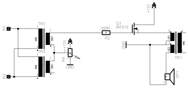

Susan: I connected two more audio transformers, the primary windings in parallel and the secondary windings in series to double the voltage, the amp still distorts at low frequencies but at a slightly higher volume level.
I found out that the distortion sort of shifts up to a higher level when I increase the bias voltage, so there is a good chance the audio transformers are getting saturated.

I am going to rewind the output transformer, but someone thought it was a good idea to weld the laminations together so I can't get them apart.
Pity. For bifilar windings you could thread the wire - similar to winding a torroid. A pain but for 150 turns doable with patience.
Do you think think two of these audio transformers wil do the job? the specs are: 15Kohm-60Kohm,200c-1kc size:23-36 mm,audio level:+10dbM.
Does anyone know what kind of value c is?
I've also included a picture.
You should be able to get about seven volts peak to peak for 10 dBm at 600 ohms.
So two will give you 14 volts across the transformer, about eight to ten watts (max) into eight ohms.

I just managed to open the transformer, I used a saw to cut trough the welds and used a screwdriver to crack it open, now I can start rewinding it.
When winding 150 turns bifilar do you mean 75 turns for each wire and the two wires fitted exactly parallel?

Hi bobo1on1,
Victory!
150 turns each wire, both wires wound simultaneously and sitting next to each other.
This produces an interleave effect.
1:2;1:2,1:2;1:2,1:2;1:2 ..... 1:2
and then when you get to the end you wind back across and because the wire is then spiraling the other way you get cross linking of the 1 and 2 wires between the layers as well.
1:2;1:2;1:2;1:2;1:2;1:2 ..... 1:2-
-1:2;1:2;1:2;1:2;1:2;1:2 ..... 1:2
etc.
Key:
1 and 2 = wire
: = wire pair wound together
; = pairs of wires
- = small offset for part of turn at end.
..... = further pairs of wires to fill layer
You should have approximately 150 turns - but a few more or less won't matter greatly.
I buy the enameled wire in sets of four bobbins - although you will only need two for this version - so I don't have to mess around with re-spooling.
When winding the bobbin the above should become clear.
Which is why I use a 5 volt regulator and recommend a multi-turn pot, the adjustment for the bias is quite sensitive.
I have found that I need to set the bias somewhere around the three and a half volts point, but this can vary quite considerably (by several hundred millivolts) depending on mosfet type and manufacturer.
And a fast 6 amp fuse AFTER the power supply smoothing cap. Fuses are cheaper than mosfets.
... you can no doubt imagine how I worked that one out! Bang!
(I also have a 0.1 ohm power resistor in the supply line to measure the current (if you look at the picture of my amp on the web page you can just see it (gold smudge) snuggling under the terminals of the smoothing capacitor). There is also a 47K wire wound across the cap to discharge it once the power is turned off.)

do you mean:
A and B = wires
: = side by side wound wire
| = indicator for division between adjacent pairs (no space)
- = small offset for turn at end
... = winding to fill end of turn
where:
A:B|A:B|A:B|.... etc??
Perhaps the "1" and "2" designation is part of the ciphering issue when reading it?
_-_-bear
do you mean:
A and B = wires
where:
_-_-bear
I used multifilar winding over 20 years ago to reduce the leakage inductance of a transformer for a 50W flyback switching power supply, and it worked pretty well. In my case, I twisted several parallel strands together, used the resulting cable to wind a transformer on a powdered iron toroid, picked the strands apart, and did series and parallel combinations to get the actual turns ratios that I needed. This is an absolute no-no for any mains isolation transformer, as the safety agencies consider magnet wire to be almost equivalent to bare wire as far as safety is concerned. However, for low voltage applications that aren't shipped to the public at large, the technique works pretty well. Double coated magnet wire will actuallly stand off 500-750VDC with no problem if not damaged. A sojurn in a tank of varnish (polyurethane varnish works ok if transformer varnish is unavailable) helps to seal up any little pinholes and inadvertant scratches, helps keep the windings from making noise, and also keeps out moisture. The transformer I wound using these techniques had << 1% leakage, low enough to allow using a modest RCD primary snubber with a 2W bleed resistor for a 50W flyback converter with 10V input. This was no mean feat, especially by early 80's standards. The losses from the powderd iron toroid (even the so-called low loss mix) were not up to the job, but that was another matter altogether....
The technique that Susan mentions of simultaneous winding using several spools of wire is another method for applying multifilar windings. If you don't want to calculate out the wire length sinvolved and hank several long, long strands together, it is the only way you can make sure of winding the transformer in one piece without any splices. If one is a real neatnik, it is possible to apply the strands side by side and wind the transformer bobbin neatly. This actually may not give quite as optimal leakage results as a sort of scramble wound technique, but will give you the best fill factor and a relatively short mean length per turn, which will reduce copper losses.
Any technique that gets the primary and secondary windings intimately intermixed will give you lower leakage than having them on seperate layers, though multiple interleaving actually works fairly well from a leakage standpoint. The MIT Radiation Lab Reference on pulse generators( authors Glasoe and Lebacqz) goes into a long discussion of optimum primary and secondary interleaving techniques for reducing both leakage inductance and stray capacitance for radar-type pulse transformers. This of course is of paramount importance for a transformer that must deliver a flat-topped high voltage pulse with little or no ringing, but canalso be applied to audio.
I don't recall any publication that talks about multifilar winding techniques except for winding the two primary halves of a push-pull transformer as a bifilar winding. Again, it is an absolute no-no for applications involvoing high voltage or safety isolation, but an obvious thing to do for low voltage applications. The reasonably low ringing shown by Susan's transformer shows that the stray capacitance introduced by this technique need not be a big concern. I plan to use multifilar windings on a large strip steel toroid when I construct my version of this amplifier. I will hank several strands together and wind as neatly as possible, not paying too much attention to which strands become primary or secondary. I expect excellent results. It should be possible to get around 0.1% leakage with such an arrangement. ~1% leakage is considered excellent for most applications.
Hi Bear,
Yes, this is correct.
I quad filar wind my transformers as I use secondary windings, but bobo1on1 is using primaries only and putting the speaker across these (in push-pull it works better with a higher impedance speaker BTW - 12 to 16 ohms, as distortion begins to rise below 8 ohms). (The single ended version has the speaker on the second winding which is now a secondary.)
So for my quad filar windings I get
A:B:C|A:B:C|A:B:C|.... etc
I keep the order across the layer but allow this to change, if it happens to be neater for the windings, to come back across.
As the wires are quite large it is important to keep the layers flat, otherwise one compromises the fill.
One can also varnish as one goes, which is effective if a bit sticky.
Best wishes,
Susan.
P.S. I am replying separately to Ed Richardson to sort out lamination styles as I understand he has received several inquiries
