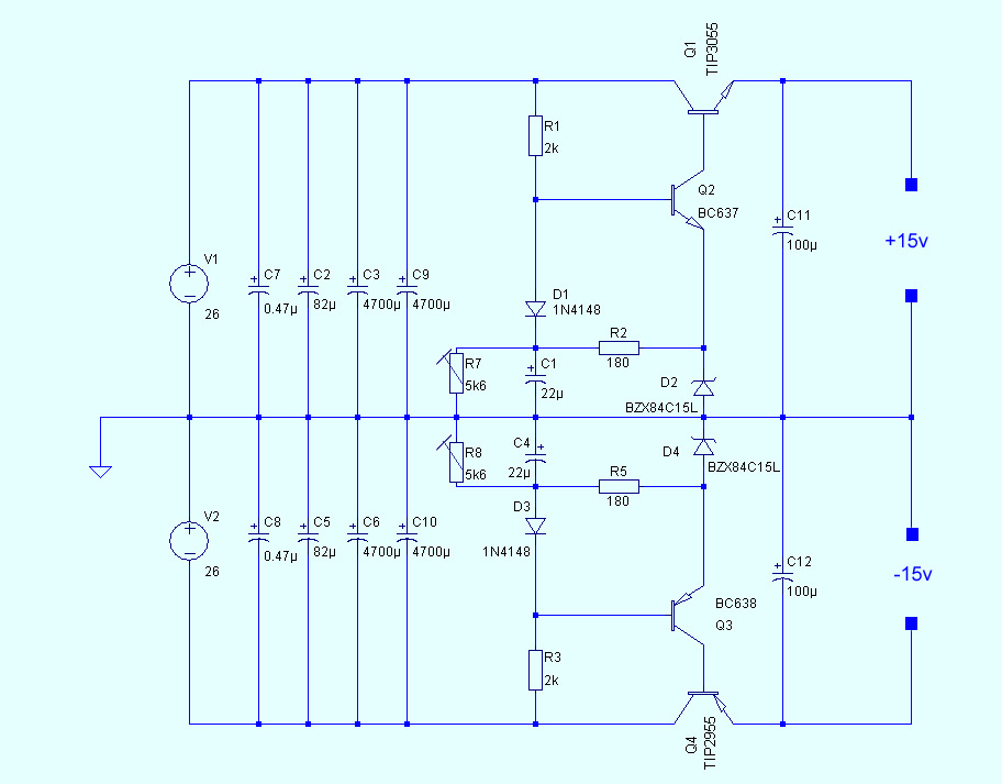

I just started a new discrete transisitor Pre-amplifier inspired by a Mark levinson
Great until i finished regulating for 15volt rails
Got the thing slung together and I have been chasing my tail on noise ever since
only to now find it's coming from Zeners............. ooooh yes what fun
Typically my regulator circuits follow the pic -- (see pic)
Interesting is the spectral density of the noise
If i get my soldering iron close to them the density and type of noise changes - suggesting thermal fluctuations linked to electron avalanche effect as per Boltzmans constant
The problem is I have swapped Zener after Zener after Zener with no improvment
Has anyone else had a tearing of hair moment with Zeners
i love noise -- dont you ? ....ooooooooooh joy :rolleyes:

That design must have super poor PSRR if that regulator ain't low enough noise... Anyway, the zener should be running at > 1 mA for reasonably low noise--at low currents multi-state noise (random changes between two potentials, similar to popcorn noise) appears and also the white noise content increases. Too lazy to calculate the zener current, but intuition suggests that it might be pretty low at low output currents. I'd go for a topology where zener current is well defined and independent of output current.
Further enhancements include the use of lower voltage diodes (3x 5.1 V will give *much* lower noise) and increased filtering.
Samuel
All zeners are noisy, it is just that some are noisier than others. That is why they are used as noise sources. If you want low noise then bypass with a fat capacitor.
I don't understand your circuit. It seems to rely on the output transistors having large c-b leakage. Are there components missing or in the wrong place? Why have you inserted a noisy 'regulator' between big capacitors?
Zeners, noisy? Hmmmm Yep, they are. This is why I don't use Zeners as voltage references in regulators where noise is an issue. I prefer to use a lower conductance low noise J-fet at Idss and cascode with another of higher Vgs at Idss of the lower conductance one. Then the constant current through a constant resistor, metal film of course, gives a constant voltage. Place a few nf cap across the resistor to diminish Johnson noise. Now you have a much better voltage reference.;)

I think you have a basic issue with this circuit. You need a resistor to feed current into the base of the pass transistor. Next you can use a regulation transistor to siphon off excess base current to make it regulate to the set output. I wonder if this works at all, unless you have a very leaky pass transistor? The zener noise is about 6 steps down on the issue list ;-)

That isnt "my" circuit anyhow -- it's one from I nicked from JLH also used by Armstrong Audio back in the 1970's - and for the purposes of illustration doesnt show all of it --- it's indicative only typical of zener placement
The VRs are to null out differences in the two rails to provide proper symmetry beyond the tolerances of the other devices.
I think the R2 - R5 are a compensation at start-up when the rails are imbalanced -- I think it's trying to balance the rail rise time when the unit is first switched on.
Zener current at the moment is 3.2mA which I would have thought would have sufficed.

What is the point of showing an incomplete circuit which can't possibly work? We know what zeners do, and how they are used.
"I know my circuit does not work, but I don't know why. Please help me. To stop you doing that, here is another circuit which will send you off down the wrong track. Have a nice day."

People were trying to point out that your circuit, where you measured the excess noise, is disfunctional. The noise your measuring wasn't the zener noise. So you kind of put all of us on the wrong foot by claiming excess zener noise from a defunct circuit that wasn't zener noise at all.
