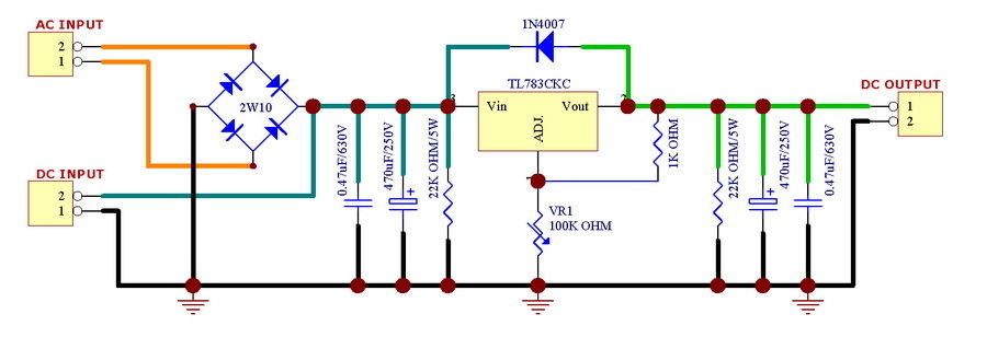

Is there any reason not to use a zener for a regulated bias supply? Do zeners tend to be noisy? My other choice is a small regulated supply I found on "that" bidding site that will output up to 120V. I attached the schematic.

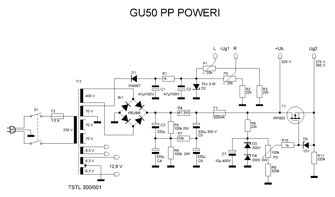

I have used zener regulation with many of my constructions and never found noise problems that are mentioned above.
Also the temperature drift is not a problem.
Many tube amplifier power suplies are not regulated and the performance is still acceptable. How could it be worse if regulated with zeners?
Below one example that I have used with GU50 PP-amplier. Adjustable bias- and screen voltages are regulated with zeners.

Not "as well", but to VR tubes only. Zeners don't ignite, so don't oscillate. They can be shunted by any capacitance.
I use similar regulators, except Zener string and 2 MOSFET outputs, +400 for preamp tubes, and +270 for screen grids. Also I regulate filament DC for preamp tubes.

To your 1st posting: Keep in mind that the 783 is a positive regulator. So the whole circuitry needs to float, with only it's positive output tied to ground. And what's that DC Input for?
Best regards!
