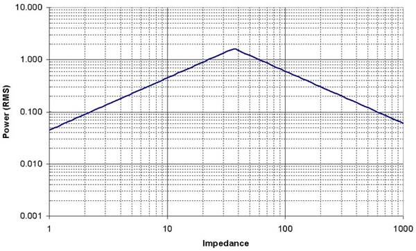

If my calcs & measurements are correct, I am getting ~1.44W(RMS) into my 32ohm headphones, due to the output current limit. That works out to just a hair over 138dB max volume (headphone output is rated at 98dB at 1mV).
I designed for max power output roughly at 32 ohms to coincide with my headphone impedance, and max power is ~1.6W(RMS) into 38ohms. If my thinking is right, this is a graph of output power vs. headphone impedance.
metalman said:If my calcs & measurements are correct, I am getting ~1.44W(RMS) into my 32ohm headphones, due to the output current limit. That works out to just a hair over 138dB max volume (headphone output is rated at 98dB at 1mV).
My hat's off to you. I just ran some hand calcs to verify what you were saying. That is a very interesting way to approach a class-A amplifier design. Actually it's a lot like how a friend (more like a mentor) of mine went about designing his headphone amp as well. In this way, you are maximizing your power efficiency into your headphones, minimizing the bad effects of a class-A. Your numbers sound dead on.
