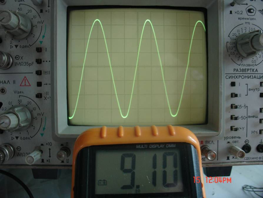

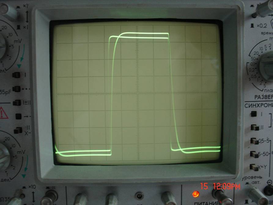

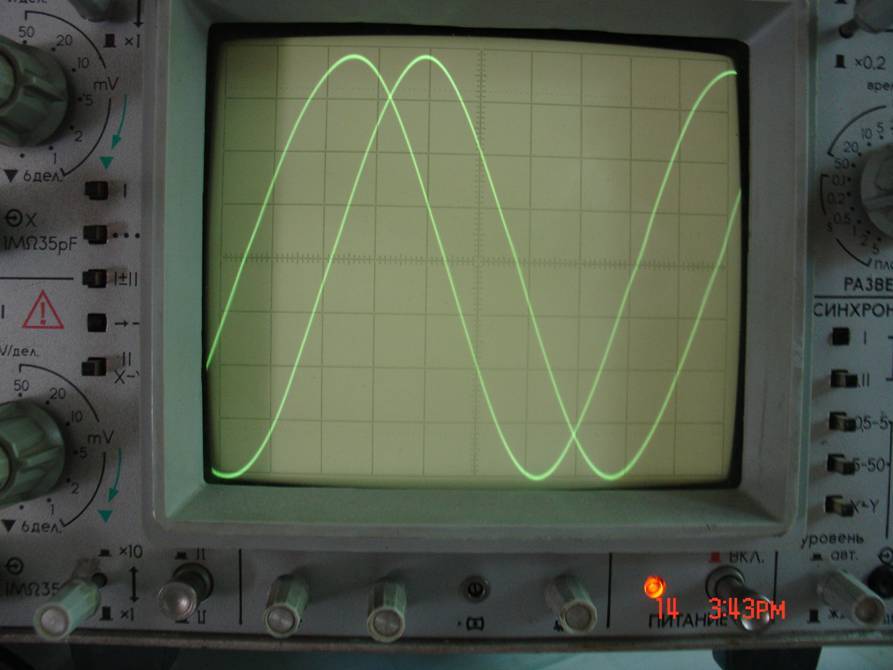

This is a schematics with standard parts. It is not extremely fast, but looks quite interesting as a 10W SE amp with good damping factor (more than 100 at 8 Ohms). Zout =0,075 Ohms, Gain is 23dB. Pictures show:
1) Measurement of Pmax at undistorted 1 KHz and 7,2 Ohms resistive load
2) Square wave response at 100 KHz and 7,2 Ohms load 8V p-t-p
3) Phase shift (nearly 0,16usec) at 1 MHz (input and output signals)

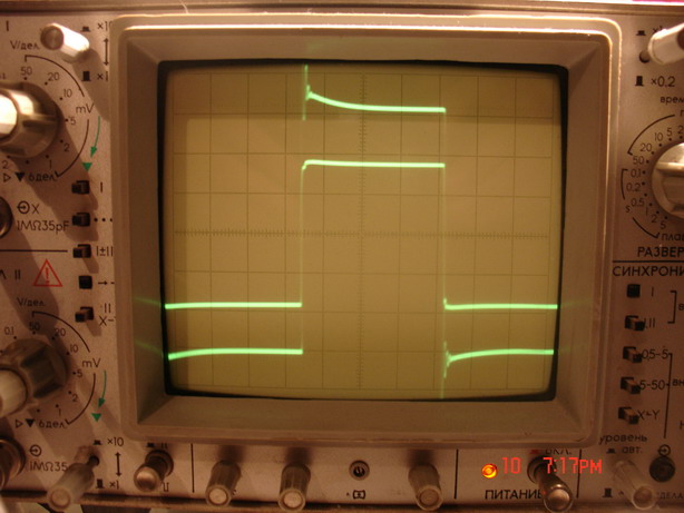

I have done tests of this basic schematics with IGBT output transistors BUP314. Since IGBT have quite a large gate-to-emitter voltage (7…8 V), in this topology it is just enough for comfortable operation of VT1 without source follower. So, IRF610 is not needed, but idle current through VT1, VT2 must be few tens of mA, because of 1500pF gate capacitance of BUP314. This makes important using of high-current j-fets as CP650 here. In the schematics enclosed I used nearly 100 mA through VT1, VT2.
The scope shots show the sine and square signals at 100kHz 7,2Ohms 6V p-t-p, and also sine at 500kHz (for the phase shift estimate). The phase shift is 0,09 usec.
