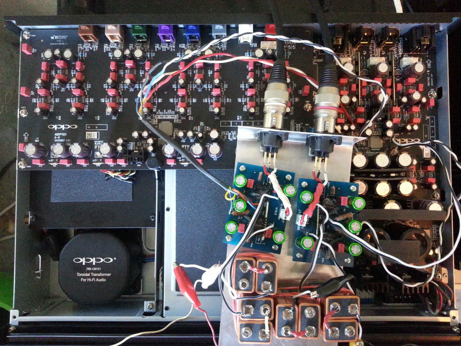

Late to the game but got the SEN working in the Oppo 105D on a trial basis.
Sounds impressive... now for the recharging circuit.

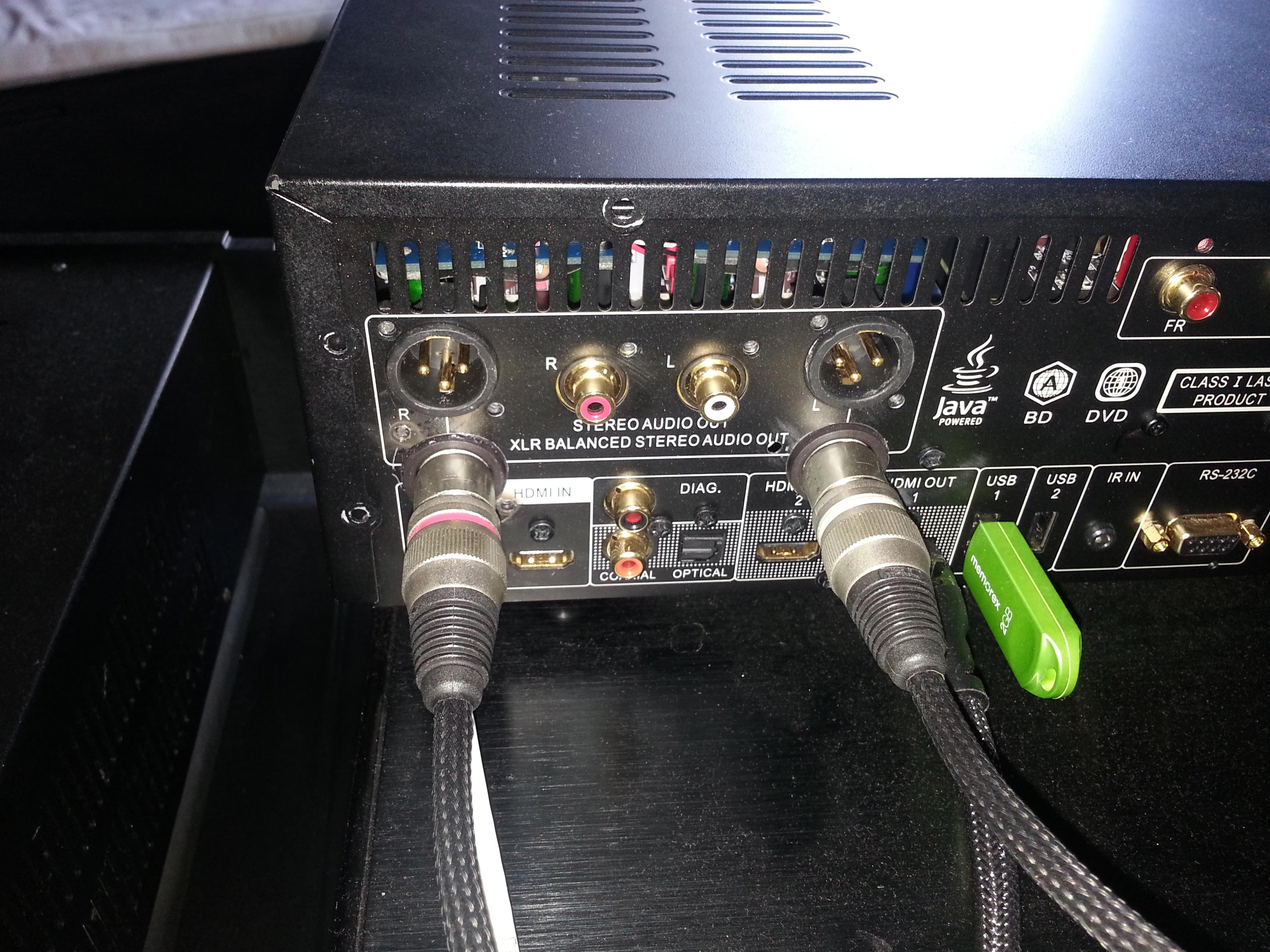

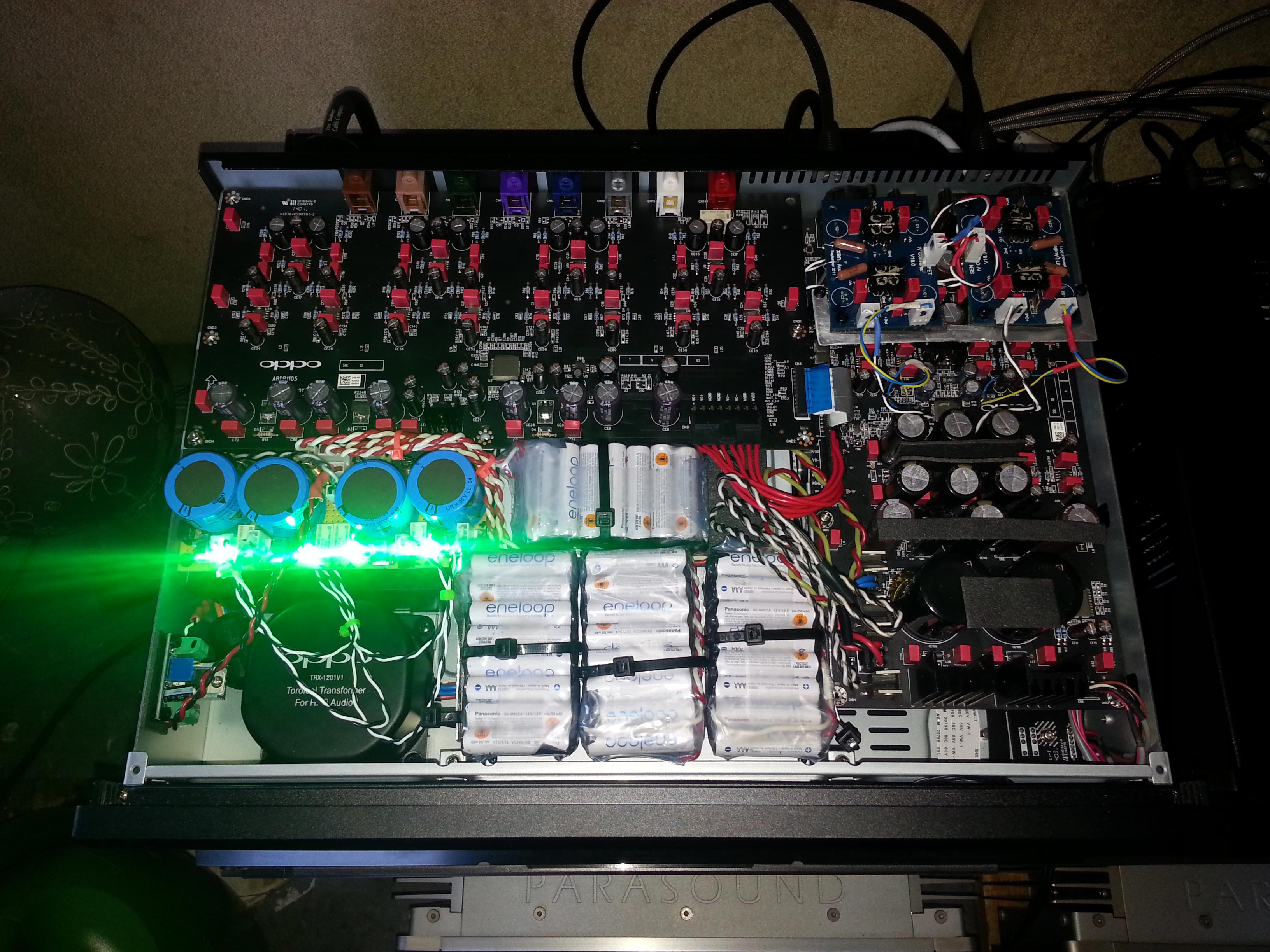

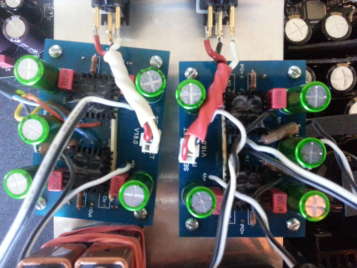

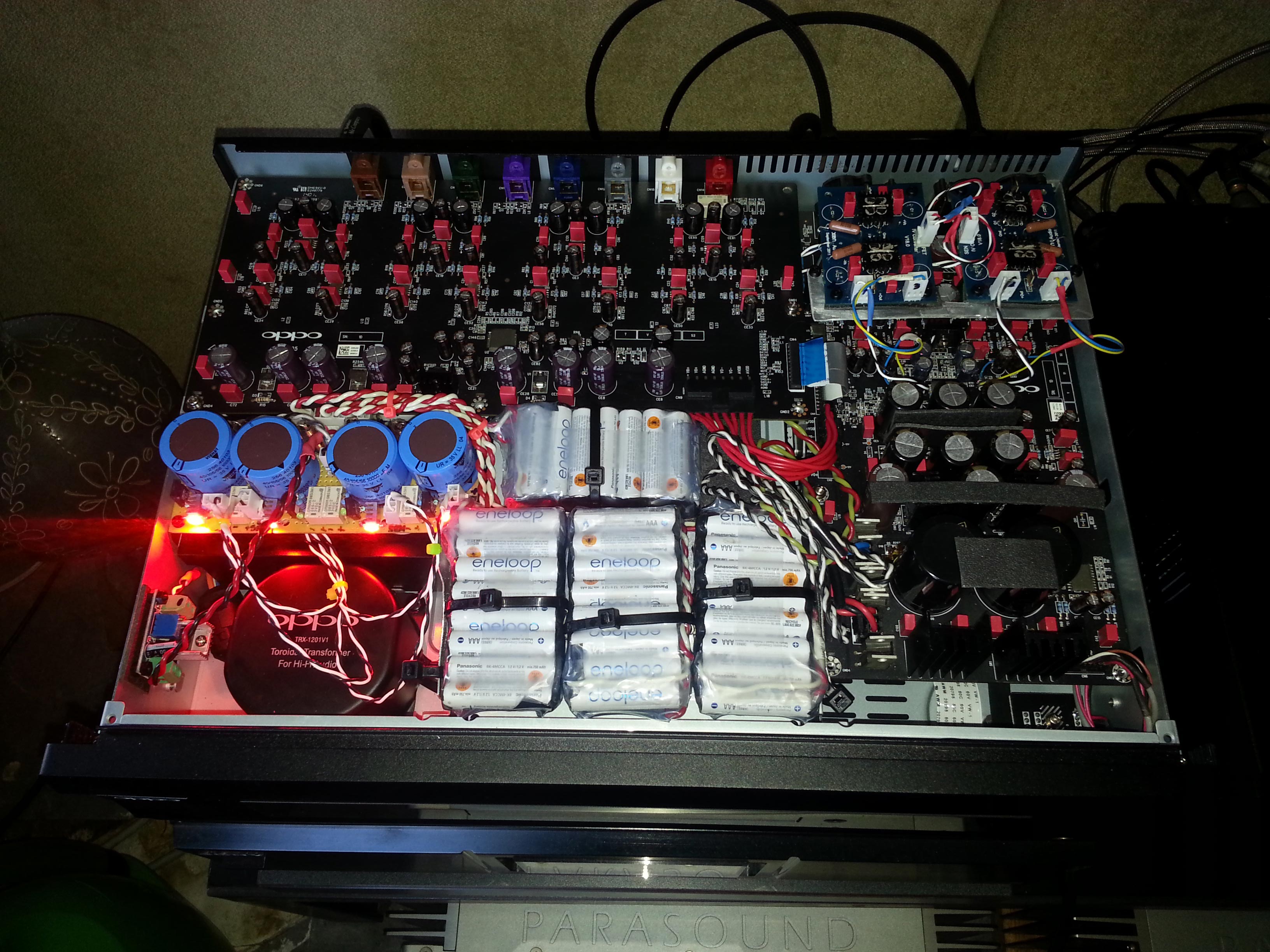

Oppo 105 with Sen Fully operational
So finally got the Oppo setup with the Sen I/V fully operational
So far it sounds awesome.
Installed a new set of balances outputs so the original is still in place and operational.
LEDs fully operational - thanks NicMac
LC filter circuit implemented - thanks for all the help Patrick
Getting used to it... may upgrade the other resistors on the SEN
