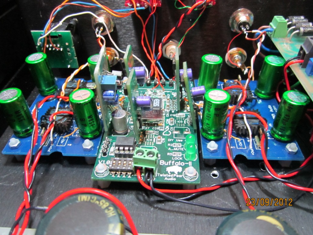

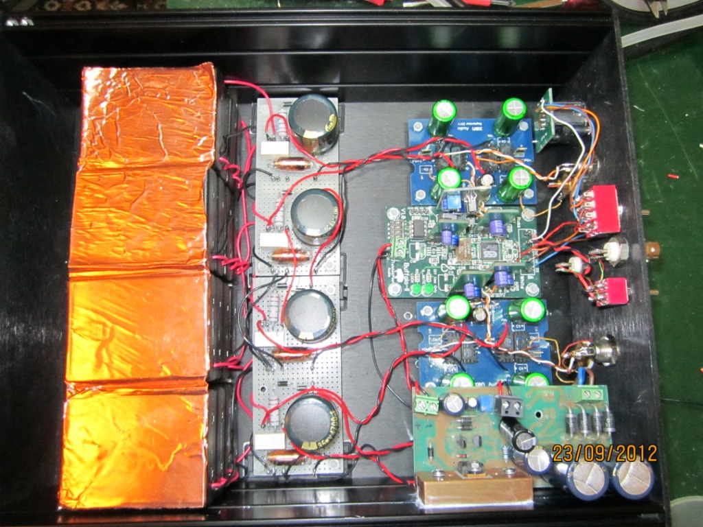

Hi
I've changed my layout and put my SEN boards to either side of the Buffalo board, in the same plane, close to the grounded chassis bottom, as discussed above. No buzz; I've played with the wiring To try and re-induce it- with no success. May just be chance that I've chosen a stable layout, and that the side to side arrangement is no panacea- but I tentatively conclude it's preferable to the stacked arrangement- and, as Patrick has explained, there are good theoretical reasons to support this. Whatever- I'm a happy listener again!
Well, nearly- I need to shorten the SPDIF input wiring paths (the switches were arranged to suit the raised board) and to sort out my RJ45 DSD input, which no longer works (probably as I modified the socket rather brutally to gain some space).
Does anyone know a source of solderable RJ45 chassis sockets- not IDC types which accept wires directly?
Paul N

Hi Patrick
Yes. Though I can't that all side by side implementations would be problem free, mine is at the moment. Personally given the problems I've had with stacked arrangement, and the (now) obvious (theoretical) greater susceptibility of that layout to rf problems, I'll be sticking with the side by side arrangement in future.
Paul
you meant you prefer a side-by-side arrangement and not DAC above SEN ??
After all, you cannot make it to buzz with side-by-side, right ?
Paul
OMG, thst must be a part of project on Electronic warfare ? How many watts does it emits?An externally hosted image should be here but it was not working when we last tested it.
No wonder opamps work bad in these conditions.
Nothing compared to a Class A power amp.
Its just a pair of Buffalo, Arduino and eighten regulators four of which are hungry shunts as most Buffalo builds have the remainder are linier so harly any more power than a standard build, looks messy because most regulators are hard against the Buffalos with short wiring.
Well, maybe I used wrong term. Mayby "radiates" suites here better. But, anyway, with such layout your dac will radiate and recieve tons of RF garbage. DAC contains very high speed clock signals, with rise times orders if 5 nsec, it tends to spred upon any wire it "sees" around. Things are especially scary because you are using sabre, which has very righ output current - around 10 mA. Output current contains EM spectrum up to GHz range. Any power amp will not be happy to see it on its input .
Another problem is separate i/u and dac boards, one of the worst things you can do to delta-sigma converter because abovementioned HF modulation. The worther might be only using one output in a couple. By design, delta-sigma dac might be considered high-speed digital chip, with lots of digital logic: digital filer, ASRC in case of Sabre, DS modulator. All this logic emits RF noise, but it is common to I+ and I-. To remove it, stage for a substraction should be used.
Personally I ended few times with layout like that. Every time I tried to compare them with my Dell laptom build in sound, and it was better, especyally after some filtering. Of course, I can not extrapolate anything anywhere
